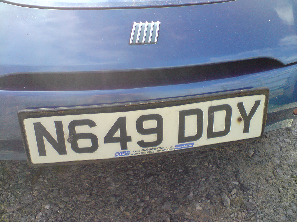

This is not going to be as interesting as some threads but I will post pics of all work done to my B when possible.
I start with an easy (even I can do it) project. Repainting the numberplate holder.
1. Before: plate has corrosion and little flaked paint.

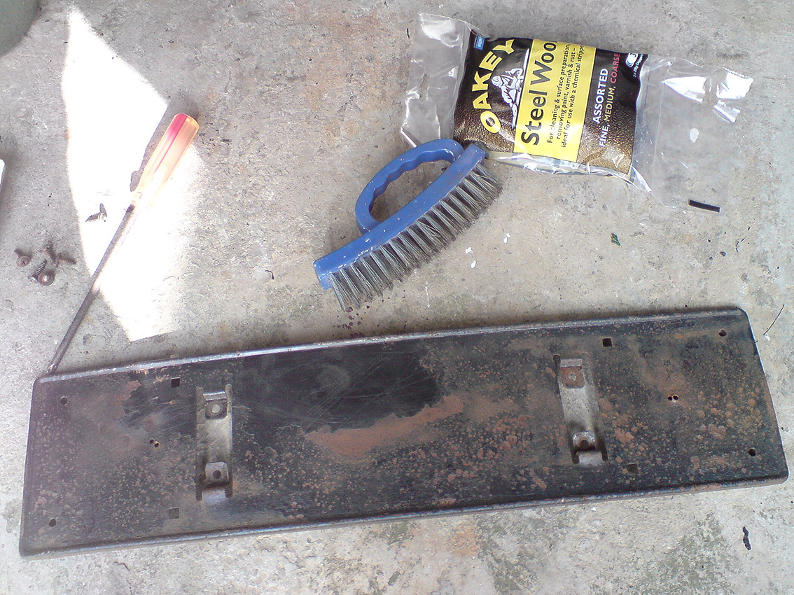

2. Unscrew holder. Clean up with wire brush and steel wool. Wash off dirt/dust.

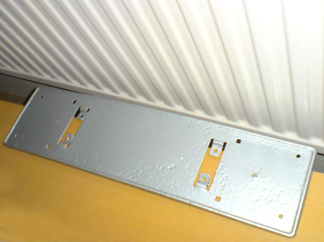

3. Spray on coats of Hammerite and leave to harden over night.

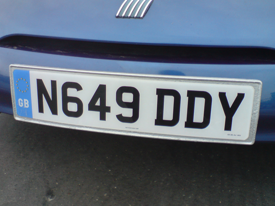

4. After: nice finish with new plate attached.
Told you it was a small project but every bit helps.
