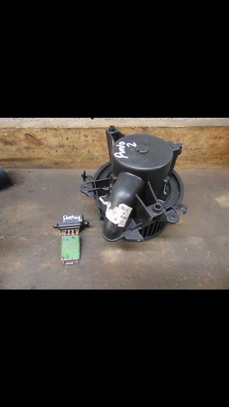

Check the wiring going to the interior fan. The fan is under the glove box in the passenger side. Look up from foot well,you will see the plastic housing,round dish shape,near there will be the resistor wiring socket,4/5 wires on one plug.Grab the wires and move them with the fan turned on,this is usually the fault.If it only works on full speed then it's the resistor its self at fault. The plug could be burnt,tighten the connections or get a loom of Ebay and replace. IMG_7412.JPGIMG_7411.JPG

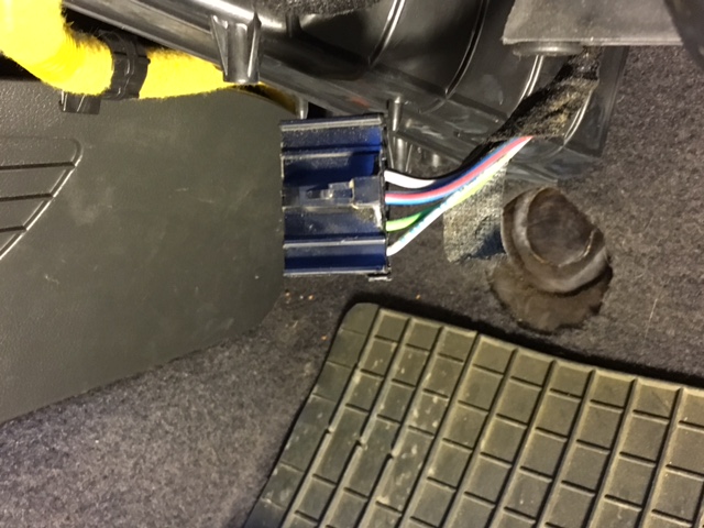

Thanks for your posts in this topic guys - our mk2 188 has developed problems with the blower motor - it doesn't work on settings 1, 2 or 3 but 4 works like a tornado. I'm assuming it's going to be the connector block based on the above, but I'll check the fuse F8 in engine fuse box too.

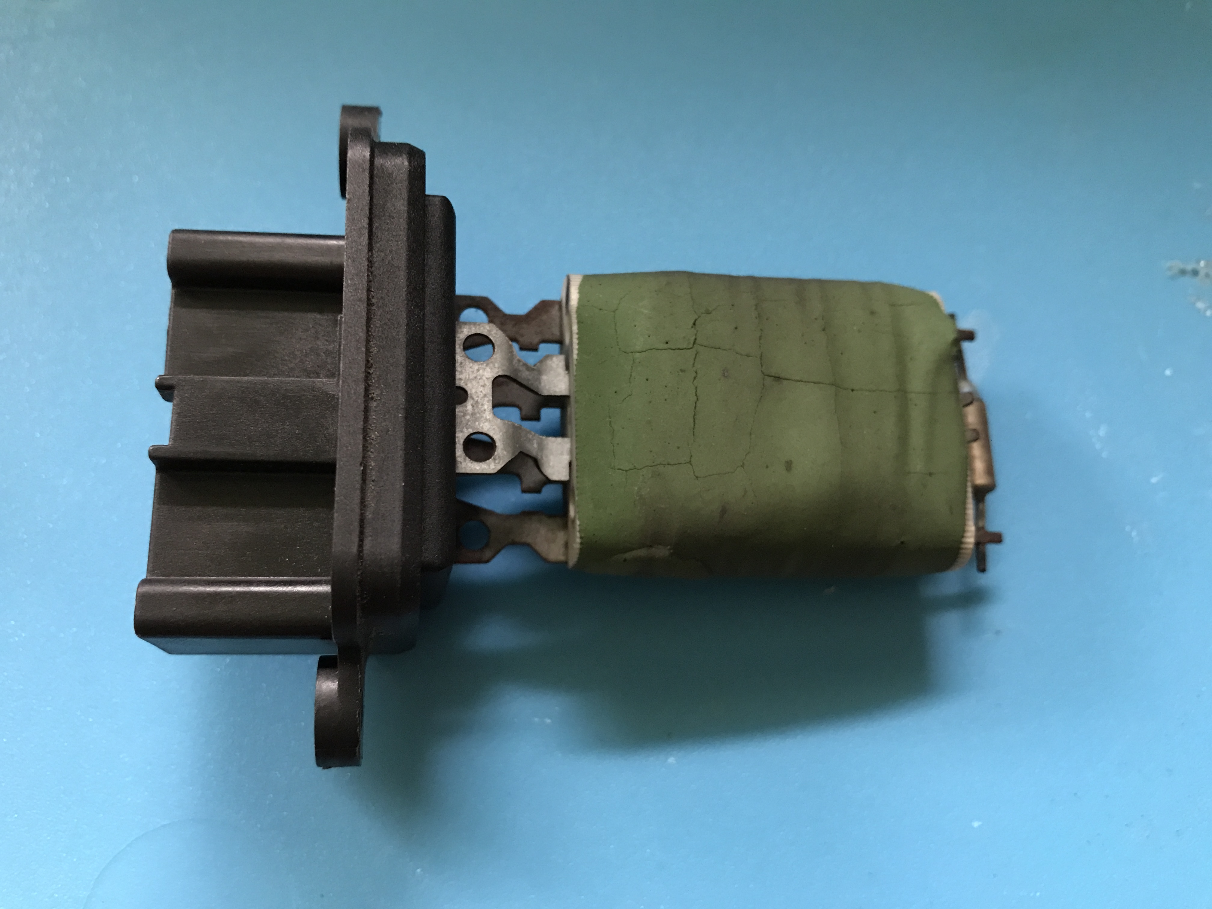

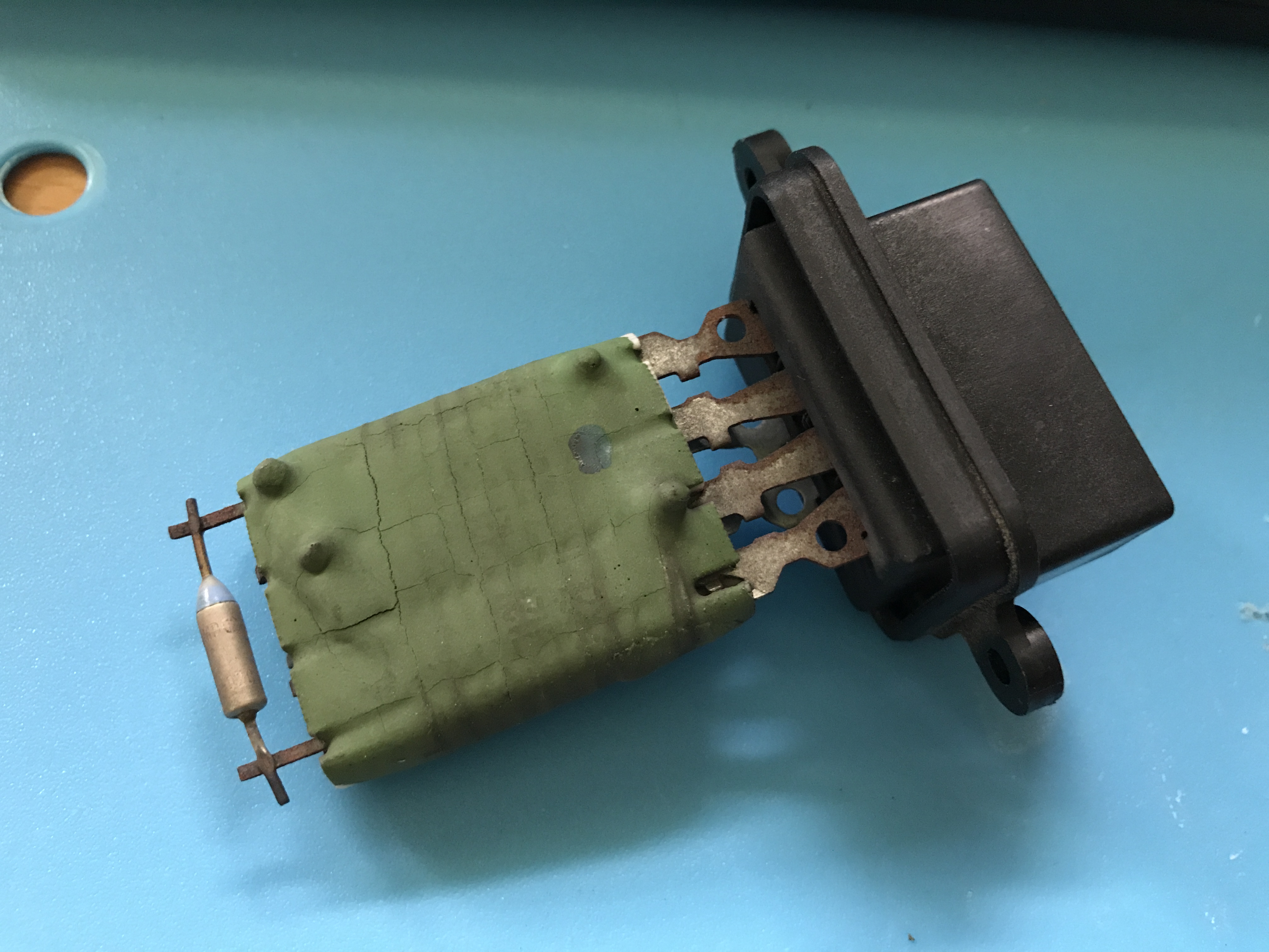

Ok, fuse is fine. Found the resistor pack, which looks old and knackered. How to test these resistor packs? Well maybe I should just buy a new one anyway. Wifey mcWifeFace reported a burning smell in the cabin a few weeks ago, so I guess that co-incided with the resistor pack burning out.
Are there any tests I should do on the dangling connector to check voltage reaches it? I suppose it should be 12V on each pin in sequence as the fan setting is changed from 1,2,3,4?
