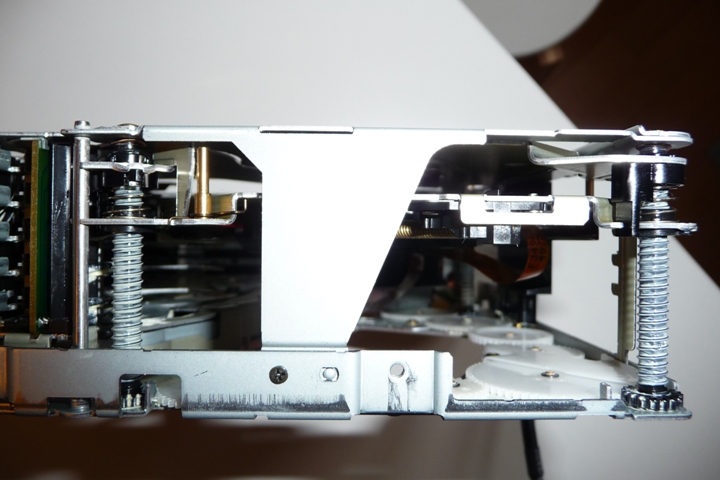

What was the problem ? Well the tray that holds and moves (up and down) a selected CD was out of alignment. It wasn't flat any more, but dipped in a corner.
This puzzled me, because the tray moves up and down on three separate screw threads (like a nut riding up and down a bolt, when the bolt is turned). How did they get out of sync ? But they were, only slightly though. One screw thread is connected via an arm to a sliding resistor, the problem was, that one of the other screws was forcing the tray to hit the top of the casing, before this one was. So it didn't think the tray had moved enough. It then tried to drive the motor still to raise the tray, but I guess it has a motor over current protection, and once this tripped (because it was driving the tray against a wall so to speak), it shut down and flashed the front panel.
Syncing up the three screw threads was a bit awkward at first, but not really difficult if you are OK with mechanics.

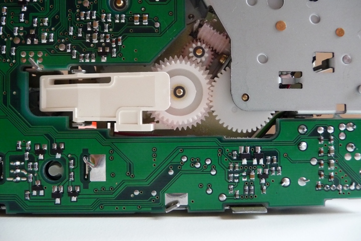

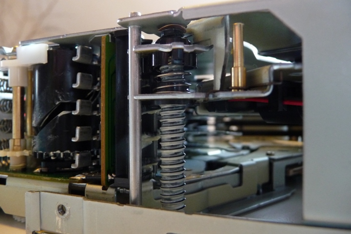

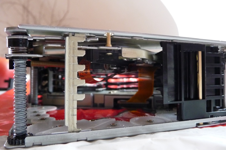

How time to have a look at the tray alignment. See the photo called "problem.JPG". In my case the top left screw in the picture was allowing the tray to hit the stop before the reference screw (see photo "calibrate_to_top.JPG"). I had to turn the top left screw, to bring the tray down in the corner, but I didn't want to turn the other screws of course. In the picture "paddle.JPG" find the same part on your changer. There are 2 of them, make sure you get the right one (though its not the end of the world if you push the other one in by accident). When you push on this paddle, you remove the drive to the gears which move the tray. You can now manually by hand, turn the white gear near this paddle, and move the tray. But this moves all the screws ... we want to stop on moving. See the photo "top_screws.JPG". This photo shows a top view, showing the screws that hold the top casing onto the spindles of the screws. If you undo these, and the "side_lift_screw.JPG", the small black one, you can then very carefully push the top casing up enough so that you can lift the screws up enough so they don't engage the white gears which turn them.
Now its a case of holding the paddle in, move the drive gear, pushing which ever screw you don't want to rotate, until you have aligned the tray. Doing this is a bit fiddly, but not impossible.
You might need to do this several times until you get it right. I calibrated the tray, so that the screw which has the sliding resistor connected, always hit the top end stop before the other screws.
