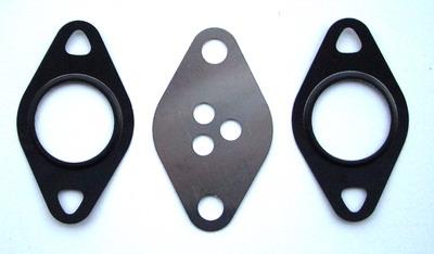

That would be the swirl plate supplied by Fiat.

Yes, they are available from Fiat.
Part number for the swirl plate is 71751469. Fiat say you also need two ordinary gaskets (part number 46773082) but I fitted just the swirl plate in my Stilo.

i dont see the point in fitting a blanking plate thats full of holes, you might just as well not bother.:bang:

the swirl plate was introduced as a remedy for EGR's becoming blocked.
By effectively reducing the diameter, the venturi effect speeds up the gas flow which deposits less crud in the EGR, general concensus is that it does work.
However, it's a retrofit and usually ends up being fitted in conjunction with the EGR being cleaned/replaced, would have been nice if Fiat had put their hands up and stated that the existing design was flawed and fitted this as a recall item.
Couldn't find a cost for the Multi, but the Croma swirl plate costs £13 which should be a good ball park figure.
Personally, I'd make a blanking plate and drill 3 6mm holes in it, you've got a picture in this thread for hole positioning, a couple of mil out isn't going to be critical.
