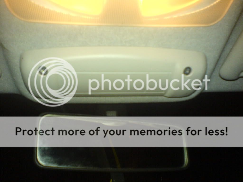

Hi,
I have a Punto HGT Y reg, and at the top of the windscreen above the mirror there is a facia that has what looks like two alarm sensors, one at either side but is then blank in the middle, leaving room for something! What I don't know....
Does anyone know what goes in, or can go in to it?

If I think on tomorrow I'll take a quick pic. Its positioned behind the light (towards the windscreen)... so if you like its in between the light and the mirror / Satnav receiver.

I think it has one, because locking with the fob flashes the indicators and then the red alarm light on the dash flashes on and off while the car is stationary and locked. And as above, there are 2 sensors positioned at each side of that blank facia in the headliner.

Here are some pics....
I'm just gonna set the alarm, and maybe leave a window open and then go mental and see if the alarm goes off. So your sunroof controls are in that facia dave?
