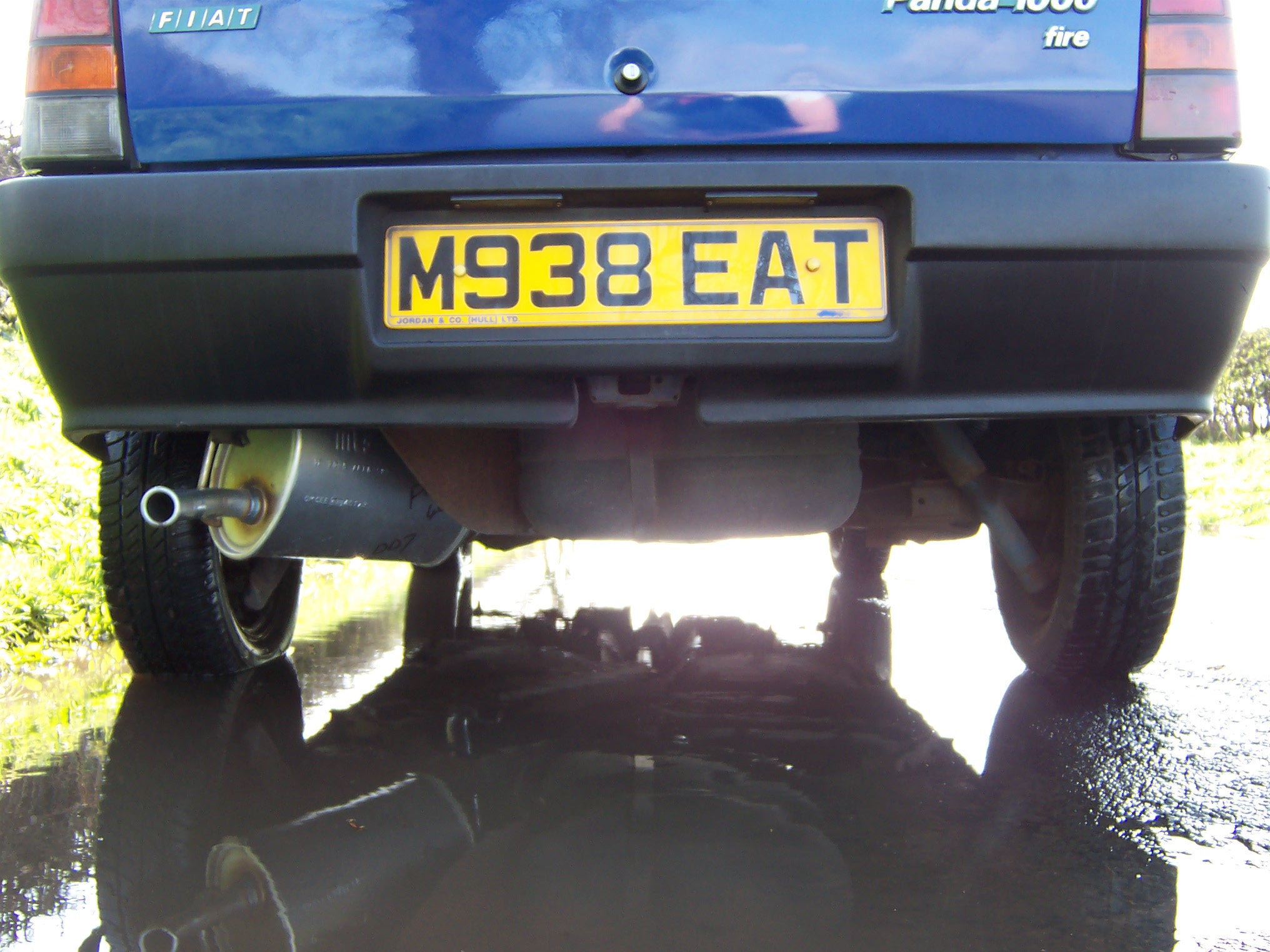

Been home since Saturday and the car is looking great after a good polishing on Monday. Went shopping for backboxes today and will have one tomorrow which cost a grand total of just £24! Luckily it's just the backbox I need, and luckily I didn't take up one garage's offer of £111. :eek:

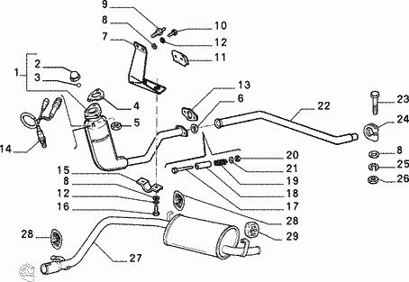

Exhaust is on and looking good, however there was a bit of a problem when disconnecting it from the cat. Unscrewing the nut from the stud that goes into the cat section, it took just half a turn before the stud broke and the spring fired the nuts into the backbox with a big PING.
So I'm on the lookout for a new stud that goes into the cat. It's temporarily fixed but after a quick test drive there is definitely some air escaping from the join at the cat.
So, you guessed it, does anyone have a spare stud?
I'll be seeing if the same-engined Uno at my local scrappy has one tomorrow, hopefully it will, but if any of you guys have one knocking around I would greatly appreciate it on my car. :)
Cheers guys.
Anyone got one of these studs then (see previous post)? I'll post a picture of what I'm on about if necessary. If someone can come up with one I will not only be delighted but will give some sort of reward or prize or payment to whoever has one.

And new backbox pic:
Alan.D said:
A new one will cost peanuts and guaranteed not to go PING!
Do you reckon I can get one from my local Fiat dealer, then? I suppose it's worth a try tomorrow, I can order my roof clip while I'm there too I suppose. My dad was adamant it would only be obtainable if I bought a new cat...
are sure its wise parking a panda in such close proximity to water?:p looks very clean underneath (y)
Well I went to my local Fiat dealer today and their parts software showed the stud as part of the whole Cat section of exhaust, not a separate piece like in the diagram you found Alan.
Very odd.
