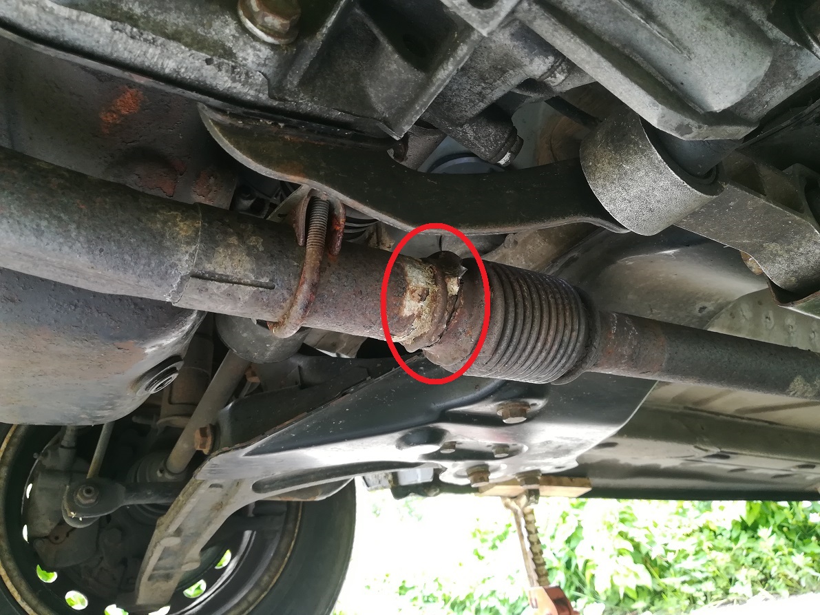

Regarding the blowing exhaust, the flexi does seem to get a hammering as the lowest point on the car. Mine recently got bashed to pieces.
I joined the small crowd on here who cut out the flexi and replaced, could be an option if you want to keep the Powerflow:
View attachment 427629![]()
Flexijoint | FIAT Panda (Mk3)
Had a look under car recently to find source of a tapping/exhaust blow sound type noise and noticed this on flexijoint. Centre pipe was replaced 2 years ago with flexijoint but this doesnt look normal to me. Or is it normal for a 2 year old pipe?www.fiatforum.com
The 100HP arrangement is different yeah. By flange I mean the two mating surfaces between the downpipe and the middle box. Mine has been caught on something in the past and bent out of shape, so it's actually forcing the top of the flanges apart, creating a blow. The flexi is actually perfectly fineBy flange do you mean this part? Repeated impact split my exhaust here.
That flange was part of the flexi on mine. The downpipe from the cat ends in a straight section of pipe after the bend. Unless the 100HP has a different downpipe arrangement?
Good shout! Just a case of welding a new flange on I guess?The flange on my 100HP downpipe sheared off/rusted through but I got it welded back on for £50...much cheaper than a new manifold/cat/downpipe.
They just welded the old one back on.Good shout! Just a case of welding a new flange on I guess?
Cool thanks!They just welded the old one back on.
I did that on my old Lancia, with a flexi from larkspeed, and to further support the pipe I welded two lugs and put springs onYou can buy stainless flanges and pipe so just make up a joint with a short stub for the flexi. Also check the catalyst outlet stub as they crack at the welds. I made a bracket from the gearbox to the exhaust flange to provide better support than the usual bracket.
