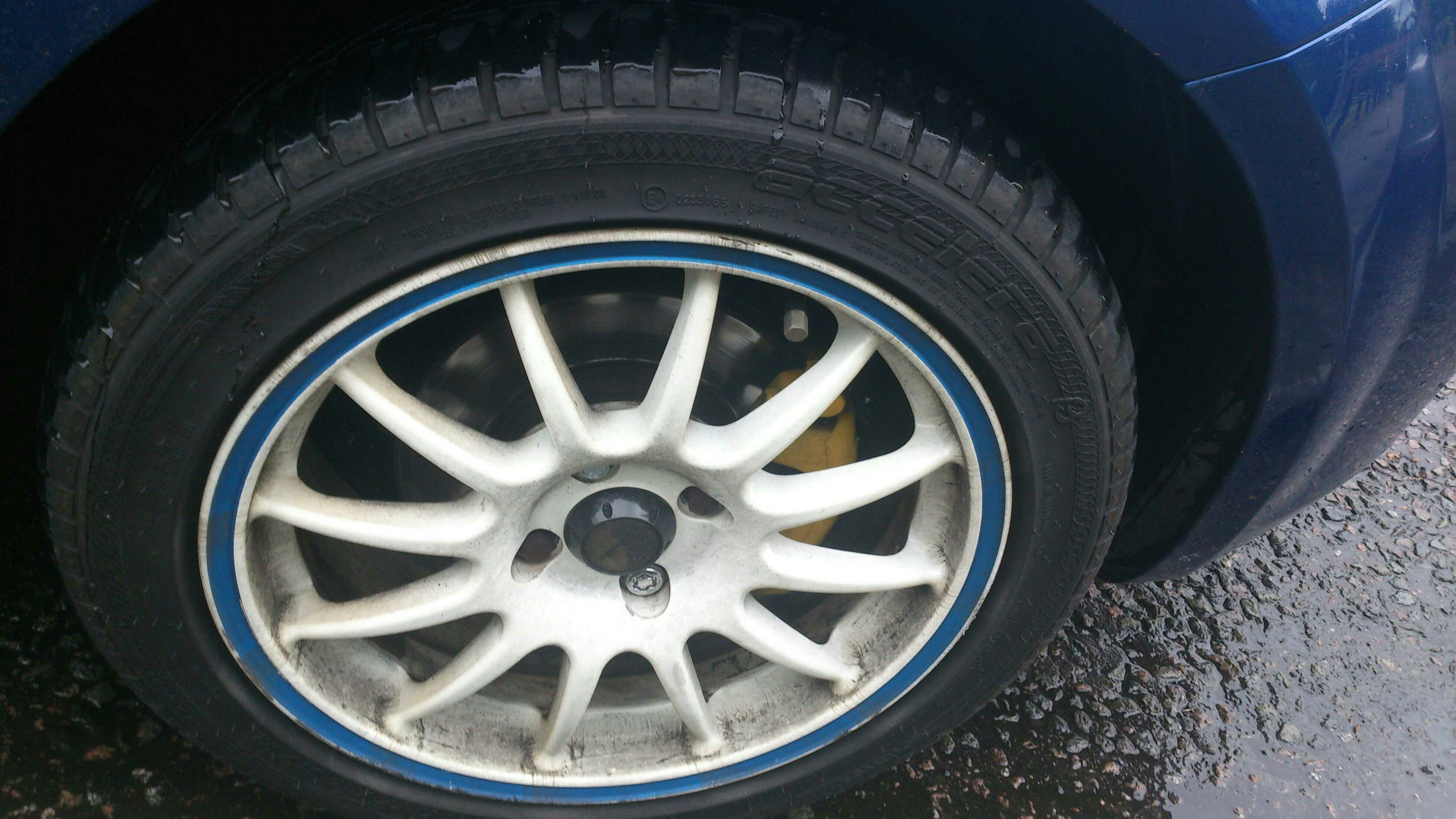

And for future use of course. I bought the car about a month ago and had to get the locking nuts taken off as the prev owner didn't leave the lock key. So I want to take the wheel off and give them a proper clean I been told Halfords do a good one but I rather stay well away from that place

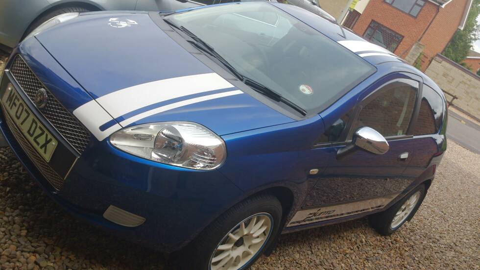

I still need to name her and I've had her about a month now!

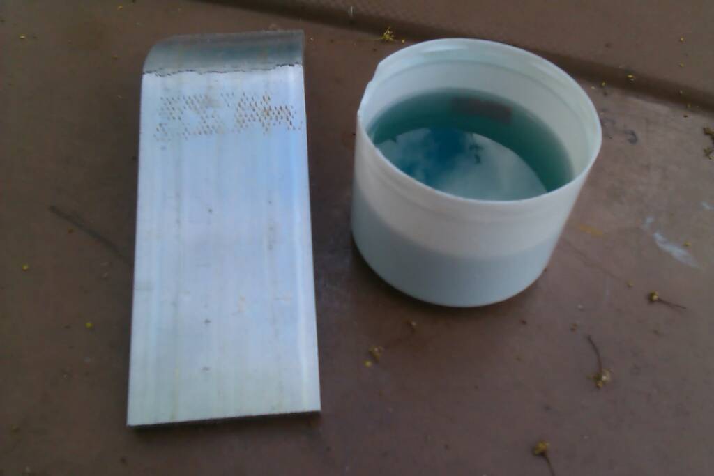

Acid based cleaners are ok on sound alloys without any damage BUT any with damage to the clear coat eg curb marks micro cracks in the lacquer or chips also alloys with diamond cut finishes your asking for big trouble....
This is concentrated trade acid cleaner not diluted just to show what happens in 5 mins to unlacquered aluminium........

Non acidic, safe for most/all wheel types and gets most stuff off. Also as its sold as concentrate you can dilute to whatever you want. So for heavy soiled, 1:1, or less. I dilute at 1:5 or 1:10 for a weekly wash. But for you with white wheels you could go less if cleaning more regularly, like every day? ;)
