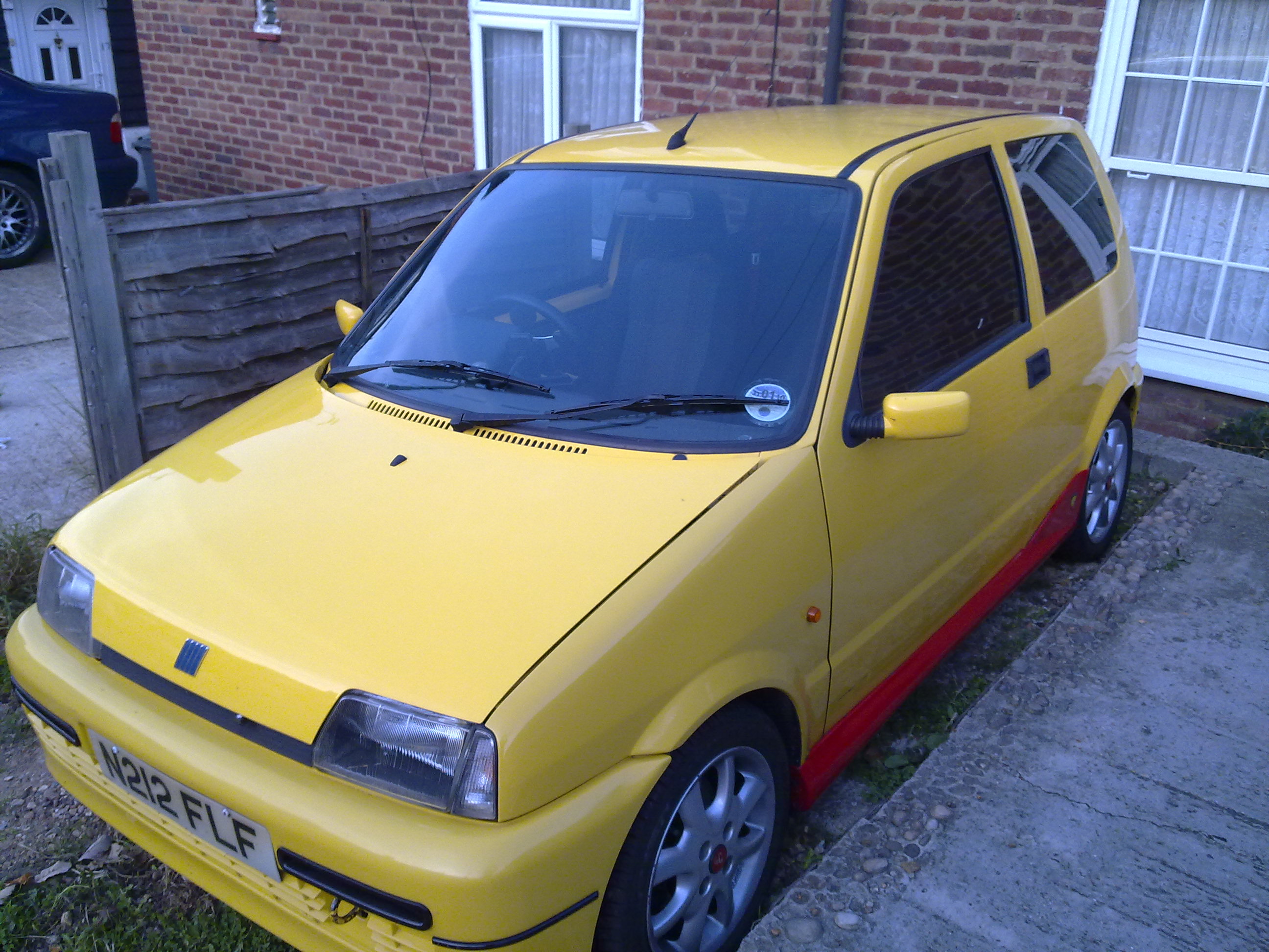

this is how my cinq looks at the moment in the attached pics,would value any opinions on it and what could be done to improve it.(y)
