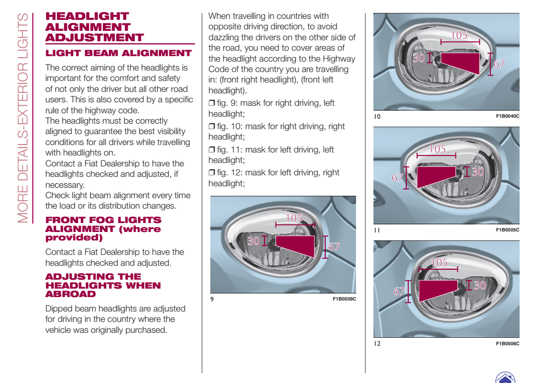

Ralf S.
From a later 500X Manual
I love translated user manuals.. 😅
Does "left driving" mean a RHD car, or when you're driving on the left?
I remember years ago, I had tape stuck to the lights in the shape of 11 and 12.. and the UK-supplied deflectors look like 11 and 12 too.. so I guess "left driving" means a RHD car... but now I'm bemused.
Ralf S.
From what I could see, the sticker for the 500 (non-X) appear to just go inline with the bulb, effectively making it a flat light pattern.
