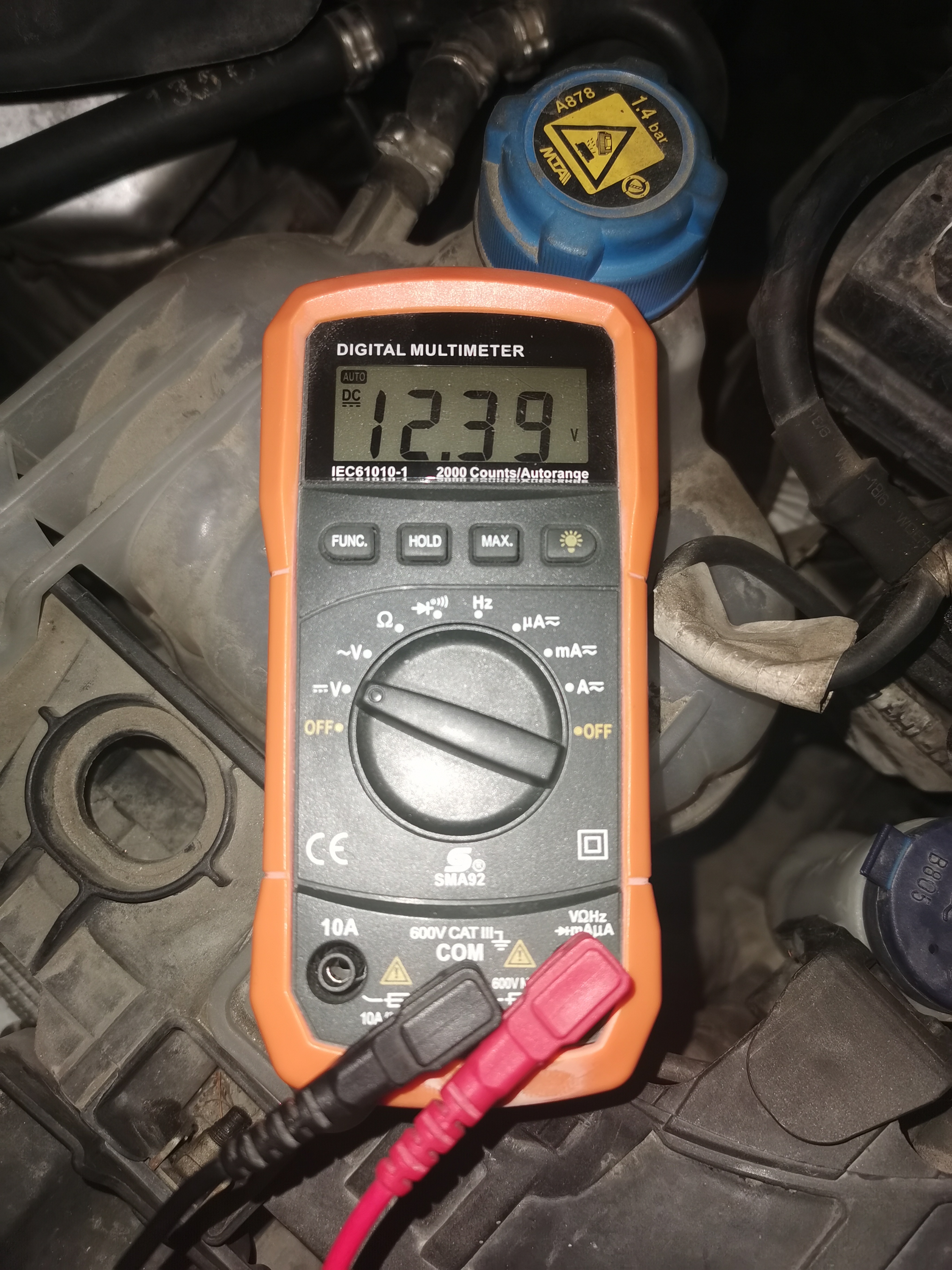

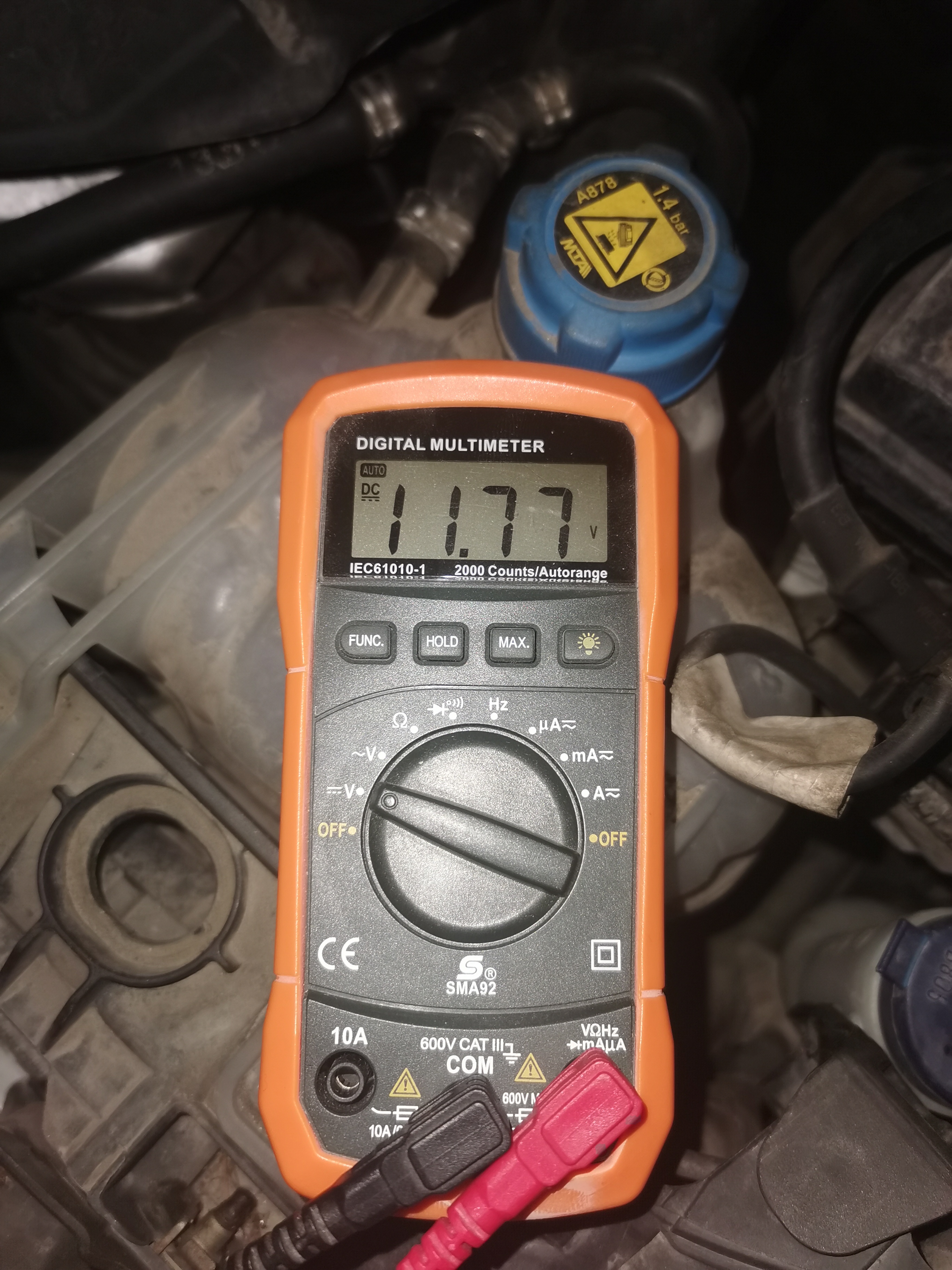

12.39 V is when the engine is off.
11.94 V is when the engine is on.
11.77 V is engine running and headlights on.
Tried again to reach the alternator but that is too tight and I'm unable to reach the alternator. The belts are there, I can hear something like a ball bearing squeaking from the area there the alternator is, but it's spinning and there is no sign of it being stopped or not spinning or the belt being torn.

That pretty much confirms that the battery is not being charged. You've no problem with cranking the engine though? which would seem to rule out the, always suspect, earth strap problem. If your car has aircon then the compressor really gets in the way of doing an alternator change so the next question is, are you intending to renew the alternator yourself - assuming it's croaked? If not then I think now is probably the time to hand over to an auto electrician or whoever you're going to get to do the job.

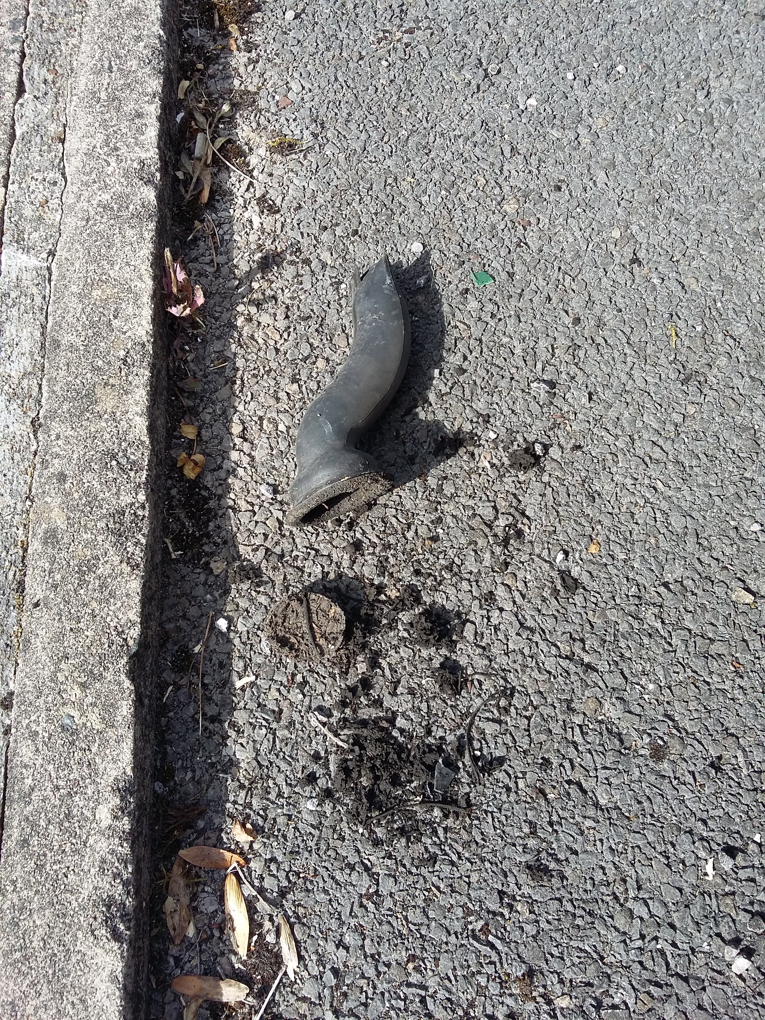

The Scuttle Drains have a rubber tube that directs the Rainwater down from the scuttle, on a 1.2 Grande, the tube dumped All of the Water onto the Alternator ( they changed the tube design by my 2012 Twinair)
Here is a photo from my 2008 mj, hose full of mud,
As you can see the disign means you can point it around by turning /rotating.. So you have no water on your alternator 😉

Seems like Satan really did engineer these engines by looking at the drain tube leaking water onto critical components in the engine bay. I found the tube and will try to get it into a better position, thank you varesecrazy for making me aware of this, as I've seen a lot of cracked DAN993's on the internet and was wondering why this is.
