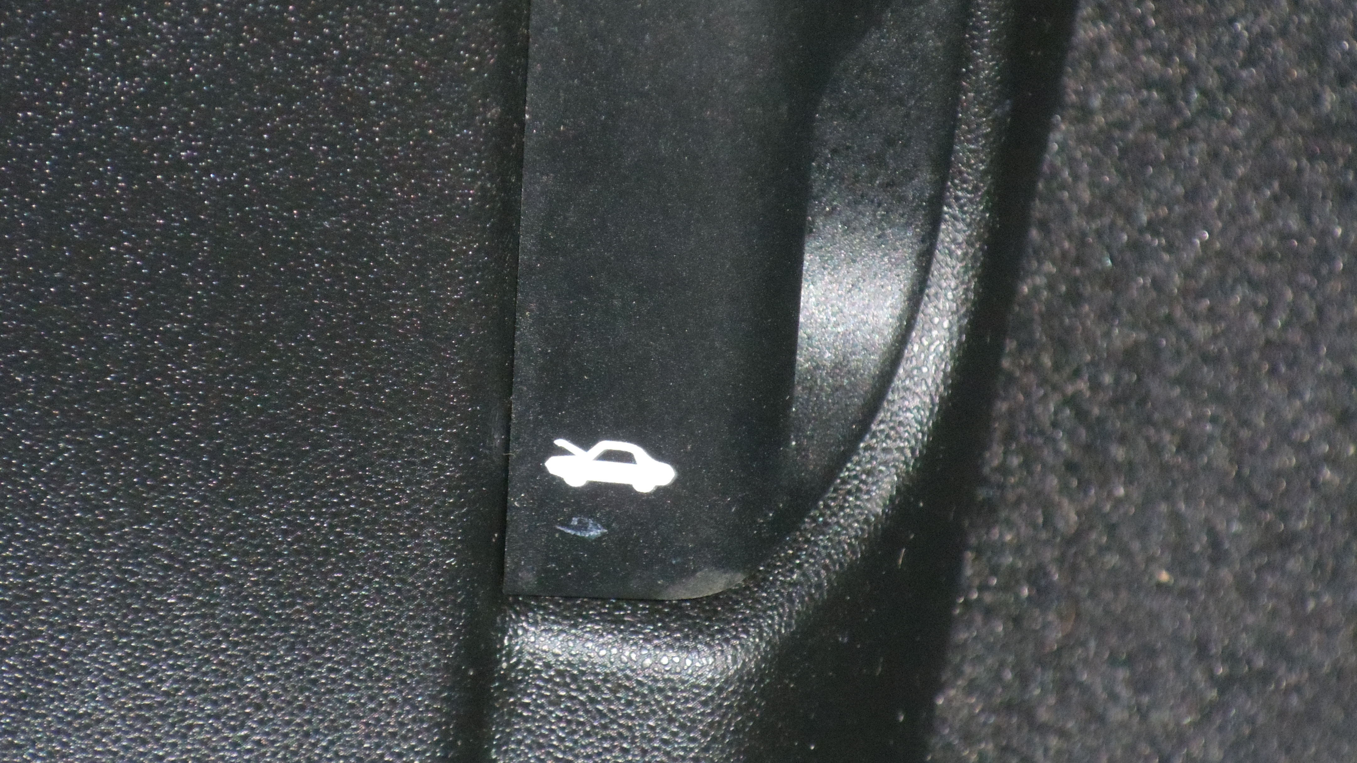

1) find the bonnet release lever in the passenger footwell (Uk left) and pull it till you hear the bonnet spring up....

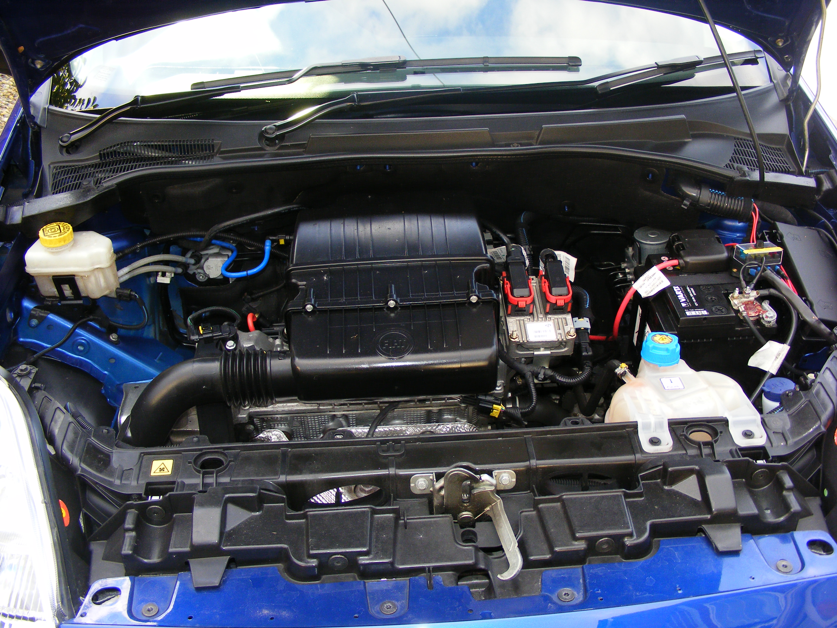

Now stare in wonder at the bits and pieces under there have a quick look about see any fluids leaking? or bits hanging loose... Sort them out
(This is a 1.2 engine the 1.4 is similar the larger engines will look slightly different but the checks you do are the same)
There are a few bits that need a closer look....
Brake fluid.. (yellow cap)
(bottle above drivers side (uk) wheel)
if you look closely the bottle and you will see its embossed with Max and Min see that the fluid is sat between them... If not it will need more attention...
Low levels can be caused by Leaks in the braking system, Leaks in the Clutch systems and excessive Brake pad wear,
If its below Minimum DO NOT drive the car till you know exactly what has caused the fluid loss and have topped it up correctly. (With the correct fluid check your handbook) Be warned brake fluid can remove car paint so dont spill it on the bodywork
(I have highlighted the markings in the above pic)
Next move on to the coolant look at the bottle it should be sat between Max and MIN
If its low look for leaks and top up with the correct antifreeze and water mix do not just use water (check handbook again for more info)
If it keeps going down there is likely a problem as the car shouldn't loose any water...
DO NOT REMOVE THE CAP IF THE ENGINE IS WARM HIGH RISK OF BURNS FROM SUPER HEATED STEAM

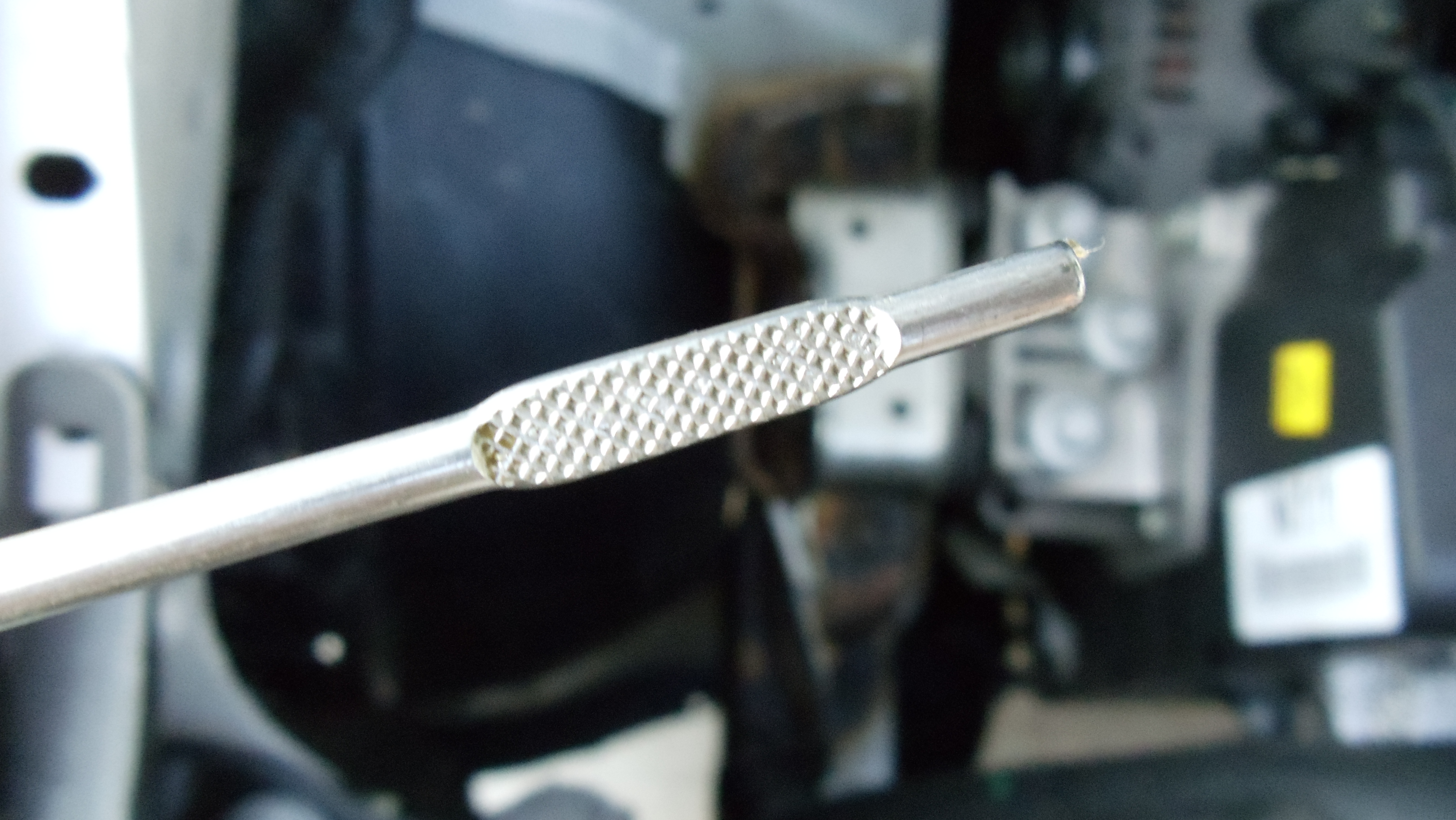

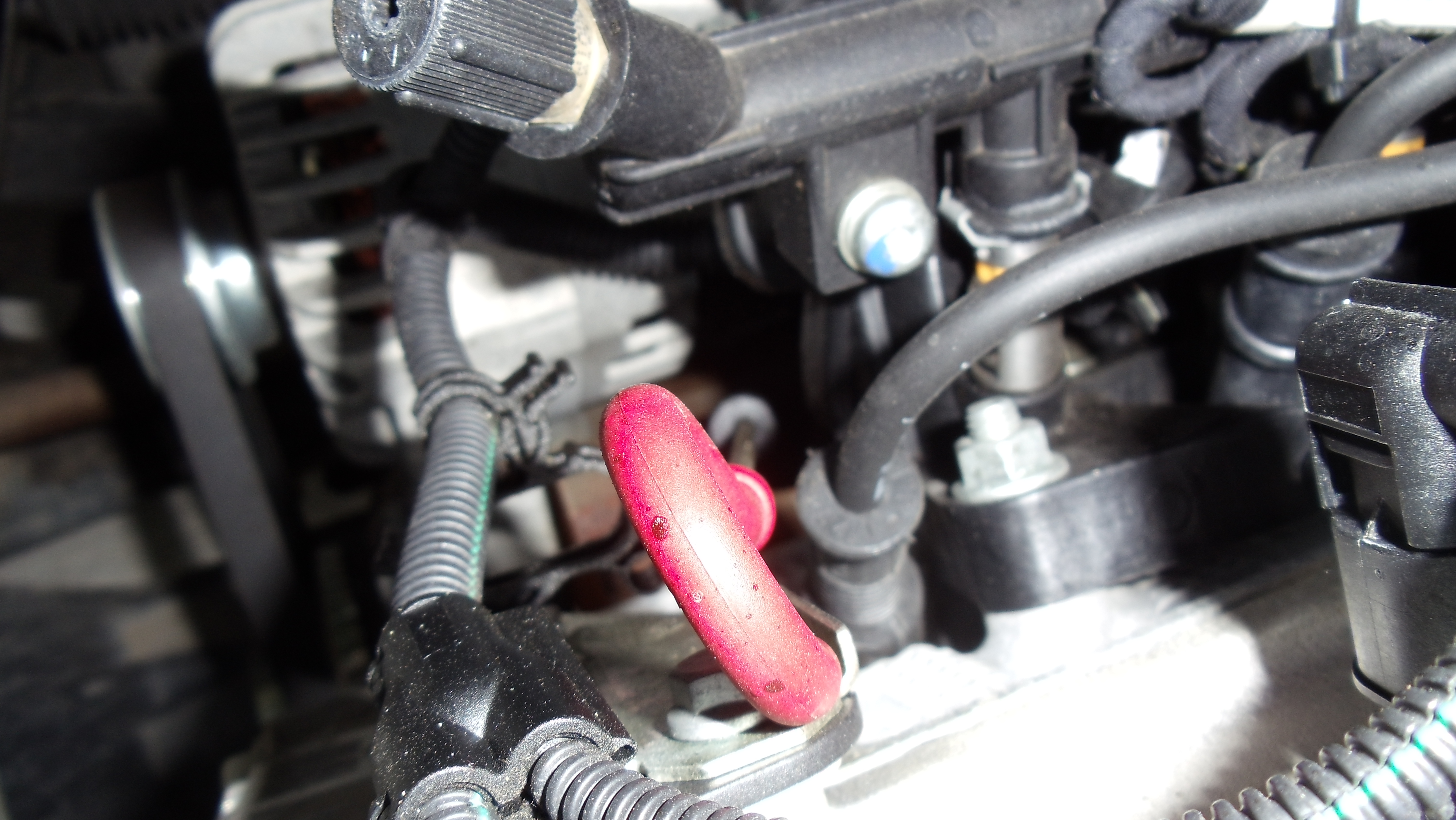

Locate the Dipstick
and pull it out and wipe with a bit of clean rag or kitchen roll
then put the dipstick back in the hole and leave for 5 seconds or so then pull out slowly and check the oil is within the hatched area then re insert and ensure its sat snugly in the dipstick hole

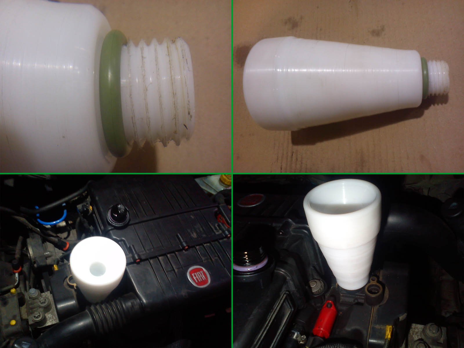

Then whilst your in there top up the screen wash bottle mixing your screen wash solution with the correct amount of water
