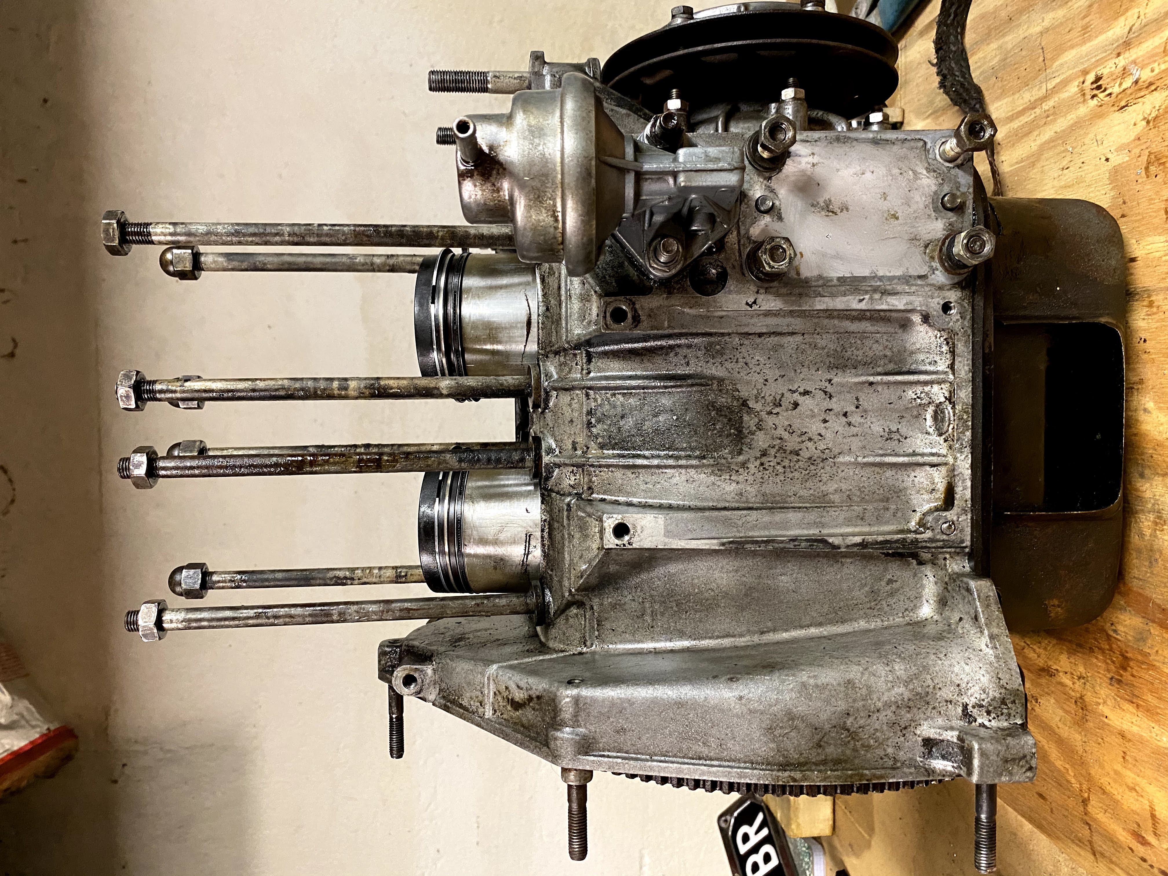

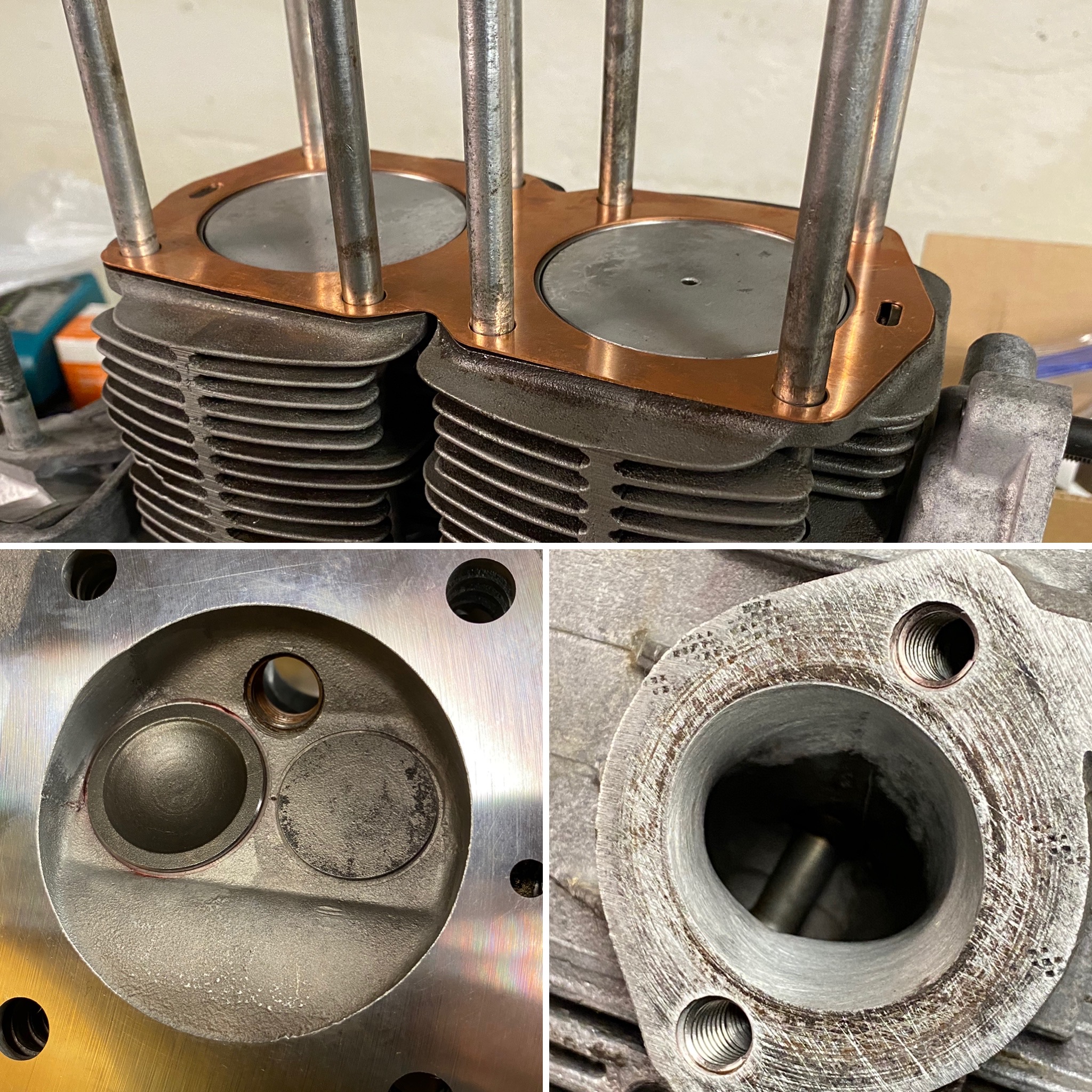

Got the head back from the machinist (yay) and went to put it on, finding that I'd have too much exposed thread for the cap nuts to thread fully on (boo) and still a ways to go to get the head seated (pic below). While I can't find this highlighted in any of the manuals, I'm thinking I installed the head studs in upside down - ie. the longer threads should be in the block side, while the shorter threads are for the head side. :bang: I probably didn't reference my teardown pics, assuming more thread makes more sense for the head side.
I'm looking at my pre-disassembly pics (below) and that appears to be the case, but just want to be 100% before I undo these.

Doh! stupid boy (with apologies to Private Pike)---got the studs in upside down; long thread goes in the block for the full length of the thread.

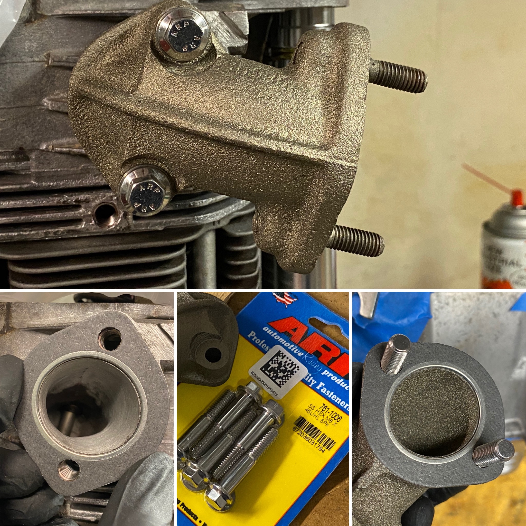

Fast forward 20 minutes and the studs are right again. Lesson learned. Got the head bolted on along with the exhaust manifolds. Mocked up some tin work to see how everything lines up and looks. Another L mistake to undo - the washers under the intake studs prevent the intake from seating, so tomorrow I’ll go undo the torques and fix that. Oh well.
Rather than go the stud route for the exhaust manifolds, I helicoil’d the threads and used high quality ARP hardware.

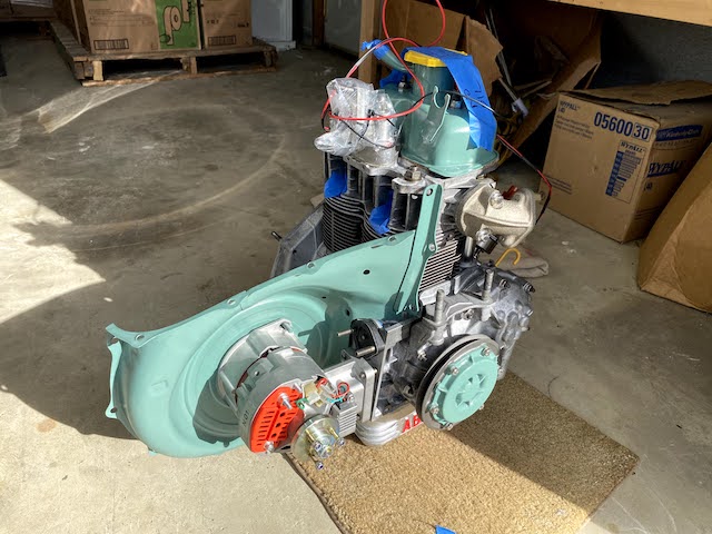

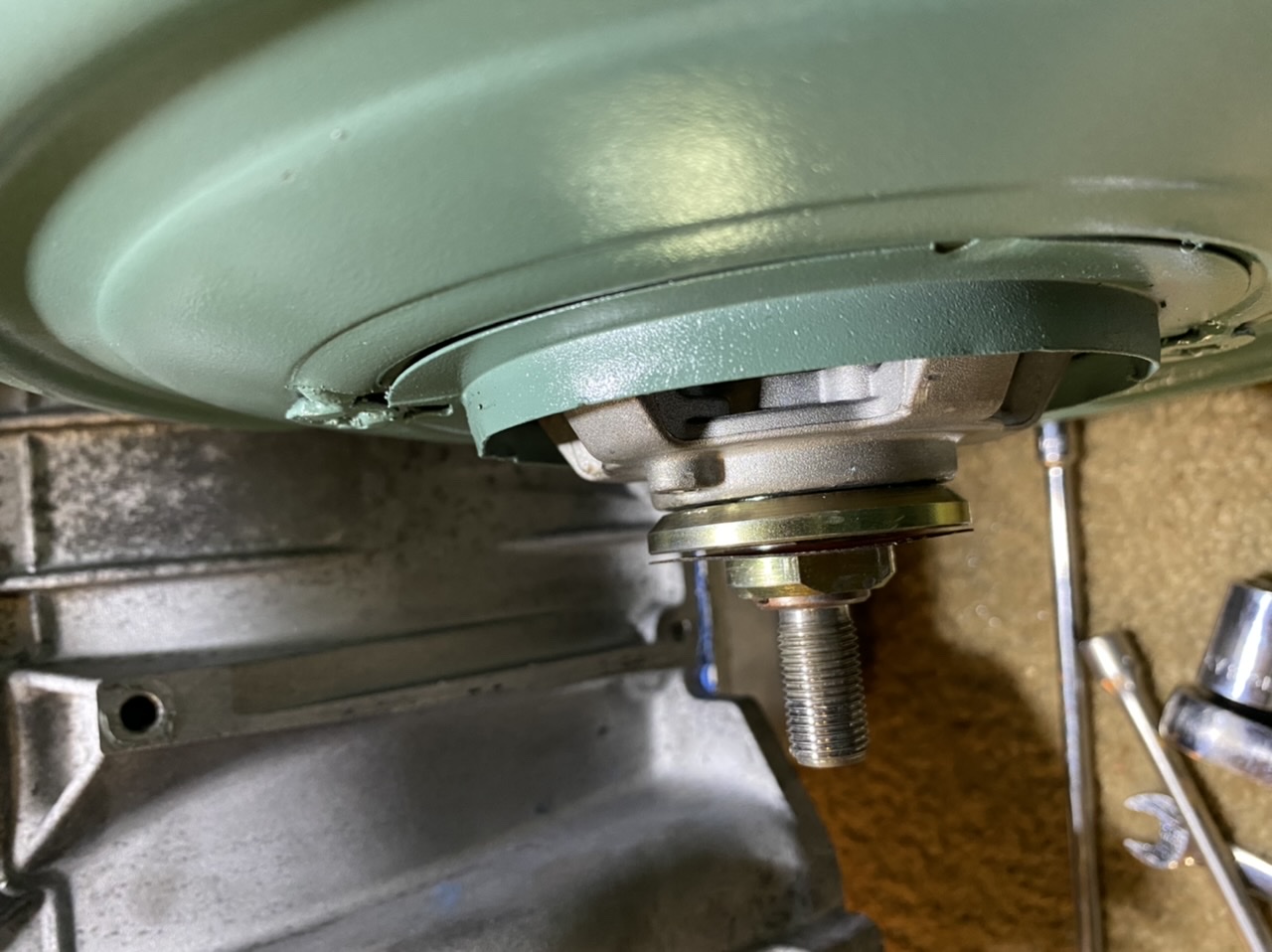

Good progress today (I hope). Got the motor mostly put together in prep for installation. I had to remove one of the alternator spacers (from the other thread) to get rid of some rubbing that occurred once everything was together and tight. Found a broken bolt down and behind the fan shroud that I hand't noticed prior. It wouldn't budge, so I let it lie. Ran out of M8x1.25 bolts, and found the drilled bolts for the head gasket are M10, where my head is threaded for M8, so I'll need to pickup some more bolts and rifle drill a couple.
So far, so good, but I really hope I don't have to replace the fuel pump anytime soon, as it'd be a PITA to remove because the studs prevent it from coming off w/o removing the alternator as well... which requires removing the tin, etc...

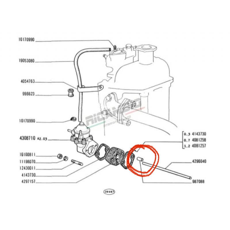

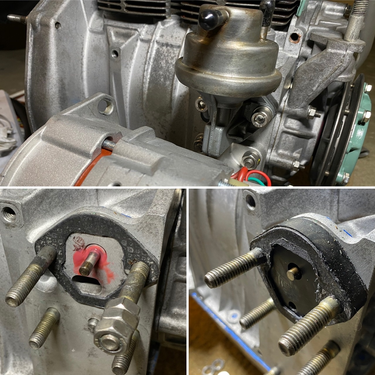

Which brings me to asking about the piece at the end of the fuel pump rod pictured below. I don't recall seeing anything like that on mine. I noticed when I went looking for the alternator vs. dynamo fuel pumps and now I'm worried I'll have to figure out that piece (and thus remove everything to get to it). Can anyone confirm/deny that there's a piece there I'm missing?

I have NEVER seen that 'end'piece' before,or seen that oart on an engine. There is a specific distance that the fuel-pump rod should extend past the end of the fuel pump spacer, which is adjusted by the number, and thickness of the gaskets you fit. Instead of studs, I tend to fit the fuel-pump with a couple of cap-head (allen) bolts (8 x 1.25mm thread, as long as required). Makes it a lot easier to remove/refit the fuel-pump should you ever need to, especially if you have a 126 specific fuel-pump which is angled at it's lower edge, (vis-a-vie the 500 pump) specifically to pull out over the alternator.

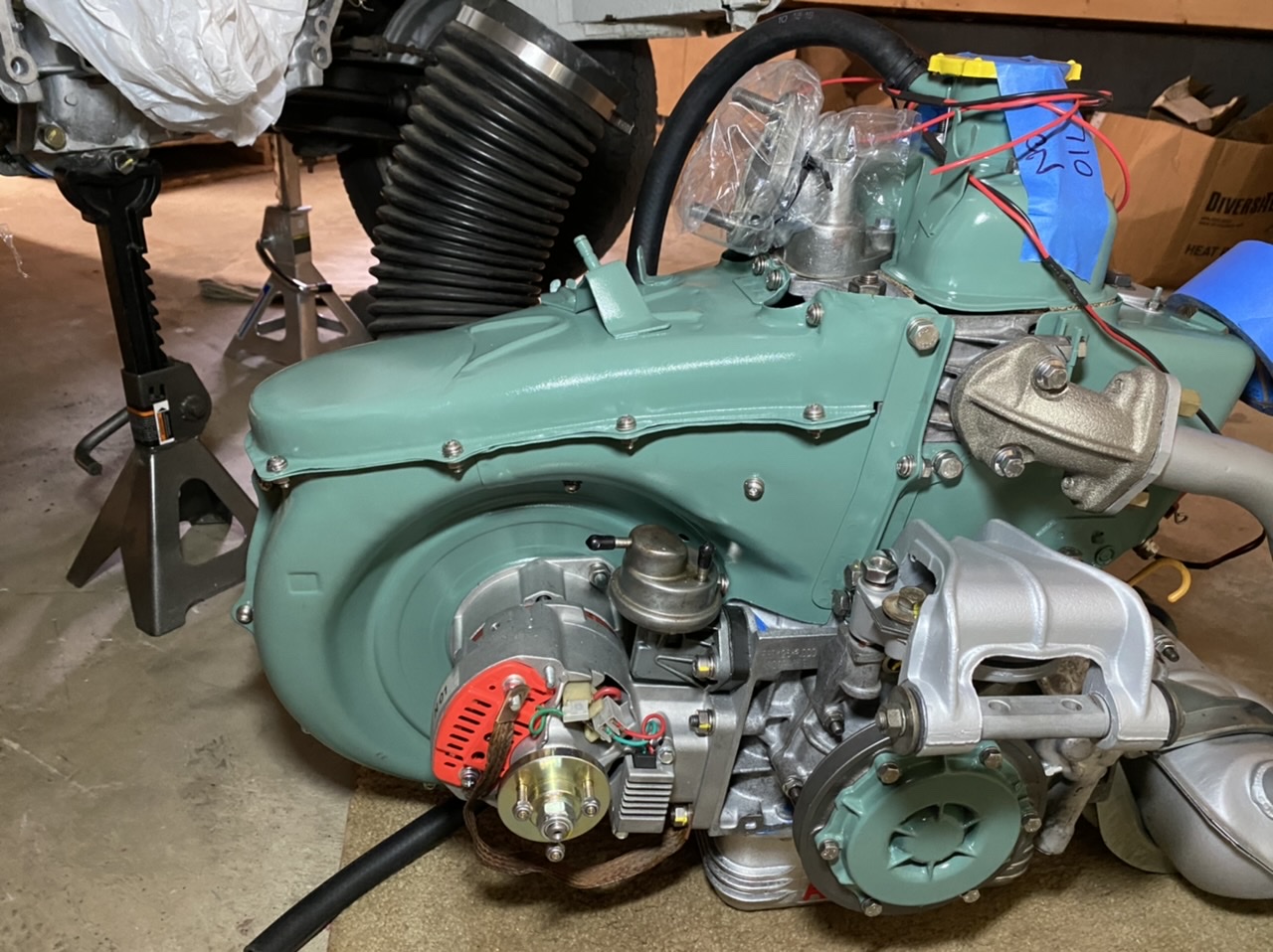

Had another look at you the pictures of your VERY smart engine Matt---you will find it a lot easier to fix the big air-intake hose to the ENGINE prior to fitment of the engine rather that the body. Once the engine is in, then slide the air-tube onto the bodywork---I hold it in place with a couple of big 're-useable' cable ties joined together (haven't found one long enough to do the job on its own)---makes for much easier fitment/removal.
There's nothing to see here. :D It's not on the rod, it's the metal guide-bush which is inside the block to keep the push-rod aligned.
Spot-on Peter----part number:--987088--'bush' (or, to give it it's correct Italian name--boccola).
Thank you for the quick response gents! That's reassuring. While I didn't measure the pump rod protrusion prior to assembly, it was the pump+spacer that was on the motor prior an it had no supply issues. I think I'm going to bite the bullet and take everything apart, now that the motor is out, and replace the pump studs with hex head bolts. I just know that whenever the pump fails down the road, I will cuss myself for not making it easier when I could have. It looks like it'd still be a tricky R&R, but a long allen socket may get in there.

Tom - I just kind of stuck the intake hose there for the time being. I'm off to the hardware store today for (what I hope) is the last batch of hardware (before I tackle the throttle rod) and I'll be on the hunt for some BIG stainless jubilee clamps for the ducting, cold and hot.
While I didn't measure the pump rod protrusion prior to assembly,.
When you look at the explanation of the point at which to measure the protrusion and realise just how tricky it is to definitely identify that point, you might do what I do and give up trying.
If we all had the original pump as supplied by Fiat, I am sure this is a definite marker for the correct setting. But I have found that the myriad of optional pumps that I have available to me all have slightly different arrangements of the actuating-lever. Recently, when I wasn't quite getting an adequate fuel supply, it seems that the protrusion of the rod needed to be more than specified to make it work properly. I found that replacing with a pump with a slightly chunkier lever did the trick.
Therefore, I wouldn't worry that you didn't verify the measurement.
All good now. It was a lot easier the second time around to r&r the tin work. Pic below shows the pump rod distances I have and the final state with hex head screws. Now I’ll be able to replace the fuel pump without disassembling the whole motor. You can see the final gap I wound up with for the fan hub.

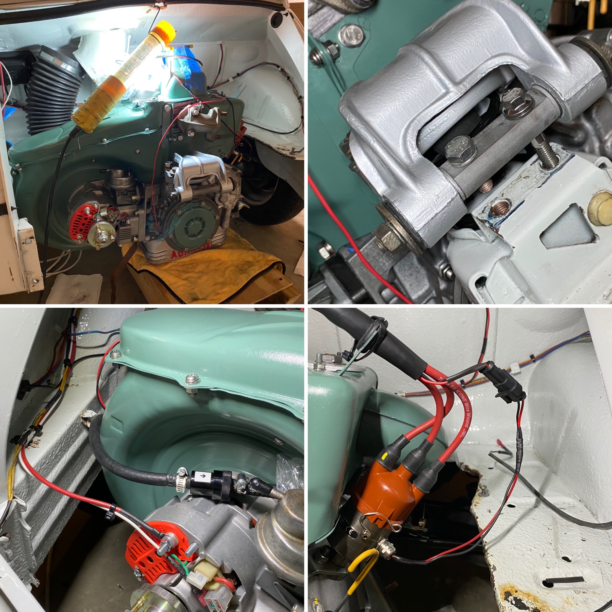

The engine is in! It took a little while to do single-handedly, but it’s in. Alternator is wired up, I wired in the distributor with a weatherpack connector for easier wire changes and/or dizzy replacement. A few final connections and adjustments remain, but ????it may run this coming weekend.
Any tips for initial clutch adjustment or ideas for what to do with the choke cable (my FZD is sans choke)?

Morning Matt; I also run a FZD sans choke cable and my proceedure is to give the throttle 2 or 3 slow depressions (which activates the accelerator pump), count to 10 and then crank. Unless it is very cold, which it has been up here in North Wales recently, the beast fires up, Sometimes I have to give the throttle another pump and then crank again and 'catch-it'. The reason for the count of 10 before cranking it is to give the fuel time to evaporate--vapour fires up a lot better than 'wet splodge'. I normally find that by the time I have gone about 1/2 mile down the road (first junction onto the main road) the engine is warm enough to idle properly.
For a brand new engine I would reccomend removing the plugs and cranking the engine until the oil light goes out, then refit the plugs and fire her up.
You might find that you have trouble pulling fuel through initially--I do if the engine has been out for any length of time. My trick is to remove the fuel line from the the pump (the 'in' line), put a can under the open fuel line and then pressurise the fuel tank until you can hear fuel coming out of the fuel line, and then quickly reconnect the line to the pump.
Clutch adjustment----1-3/8 to1-9/16in at the pedal--(35 to40mm) of free play at the pedal.
