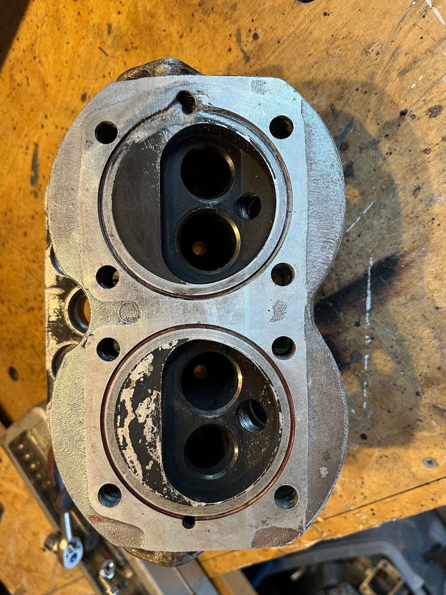

I bought a 650cc engine with some bits missing on the cheap in order to convert it to a semi-hot 695cc. Basically I only wanted to use the crank case, crankshaft and cylinder head as the rest of it is getting replaced anyway.
When I took of the head I was greeted with this (see attached photo)... Well, I now know why the engine had bits missing:unsure:!
I have a couple of questions:
  • WTH happened here? I've seen faulty head gaskets before, but never this kind of carnage... And I suspect that not all damage (of any!) is caused by a leaking head gasket, there is evidence of mechanical damage too, almost as someone was trying to grind away material with an angle grinder. But why?
  • Is this head salvageable, or would I be better off getting a new head? The plan was to skim the head, get bigger valves and smooth out the ports so extensive work is going to be done on the head anyway, no matter if I buy a "new" one or not. But I am curious as to what you think: is this damage repairable?
How much of the damage would dissappear if it was skimmed? The head can take a fair bit of material being removed.
If a head gasket is blowing badly enough, for long enough, the hot exhaust gasses can actually eat away at the aluminium and burn holes in the head.
I think that is what has happened here, and then it has been welded and repaired. Possibly not to the best standards of you can see grinding marks still!
Welded repairs to aluminium heads are perfectly acceptable when done right. I’m sure an engine shop could weld up the damage and skim the head flat for you. I had similar repairs (though due to corrosion on the water jacket) done to some Daimler v8 heads a couple of years ago.
… but given it will take the shop a few hours work to correct the issue, you might be financially better off just looking for a good secondhand head.
The best bet would be to consult the machine shop you plan to use, as @smart51 says, the damage might just be skimmed off anyway as part of your performance plans. 🙂
Although slightly ugly in theory with a skim the sealing surface for the head gasket would be restored. If the screw threads in the alloy head are intact and no sheared studs then I would say worth saving as it is one of the later style cylinder heads. I think that Goldnrust has assessed the situation accurately.
I agree with both Toshi and Goldenrust----I would be tempted to have an "engine-shop" skim the head and THEN make an assesment. If taking 60thou (1.5mm) off the head still leaves about 40thou (1mm) in the depth of the relief groove gives you a good 'gasket' surface then you should be OK.The relief groove is about 2.5mm (100thou) deep from new, so measure it first, just in-case it has been skimmed before. As Toshi has pointed out, it is one of the later heads, so worth trying to keep if at all possible. Please let us know the outcome---could be useful to somebody in the future.
