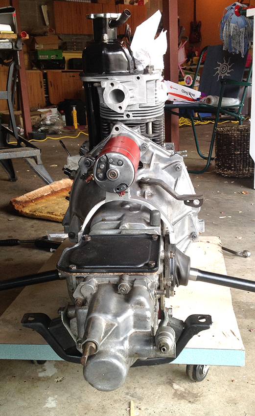

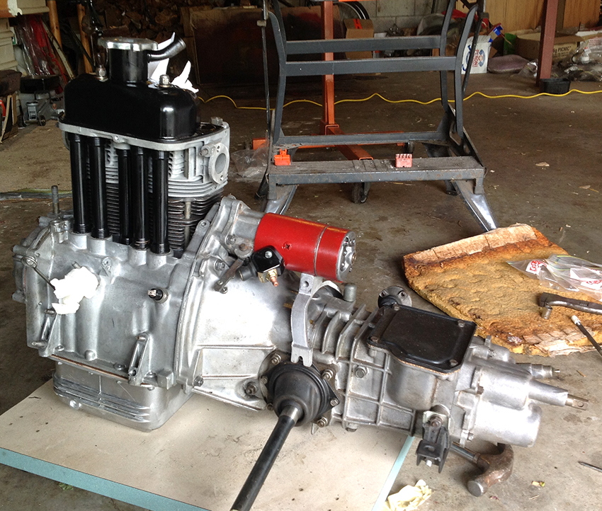

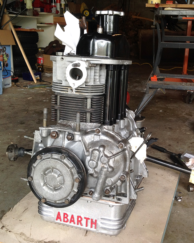

Finally got the engine sorted. It's already been re-bored to 594cc. Toshi bought a ground camshaft into New Zealand for me. Fitted that along with a new timing chain I picked up in a box of goodies. New 3.5L sump fitted. Fitted new clutch and joined the gearbox back to engine. Already fitted thicker axle to gearbox. Some pics attached.
So now the engine rebuild continues as soon as I can find some time. Petrol pump, carb etc.
Panelbeating is almost finished. Hoping for a respray in the new year and then major rebuild starts. Can't wait.
Tim

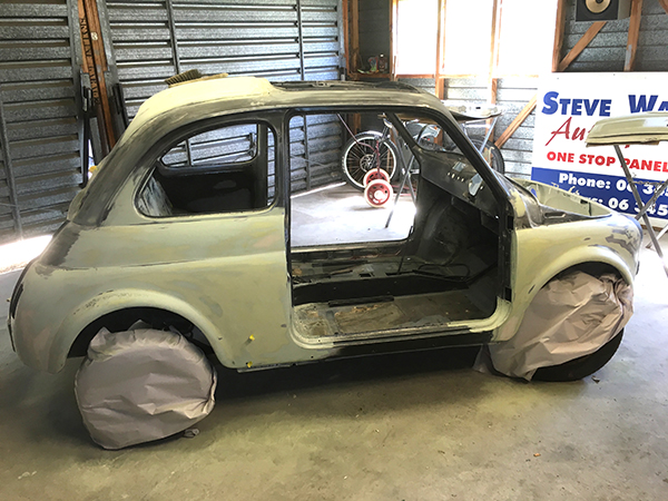

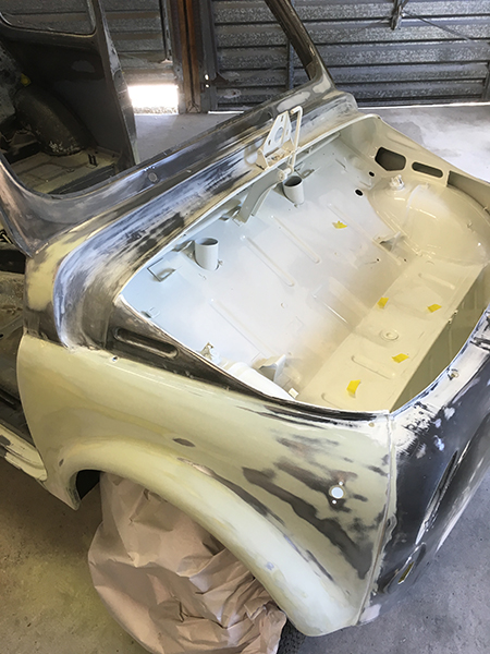

Here's some pictures of how mine is looking. Probably a couple of weeks from coming home.
Doors are in an acid bath next week.
Tim

Wow Tim it's been there over a year now hasn't it? I assume they are doing the final spraying as well before it comes back to you? I would be surprised if they are doing the final spraying whether you see it in a couple of weeks.
I think you had a similar arrangement as I did whereby they would fit the work in when they had quiet periods. My body work was all sorted quite quickly but the spraying initially started quite quickly but with all the rubbing down and correcting any imperfections it seemed to drag out to two maybe three months in the end. Then the car was sprayed inside first and in stages on the outside after, the only advantage really with the length of time was it allowed time for the paint to cure harder even though it was baked in the oven.
If it has been there that long I wouldn't get too stressed about a few extra weeks. Engine and gearbox look really good, a lot of hard detailed work gone in there. Putting the car back together is the where the fun really kicks in, I loved it.
What colour is it going to be?
Tony
Hi Tony
No, it won't get sprayed there.
There's still some work to do on the doors too, when they have been stripped.
Also some work on the boot lid. Underseal to replace on the bits of floor that got replaced. And there's one annoying thing on one of the brake drums. The little tab that goes over the top of the spring between the shoes has broken on one of the brakes. I figured it should be easy to weld a little bit of metal to replace it.
There also seems to be some confusion about whether I need to get the welding certified here in NZ. Roger might be able to tell me.
Then back to me. I've got to go over the nuts and bolts of the wheels and steering linkages to make sure everything is tightened correctly. And figure out if I need to strip out the sound deadening that I very carefully painted in the engine bay. Still not sure if it's gonna melt or if I can just spray over it.
Then time to spray. I'm going for an off-white, but not cream. I've seen a new mini in the right colour and there's lots of modern cars that are white but not a really bright white. Interior is black and red – mostly red.
Really looking forward to the rebuild.

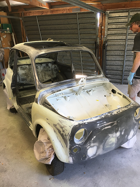

Very little time to work on my 500-F recently, but the good news is that it is virtually ready for a respray.
Have just found that both front wheel bearings need replacing before this happens.
There's always something...
Tim

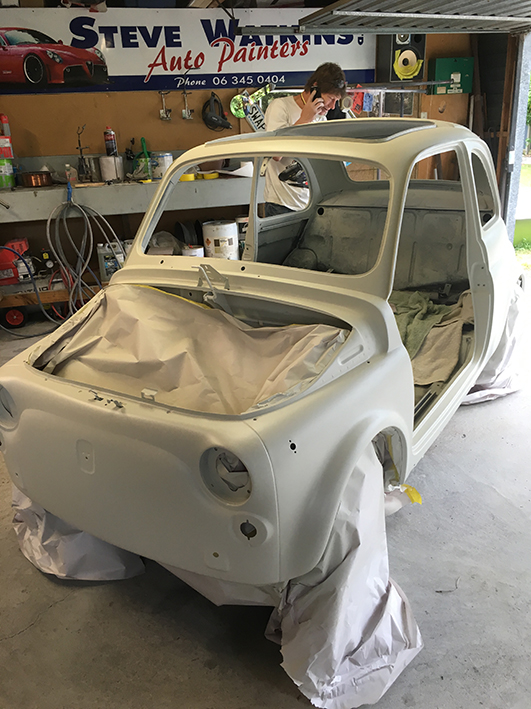

This is the first full primer coat and is also close to the final colour – an off white called Diamond White – not an original colour as far as I'm aware. I see a number of new Minis and Hondas in a similar colour.
Interior to be sprayed this evening. More progress at the weekend.
Tim

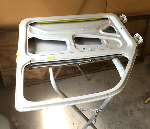

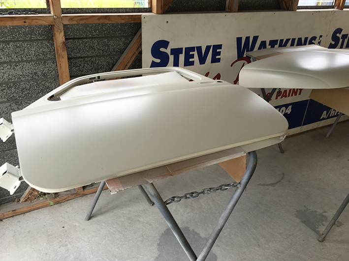

Some pics of the interior sprayed. The outside is just a cream primer. The final colour is actually lighter then the cream primer, despite the interior pictures suggesting otherwise.
Onto the outside this week.
Tim
