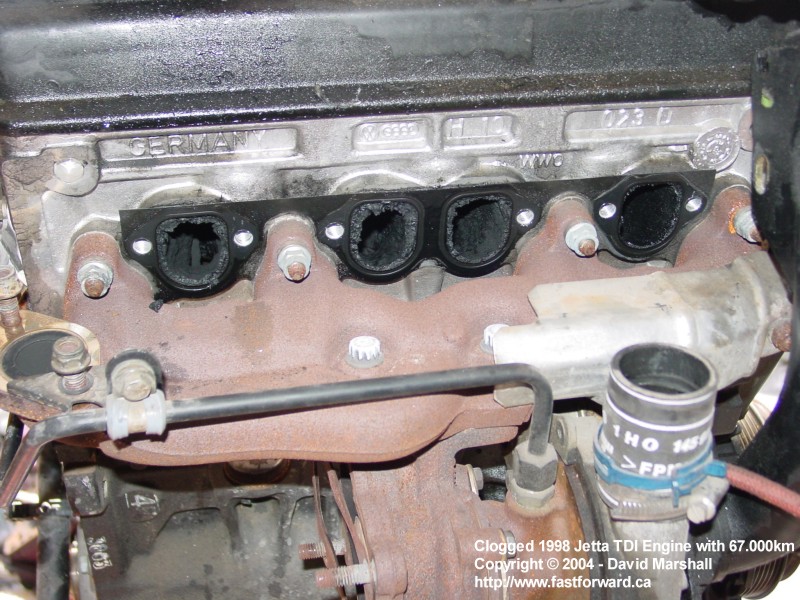

Why's that? If anything it's beneficial to the intake manifold. Take apart any TDI intake manifold and look at all the soot left due to the EGR valve "re-using" exhaust gasses. On 99% of cars, bypassing/blocking the EGR valve causes no problems come MOT time. Hell, even my 2.0 16v Astra runs smoother, pulls harder and is more economical since I've blocked the EGR valve and absolutely no problems what so ever in the last 2 mots.
http://www.stealthtdi.com/TDI-Problems.html
Some pics if you haven't got time to read the above...
the above is why i am going to clean the intake manifold as soon as.
