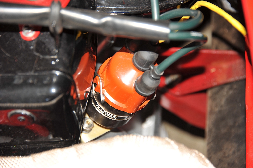

Here is the promised photo of my 123ignition distributor mounted on my 500 engine prior to rebuilding it as a 695. It won't give you a lot of information though.
Chris

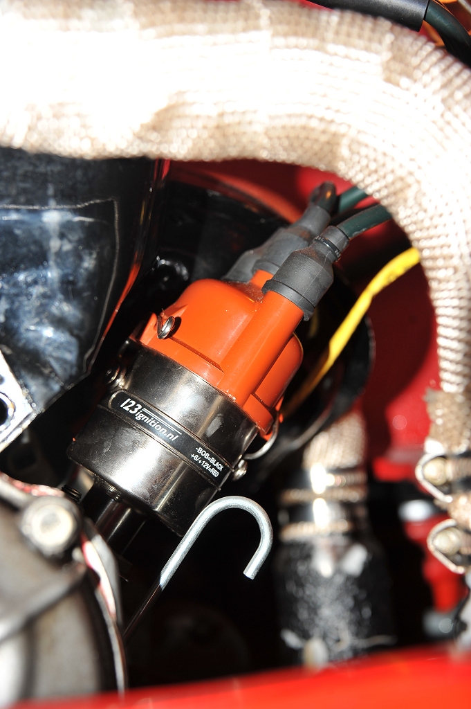

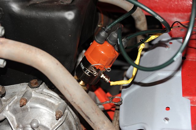

I just checked my distributor position and have posted a few photos. When cylinder 1 is about to fire, the rotor points nearly parallel to the block. This is the final position where I got smooth idle and acceleration. My engine idles at 800rpm and the 123 is setup for standard advance and yes, the engine was rebuilt correctly.
Prior to the rebuild, the ignition leads were aftermarket and quite long so it was easy to interchange them. Now I have the post marked 1 going to cylinder 1, though it doesn't really matter so long as the cylinder nearing the top of the compression cycle is about to get the spark.
Sorry to add to the confusion,
Chris

Okay Chris, now you have really messed me up regarding the distributor cap as it appears now that the lower section faces the rear of the vehicle (hence one can clearly read 123 Ignition) and your cap is running parallel to the engine block! Sorry if I am a little slow on the uptake, as I said at the very beginning of this thread, "Newbie Alert"! (oh and not much of a mechanic either!) By the way, mine base has the label in the back and the cap runs perpendicular to the block.
