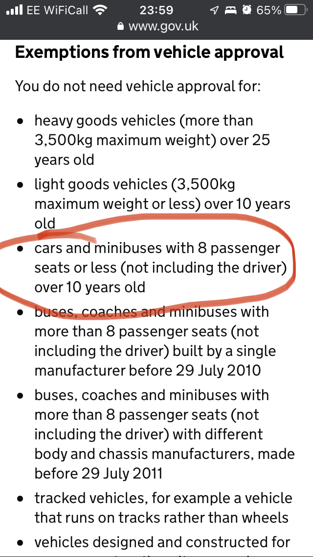

As it is over 10 years old, do you still need IVA?
I wonder why they would have a 10 year limit on that?
I could see 30 or 40 year old cars may have a problem with some parts of the rules, but anything made in the last 30 years should be compliant.
I'm not sure it's one of the questions I have to address as ever the rules are only interpreted by the station or person you ask...much the same with any UK GOV blurb its contradicting and opaque and made so that they can 'feck you' if the need arises...nothing is black and white even if it's on their website...'written' in black and white... Will hopefully be able to say 'Not needed' sometime soon..(once I get the car 'ready' so to speak...B-)
This car will have been built with European Type Approval. Surely IVA is for vehicles outside of that. Shouldn't be a problem.

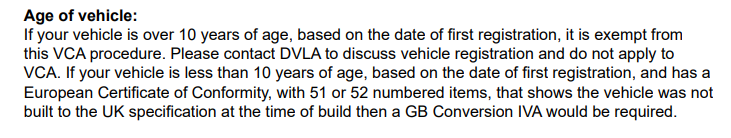

There seems to be the VCA, vehicle certification agency that decides what's allowed to be on the road. Speedo does look to be on the list of things required.
Because of brexit, I'd not be so sure it automatically means it's ok. Europe hsould be seen as no different to Japan or any other country now.

Still trying to decipher whats what..I believe all cars imported these days reuire an IVA and not just an MOT..although reading here and elsewhere there are some exceptions which can cause confusion. Before all that was needed was a 'certifcate of conformity' I believe??

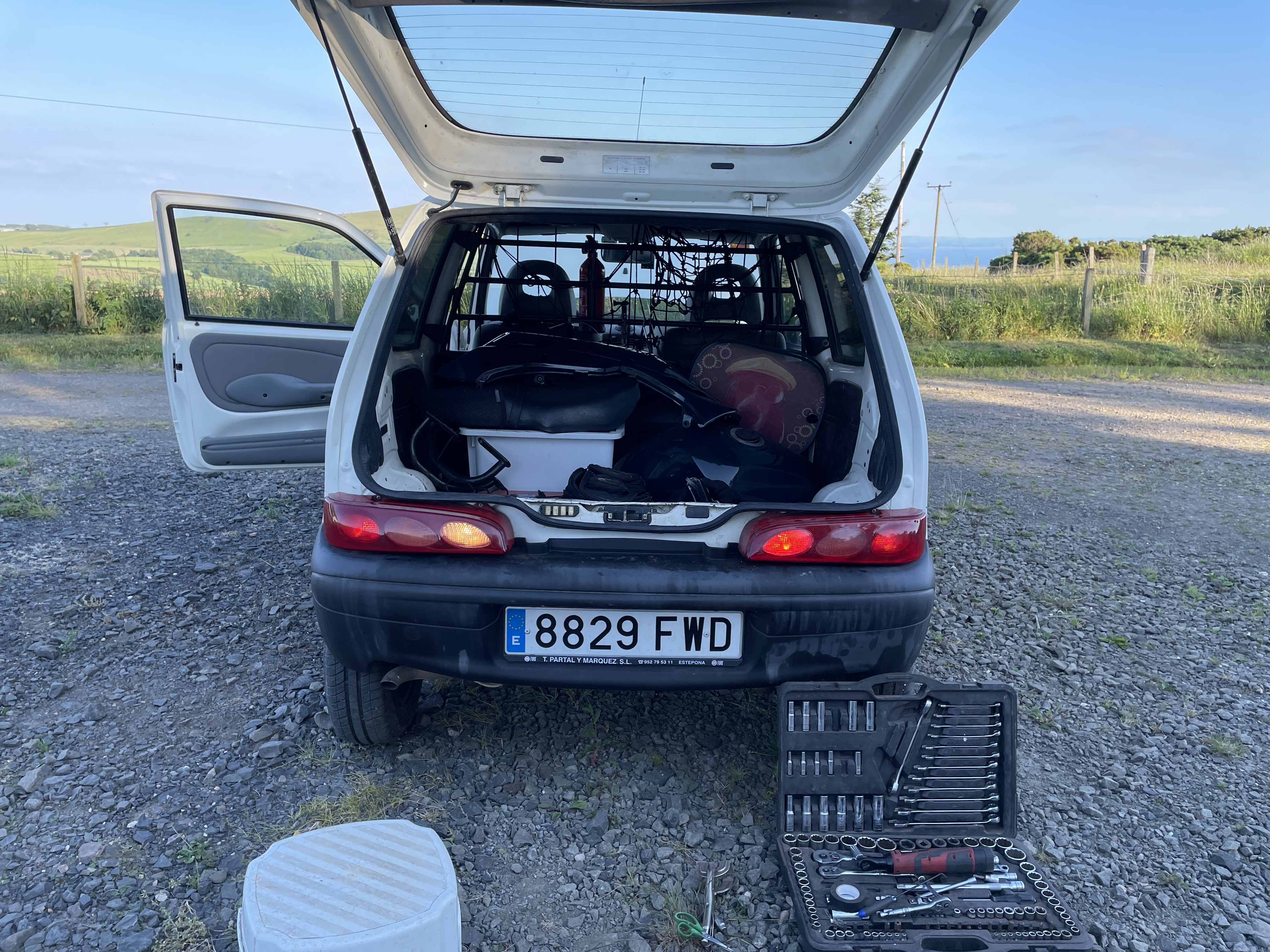

Did a ‘thing’.. still getting things sorted on Noddy. Headlights are swapped out for U.K. ones, now rear light clusters have been fitted. Reversing lights on Spanish car was blue and white wire and the fog grey and white. Both run next to each other and after slicing through the tape located and confirmed each with a test light. Which I didn’t really need to do but ‘dumb and dumber’ can creep up on anyone. Anyhoo, cut both wires next to each other, and after prepping them reconnected using those soldered heat connectors. Result is fog is now working where it should and so is the reversing light..no need for fitting an aftermarket fog lamp. Almost looks British..

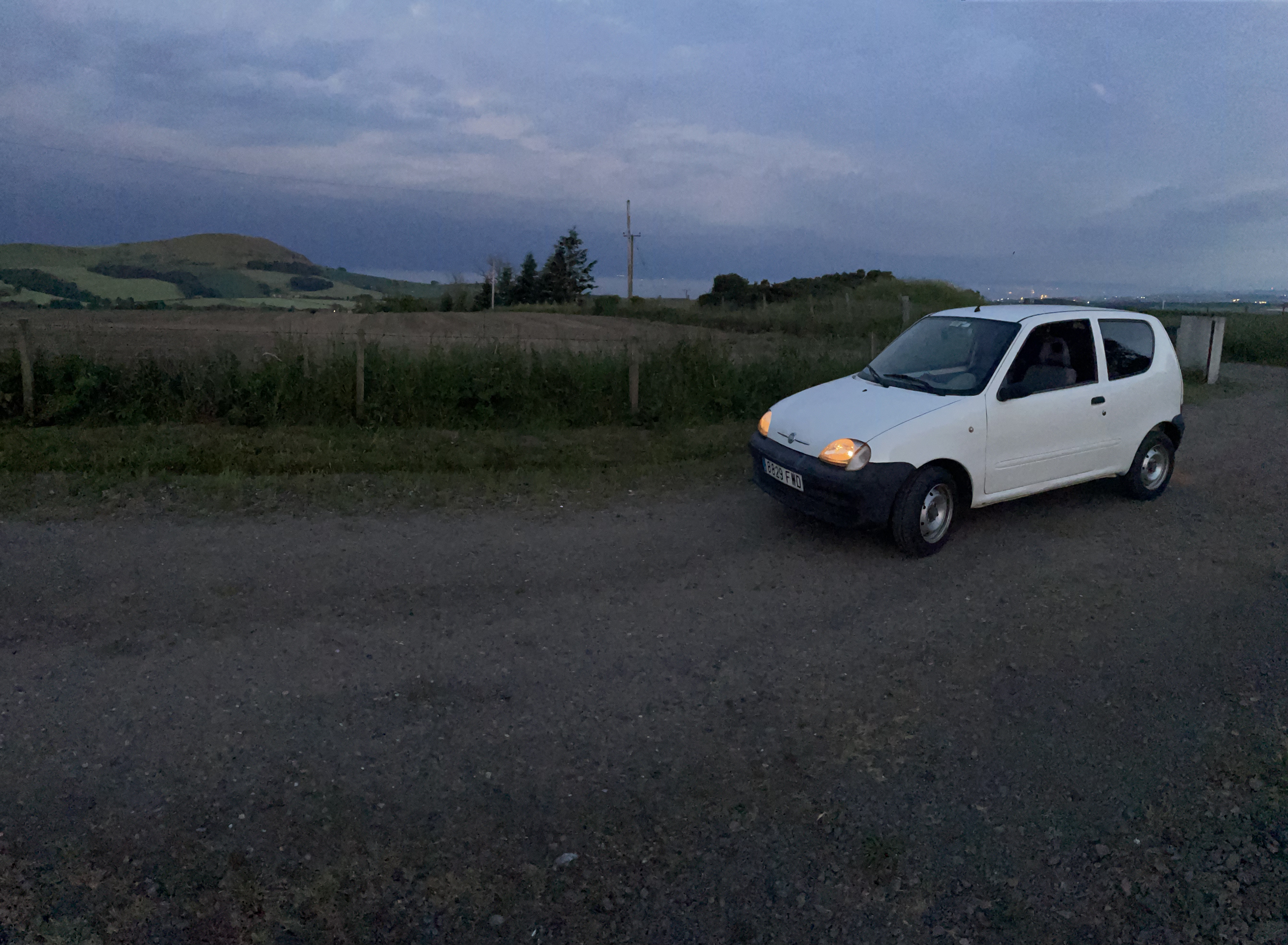

Nice to see a tidy Seicento, they're pretty rare here now. I have fond memories of three and a half years with mine.
Is that the view from your home, or do you often travel to the countryside to do maintenance?
It’s where I live with my sister (long story) we rent it together. Has a decent garage now full of my junk and daughters Freelander getting fixed!
