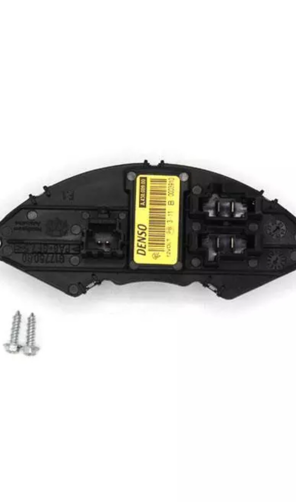

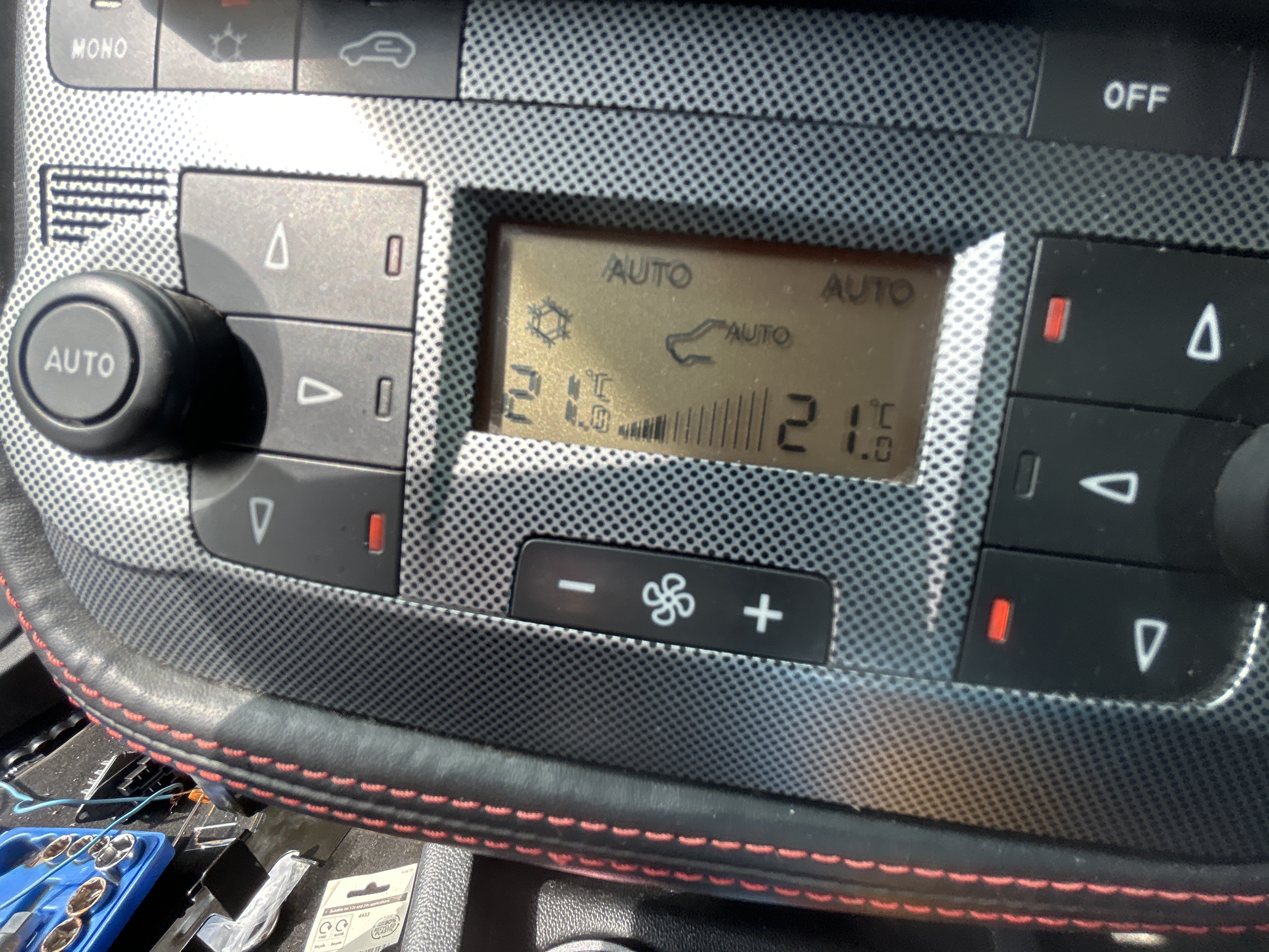

Exactly there is no air flow whatsoever and as I say there is no 12v to black pin on the heater blower denso unit,
The screen itself powers and shows fan speeds that are adjustable, but no fan powers

The black cable is a short cable that plugs into the I’m guessing condenser unit (big white tank )
Mines dual auto climate control mate doesn’t use a resistor like this, mines a pwm, I’m pretty sure the earth in the body control module might be no good, I get 12v from control panel for auto air conditioning, relays get power, it just isn’t receiving a ground signal to activate the fans itself I’ll get some photos in a little while

This seems a little odd, this does not get 12v while my air con is on

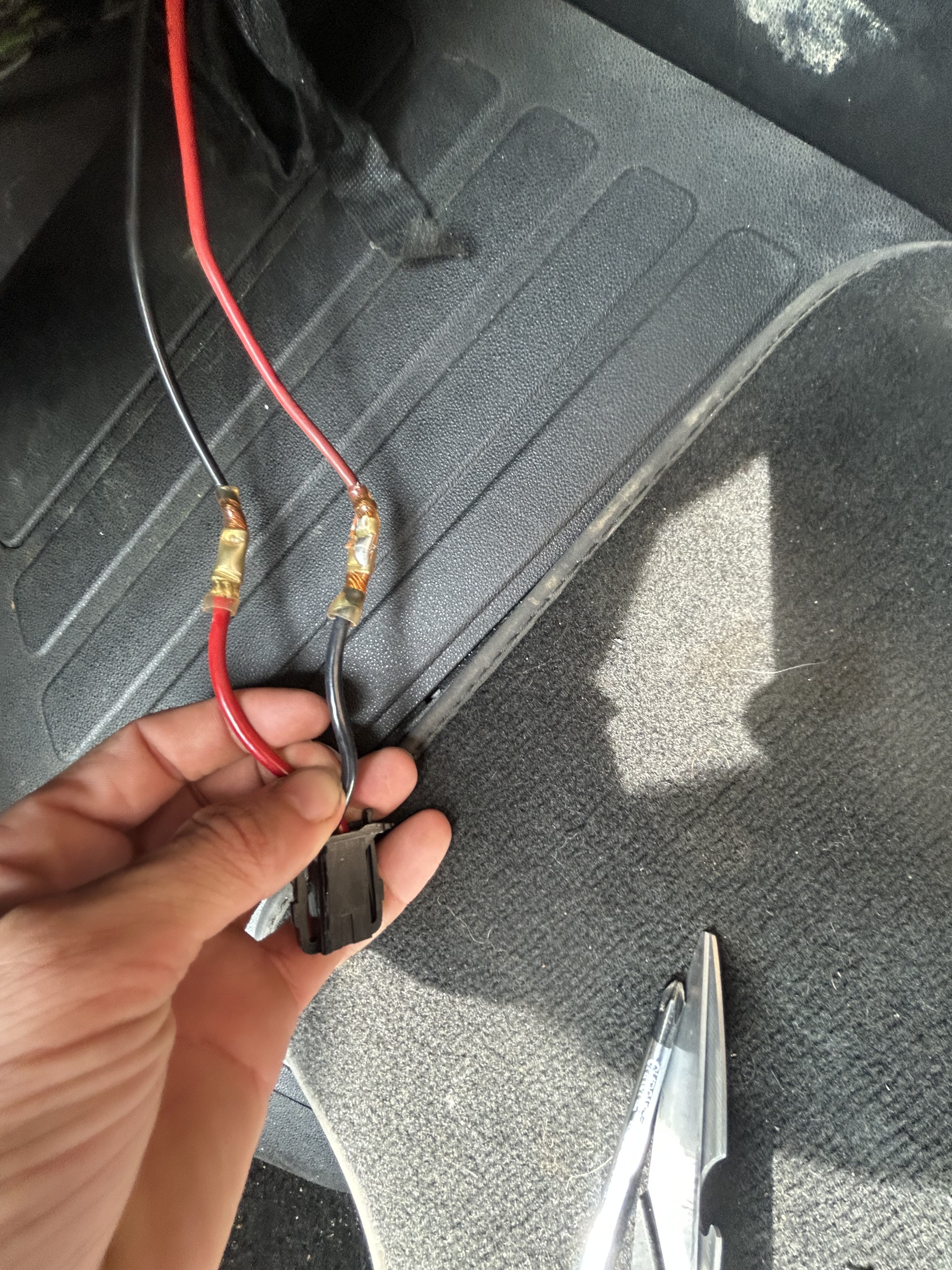

Relay is sending power to white plug so I’m assuming it’s between this panel and the bcm and most probably to do with the wires being switched around so will wanna check fuses first then continuity on the wires to and from

Another update so I’m guessing without noticing these crossed wires I’ve plugged them into a new pwm module and probably destroyed it before I could even try and use it, I’ll order another new one next week and see what the outcome is I’ll try og part number for it I believe A.430.008.00 is correct

I’ve finished the work after tracing wires that red and black definitely needed switching back to normal and there was a heavily corroded earth that I’ve since repaired now all is okay and working as it should, thanks for the replies in this been a great help with future resources for me
