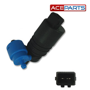

This is what it looks like. There is a spout that fits into the bottom of the reservoir and 2 outlet pipes from the blue part which I assume is the valve.
At the moment I have put the old pump vback in, and it's working as normal (still leaking of course though). Could they have sold me the wrong pump?

was going to post this on AOC but you have already done that, there was a suggestion the wires may be wired in the motor the wrong way around, any chance of checking that or have you already?
Update.
I got a new pump sent out.
I have discovered that the new pumps, when connected to a 12v battery, +ve to +ve, -ve to -ve, the water quirts out of the opposite nozzle than when you make the same connections with the original pump. So , yes, they are wired up differently. It can't put the plug in the other way as it won't fit the other way.
I suppose the moral of this story is buy original parts, not generic parts. :(
"Just an idea" can you not open the plug & move the wires around or cut wires & reconnect to pump using new spade connectors.
