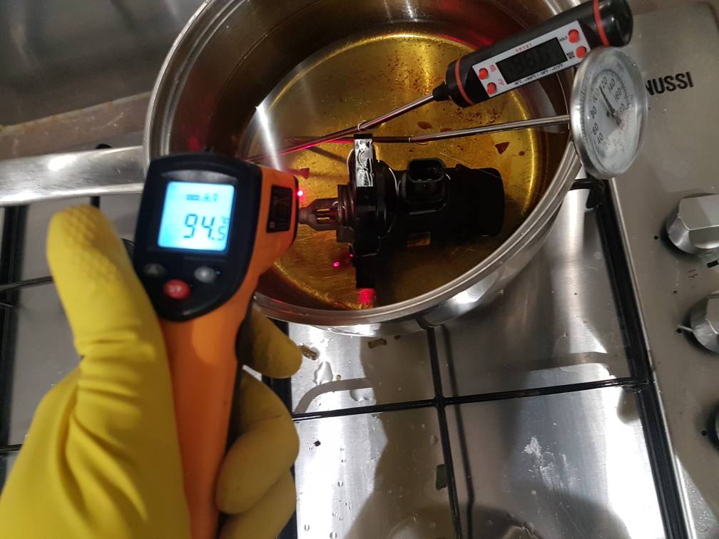

Hey guys.
So in the end I went with the oil and pan method. Was interesting to see a thermostat working. The oil pan method allowed me to control thinks more. I.e turn up or lower the heat. These thermostats have a high (or higher compared to the norm) seems that this thermostat opens up at around 103 - 109 degrees. Where as my punto one that I changed a few months is around 80ish (can't exactly remember). Again just meant as a bit of curiosity and interest. Thanks again. 20191108_194016.jpeg
