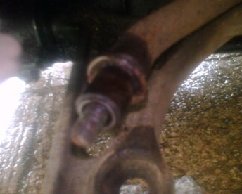

2. The anti roll link bush was shot to bits where it engages with the anti roll bar, giving the damn annoying clunk over every little bump. Ordered a new link from Fiat as the bush is an integral part of the new one. Removed the old one same time as the driveshaft, but it appears to have left behind a part on the anti roll bar, which don't seem to want to come off. Now I'm hoping that it's not part of the bar and is just being stubborn as the new link won't go on with it there. Hard to describe, so I shoved the mobile in there and took a pic - apologies for the quality, but it was raining, dusk and the camera's useless :)

that part on the roll bar is the inner sleeve and the rubber. It is just being stubborn, you might need to use an angle grinder to thin the sleeve until it cracks and comes off the stud underneath.

Thanks for that - I was thinking of resorting to the angle grinder after the bearing puller failed to remove it.
