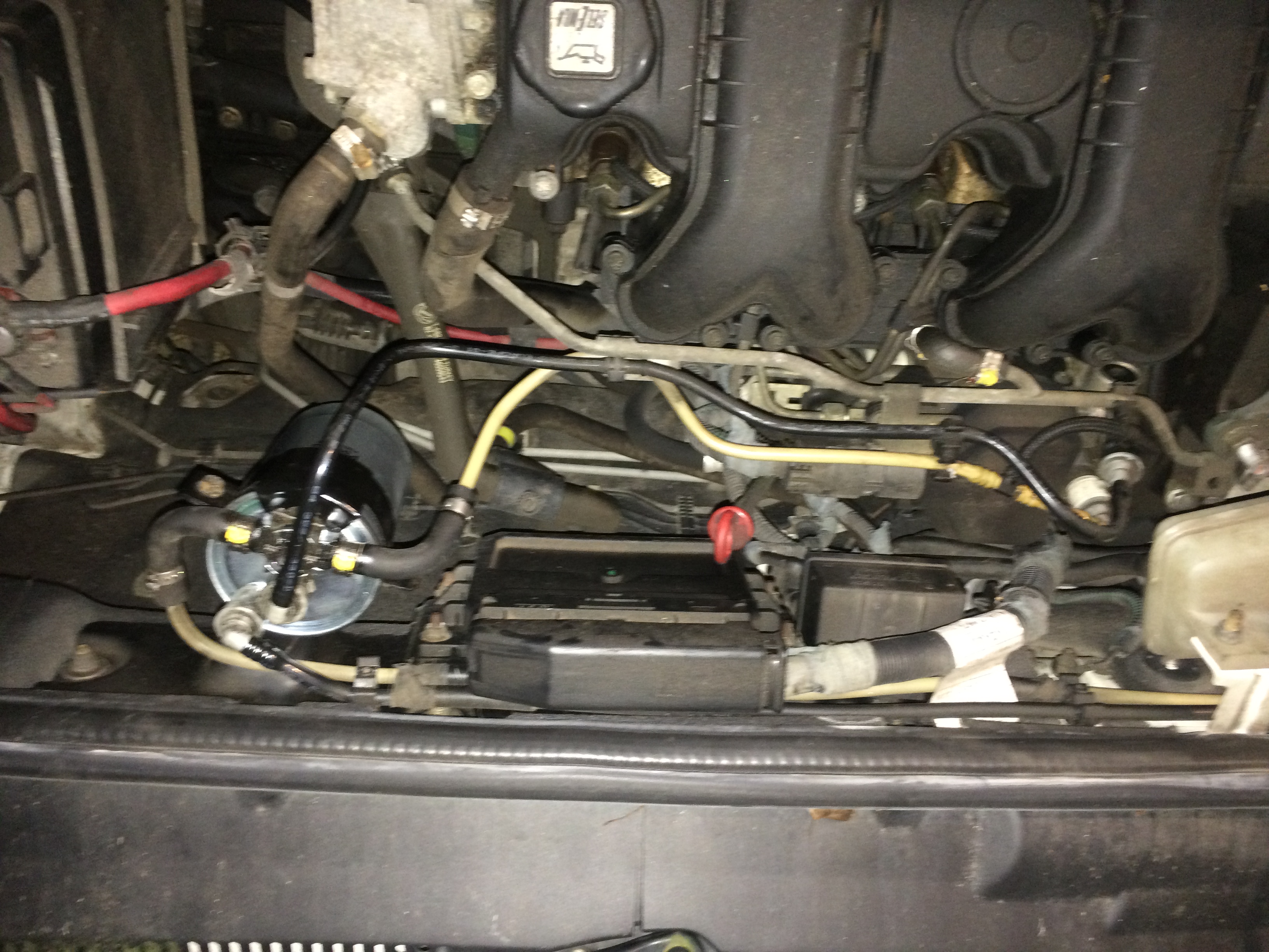

I've read from you guys that the Lucas fuel filter struggles pulling the fuel through the filter from the tank, but then get kinda lost on which pipes or valves I should be changing out.
Also, I was told by a local parts supplier that I would need to go direct to Fiat for replacement pipes, I.e, the ones running between pump and filter etc, does that sound correct?
I'm gonna try and attach a photo so hopefully someone will be able to tell me which pipe/part does what.

one of the best things is to try and get figures for the pressures at injection.
