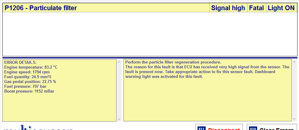

Error code 1206 DPF problem.
It's been going on for years and years. I've replaced loads of sensors, checked the pipes, spent hours looking at MultiEcuScan, done the forced regen when told to etc etc.
Clogging gets to about 103%. Engine failure light. Do the forced regen (clogging down to about 90%) and off on my travels.....until it gets to about 103% again.

Replaced the differential pressure sensor, used MES graph function to monitor its activity...and it looks ok.
There's something up and I'm thinking the DPF could be passed the end of its life (for whatever reason). No visible cracks so I suspect a build up of ash in it insides. Clean or replace? If it is chocked up then a replacement would probably the easiest option. Unless there is something else that's gone wrong.

Hi,
If it gets to 105% then the regen goes ahead as it should. Sometimes it gets there but sometimes it gets to between 90% and 103% only and throws up "engine failure" on the dash and goes into limp mode. Plus MES shows P1206 error, which returns after a mile or two if it is cleared without a forced regen. Forced regen is then necessary.
The differential pressure was a suspect at one time, giving spurious outputs, but that has been replaced without any effect on this problem.
