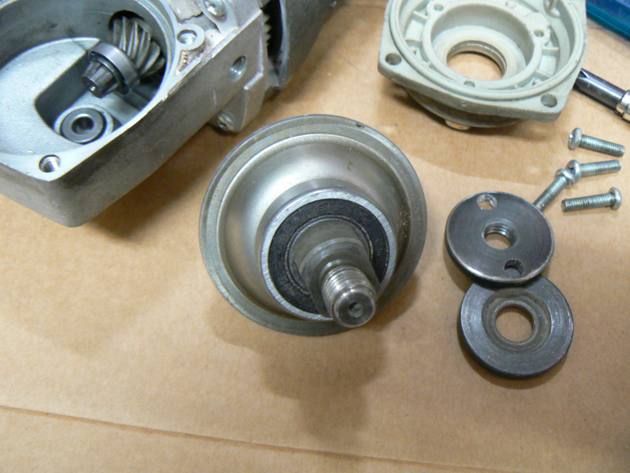

I've owned my Black and Decker "Professional" angle grinder for many years, maybe 30? It's only a tiddler which takes 100 mil diameter discs but it's been very reliable and, although used intermittently, it's done a power of work over the years. I've never done any maintenance on it and as I don't have need of it just now I thought I'd dismantle it's gearbox and repack it with grease - I've seen lots of people doing this on you tube videos and I've repacked all the electric drill gearboxes I've owned (except my newest one which is still very, well, new).

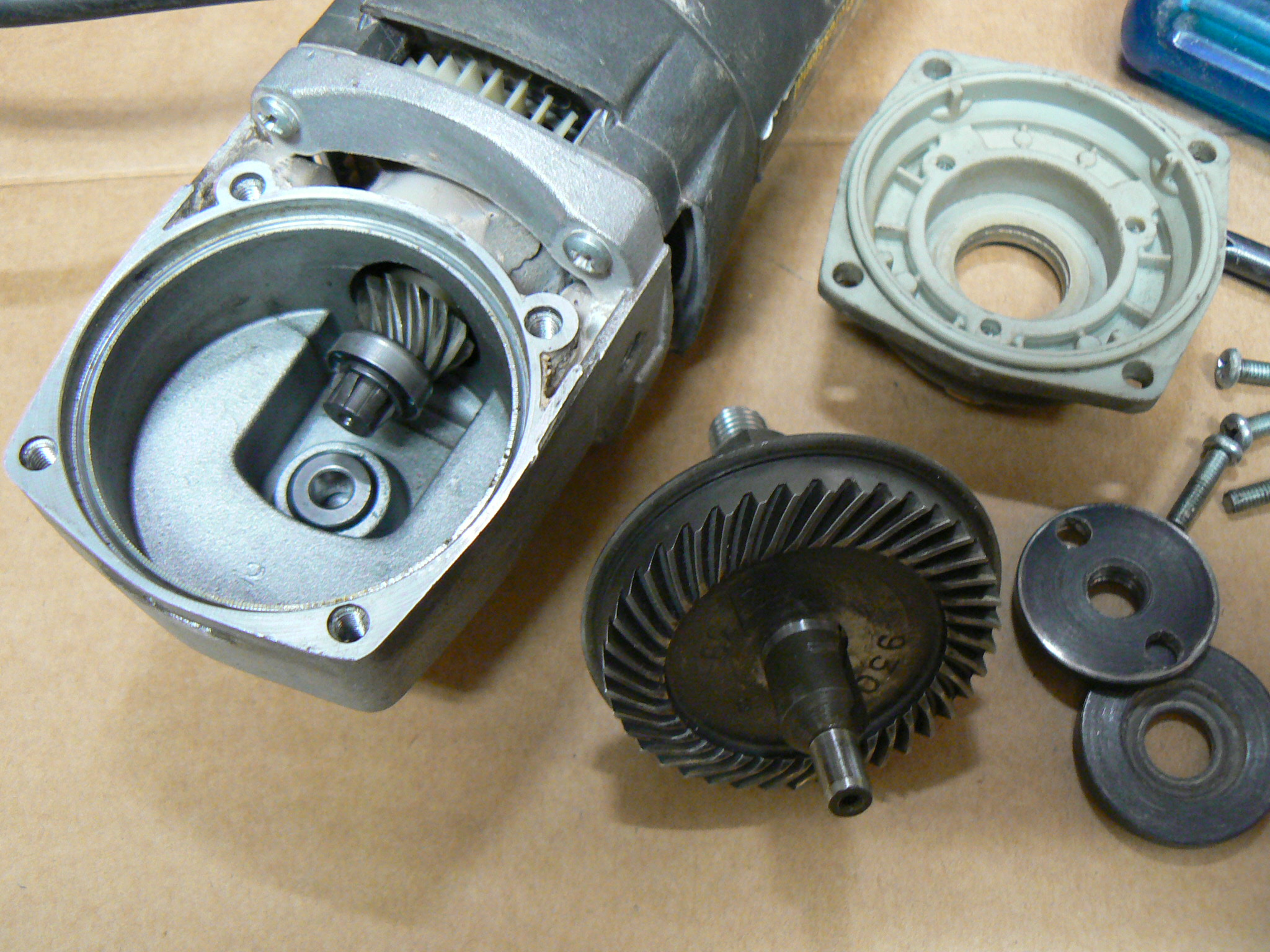

So, having removed the screws and prized the casing apart, Imagine my surprise when I saw this:
Not even a wee dod of grease to be seen anywhere! The inside of the casing is spotless! This is obviously how it was assembled and, looking at the condition of the gear teeth, which are immaculate, this is how it's meant to be. Once I'd overcome my surprise I started looking more closely. The teeth show no sign of bluing (which might indicate overheating) and I can tell you it's done some serious grinding in it's time. Also the armature pinion bearing and the much larger bearing on the bevel wheel are both of the sealed type so don't rely on exterior grease and spin very nicely with no signs of roughness:
The bearing in the bottom of the end casing which supports the other end of the bevel gear is of the oilite bush type so I'm not going to slaister any grease in here or on the gear teeth but I am a little tempted to apply a few drops of oil to the bush - question is what oil? I think I'll google oilite bearings for advice.
And now my question to you folks is has anyone had their angle grinder in pieces and if so was it's gearbox "dry" like mine? Having regreased electric drill gearboxes - I've never stripped one and found it not to contain grease - I'm finding this very strange.
I was going to suggest that maybe it was covered with a light oil when new and the oil has dried out/burned off over the years leaving it looking like there was nothing there.
Generally a grinder is something you can buy so cheap (~£10 sometimes) and I use so infrequently, I never bother to do maintenance and would just bin it if it failed but they don’t really fail.
Even hard grinding you don’t put a lot of pressure on internal parts, they have a single gear, the crown wheel being large spreads the heat/pressure from any high torque situations so as a consequence they don’t need much looking after.
I’d probably give it another light oil and leave it at that.
Normally if they do go wrong it’s the motor burning out. I’d suggest the motor would burn out long before you could exert enough force to damage the gear box on a properly made machine
Thanks Andy. Yes, all that sounds very plausible. When I was a motor vehicle trainer the workshop next to mine trained welders. They had many grinders, one for each booth plus spares. I don't think any maintenance was ever performed and they just chucked them when they failed.
I'm going to give that bush literally a couple of drops of the lawnmower "lifeblood" and I like your idea of a very light application of oil to the gears - just enough to "dampen" them as, obviously, 90%, or more, of it's going to get flung off.

I used to have a Black & Decker professional angle grinder with plug in power cord for easier disc changes. It said the gearbox had sintered gears which did not need lubricant though I did add some driveshaft moly grease. Eventually the switch failed. I replaced it with a Makita which destroyed itself when the spindle lock fell into the gears. I now have grinders from Aldi and a Lidl - both doing the job for very little cost.
The bevel gear in an angle grinder runs at very high speed. Locally applied grease or oil would just be thown off.

Point taken. I think literally a couple of drops down the sintered bush and I might just dampen the gear teeth with oil, more to ward off corrosion than anything else?

Well that's it all back together again with precisely 2 drops of SAE 30 on the sintered bush and 3 drops spread round the inner rim of the bevel gear teeth so it will throw out the first time it's spun up and so coat the teeth.
Gave it a quick "wizz" and, unsurprisingly, it sounds exactly the same as it did before, - dry gears running without lube, as someone said above - which is how it's always sounded

Yes, others have opened older Black & Decker grinders and found the gearbox dry, it’s by design. The sealed bearings and self lubricating Oilite bush don’t need grease, and the gears run fine without it. At most a drop of light machine oil on the bush is all that’s needed.
I notice my last post was May 2021 just after I decided not to pack it with grease and just very sparingly lube it with of my lawnmower SAE30 oil. Thought you might all like to know that, although it's not seen a lot of use, I used it to cut through some very worn farm gate hinges the other day for a friend - pretty thick metal - and it performed well. Now he's just got to weld the new hinges in place. They're the sort of "pin and eye" type if that means anything to you.
