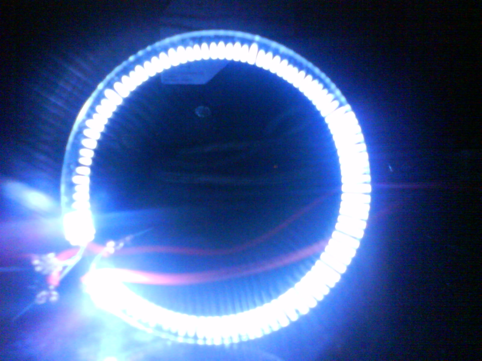

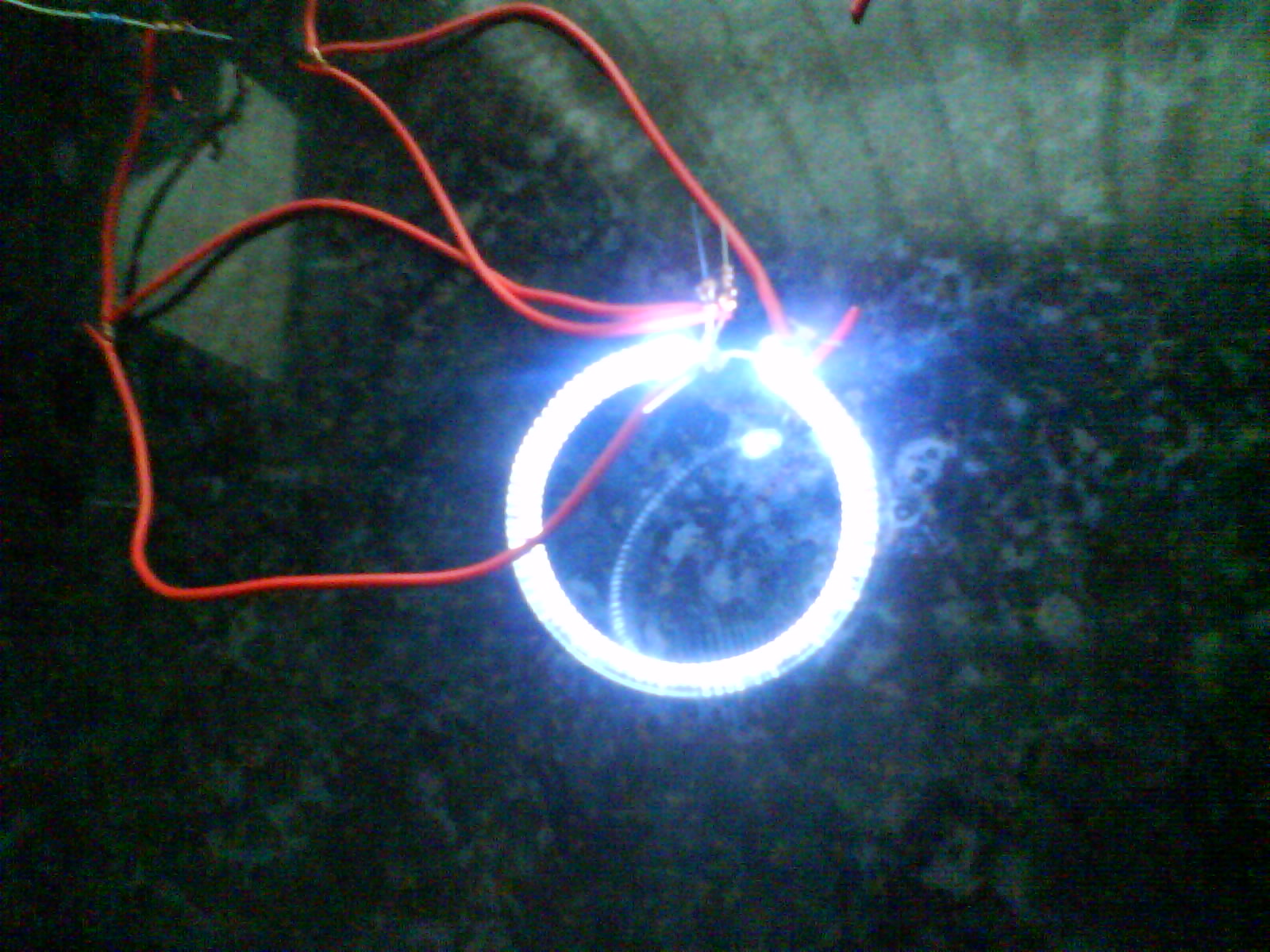

Well done that looks fab

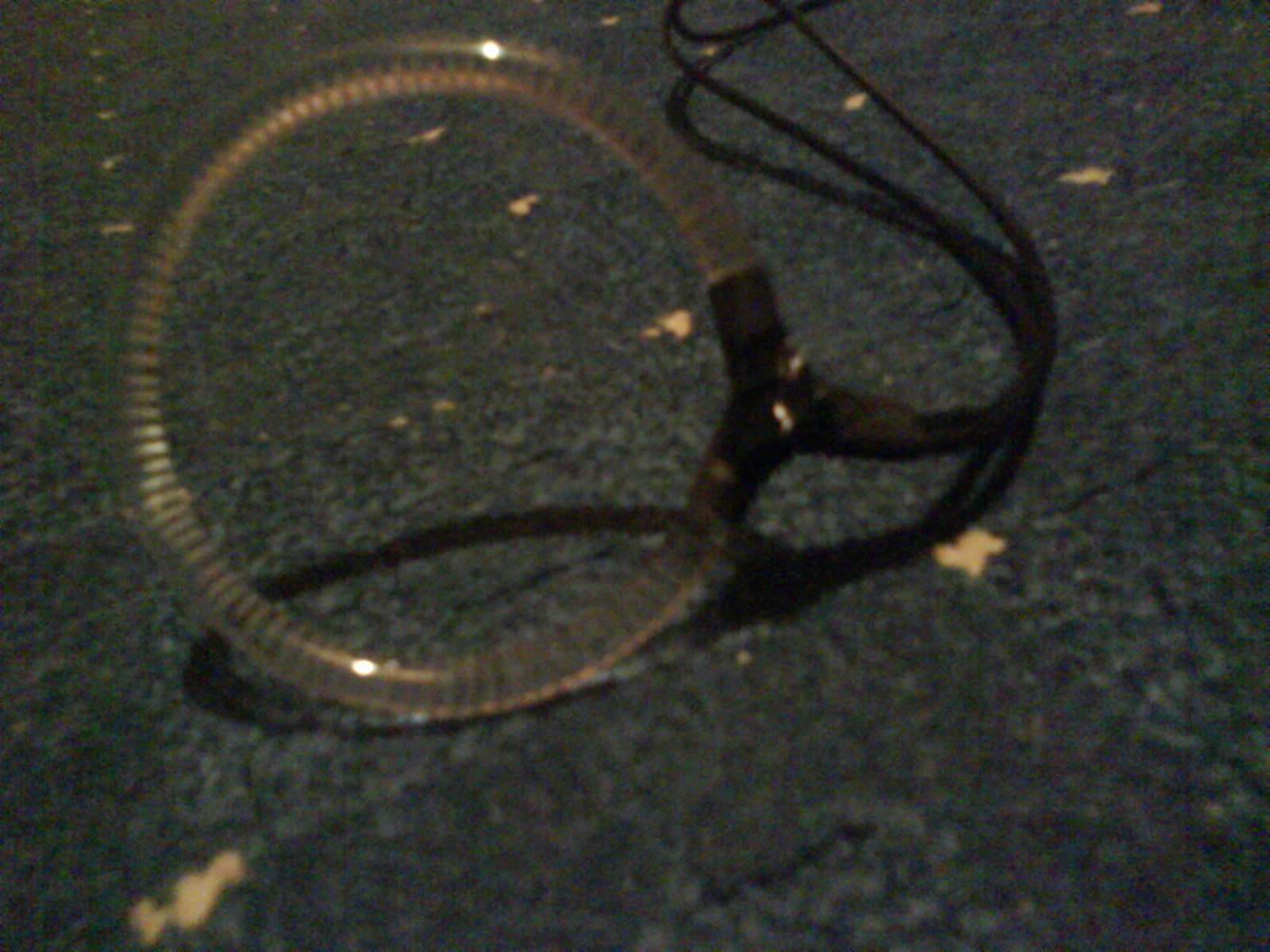

A needle file for the grooves might be easier and do them before the rod is bent to shape.
Maybe putting a flat on the back face with a medium file. The rough edge should catch the light.
Possibly just roughing up the whole surface with wet & dry would be enough.
oo nice ideas all though making grooves before could make it more difficult to bend to shape they could snap ect but who knows
yh i tryed to slit first then bend but it just snapped and all the slit seemed to melt and turn into thicker buldges of plastic doesnt work well that way,
i also tryed the wet and dry on back effect but i just didnt like the way it looked too dull for my likin, the slits looks much better imo but i bet the wet and dry technique would reflect more light, i might back my rings with reflective tape or just summat white to reflect the light outwards because right now the most you can see is just light on the slits.
i mean like too much light escaoin thru the back of the ring needs to be reflected to the front

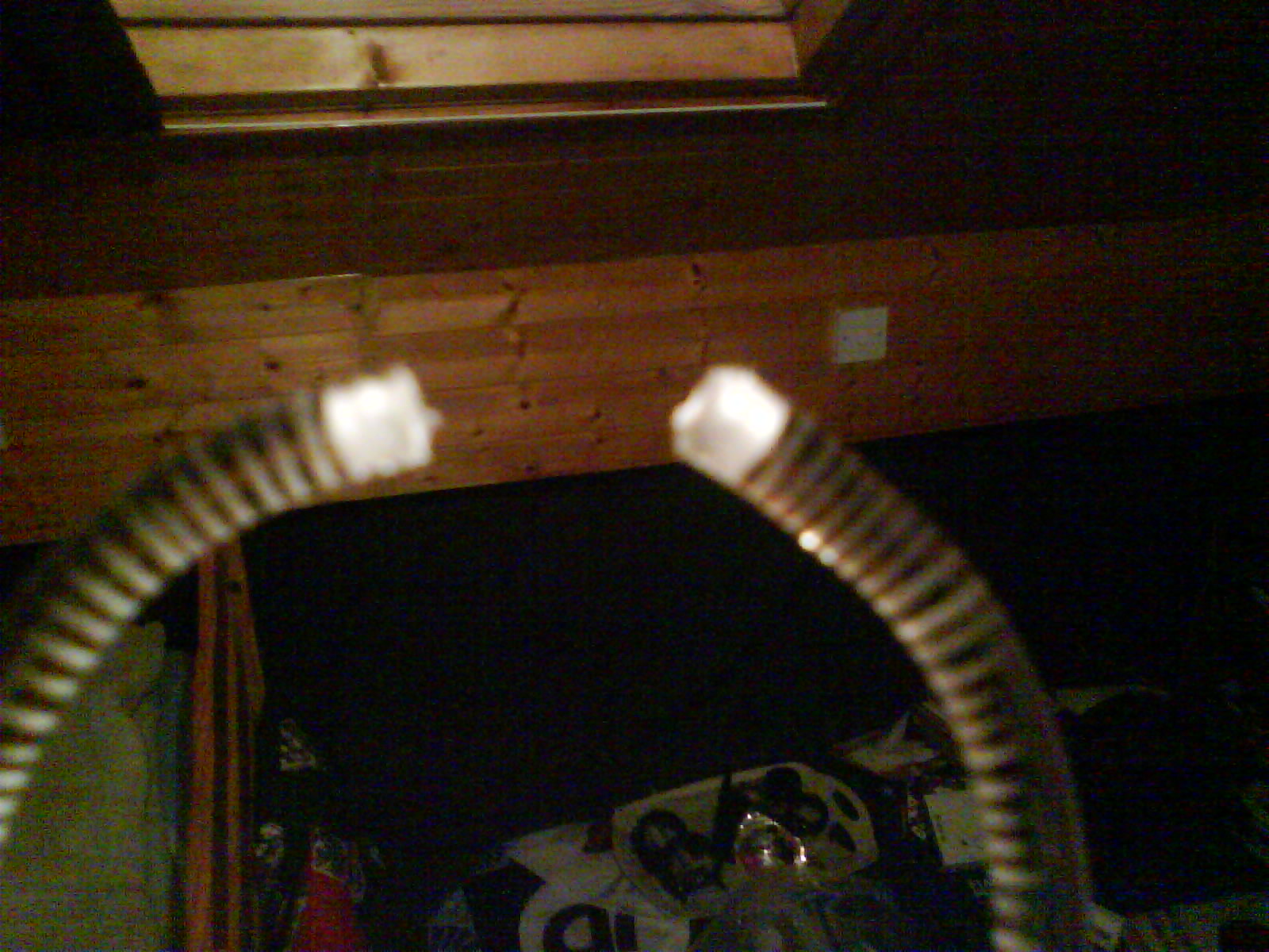

Look i wired then properly even soldered the led legs and wires together, used heat shrink on both ends of the ring and the top of the wire, had to use some insulating tape just in the centre part because thats wer the wires meet and couldnt get heat shrink there
