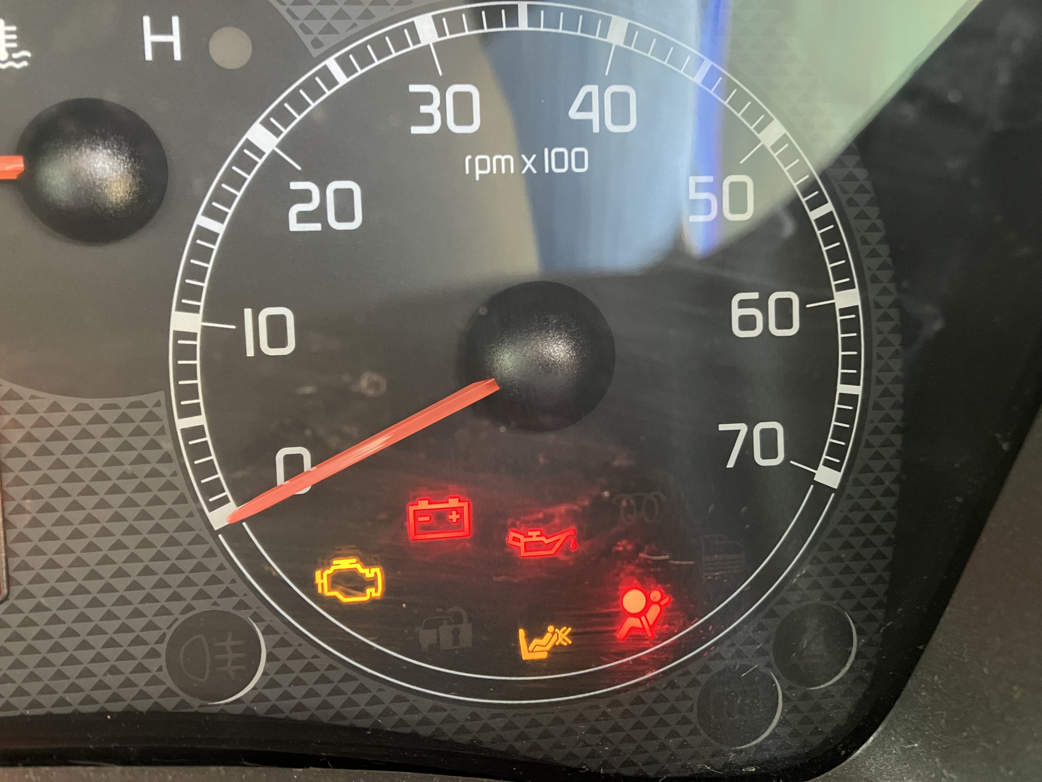

What dash lights are on at ignition on
What dash lights are on at cranking
Only bothered about the right-hand side of the dash
Engine check, oil, immo, battery mainly

I do have a multimeter, dash lights are as follows:
This is on ignition:
This is what would be on while cranking:

Ignition on is fine
But during cranking
Engine, battery, oil, should stay on and the rev counter should move up, oil will eventually go out with prolonged cranking, engine should stay lit until it's fired

Cranking should show 300rpm on the rev counter it's not
The clock not reset
The lights in post 6 while cranking are the same as if there is a faulty earth
Which will cause the alternator not to charge
