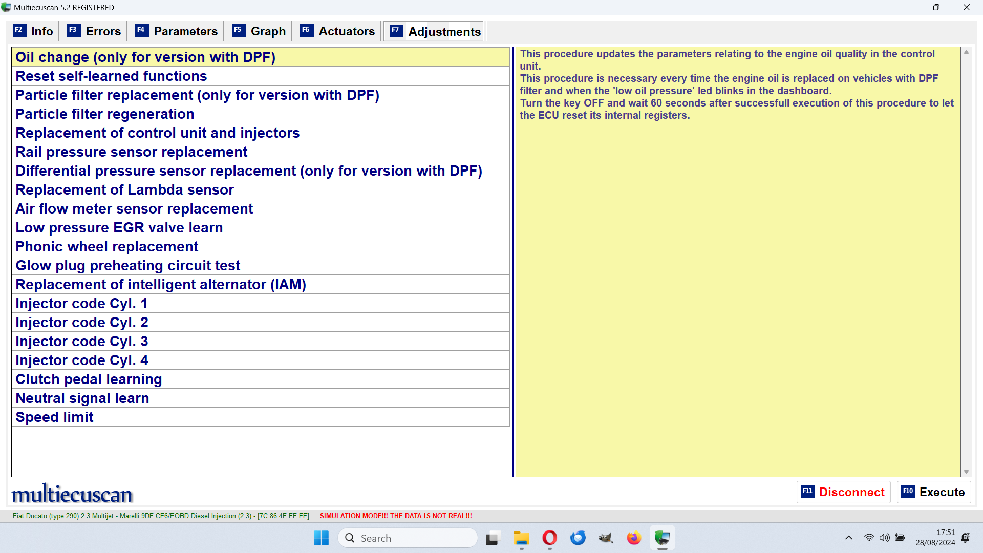

The free version of MES doesnt do much other than the important one shows you have connection. Simulation does not do anything with actual data it is intended to show you what is possible and lead you through the process eg look at F7 adjustments No cheap hand held scanner will allow reset of this function of any of the other functions writing to the ECM eg any new sensors.
Yes. Ive seen this in simulation.
Is this simulation a list of things that can actually be done on my vehicle. Or just a general example of what might be done, depending on the vehicle I have?
I had it pluged in when looking, after the scan.
Thanks
Ah. Now that does help thanks
I did a scan first, after that it went to the ducato 2.2 automatically when doing simulation. So I can go on simulation now and see exactly what is enabled yes.
