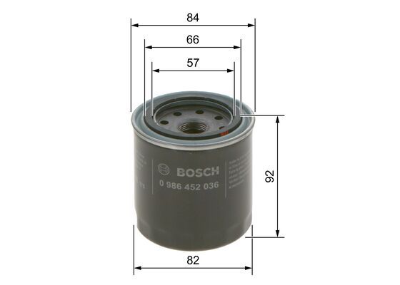

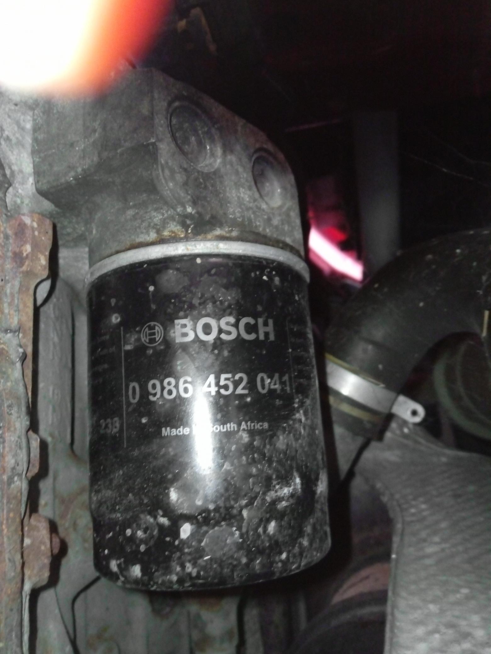

have a 2016 Panda 1.2 petrol and with over 90k miles on it, and little to be gained by a 'stamp,' am prepared to do my own oil and filter change. The one fitted to the car is a Bosch P2041 (0986 452 041). It may be an error, but I ordered one from Halfords :rolleyes: . The P2041 is out of stock but an alternative was suggested, still Bosch, P2036 (0986 452 036) and only £3.49. :)
I now have it (the P2036) and it is slightly shorter the P2041 (not really an issue) but is a good 10 - 12 mm wider. It looks to me like it will obviously overlap the plate it is screwed onto! I appreciate the rubber seal will still likely seal but the overlap would bug me. Does anybody have experience with alternatives, maybe FRAM or Mann? The Bosch P2041 seems a bit pricey to me elsewhere for what it is.
How can traders (not just Halfords, several others) suggest a ready alternative that is a different diameter?
DO NOT fit the larger diameter one, it will leak, empty your sump in seconds, and likely destroy your engine. There's a reason Bosch use two different part numbers.
There was a change, from the large to the smaller one, before mine was made (2006). I guess it was probably when other changes were made to the engine, smaller diameter plugs, round oil cap, cam sensor, no timing marks, etc.
As said above, the Mann one is a good alternative. (Euro Car Parts 501660069)

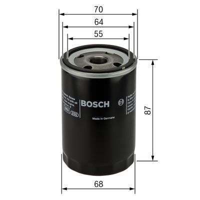

But the seals are not the same size.

Not only that but the threaded part is deaper within the filter. No I would not trust it, easy enough to get the correct type.

I took it back to Halfords and got a refund in the end. I will buy one that IS the same size to be safe.
I showed them the photo at the till, although they accept return of purchased items within 30 days even if unused anyway. The one I wanted wasn't in stock but I can get one elsewhere, no rush, I intend to do it after the MoT in July. :)
