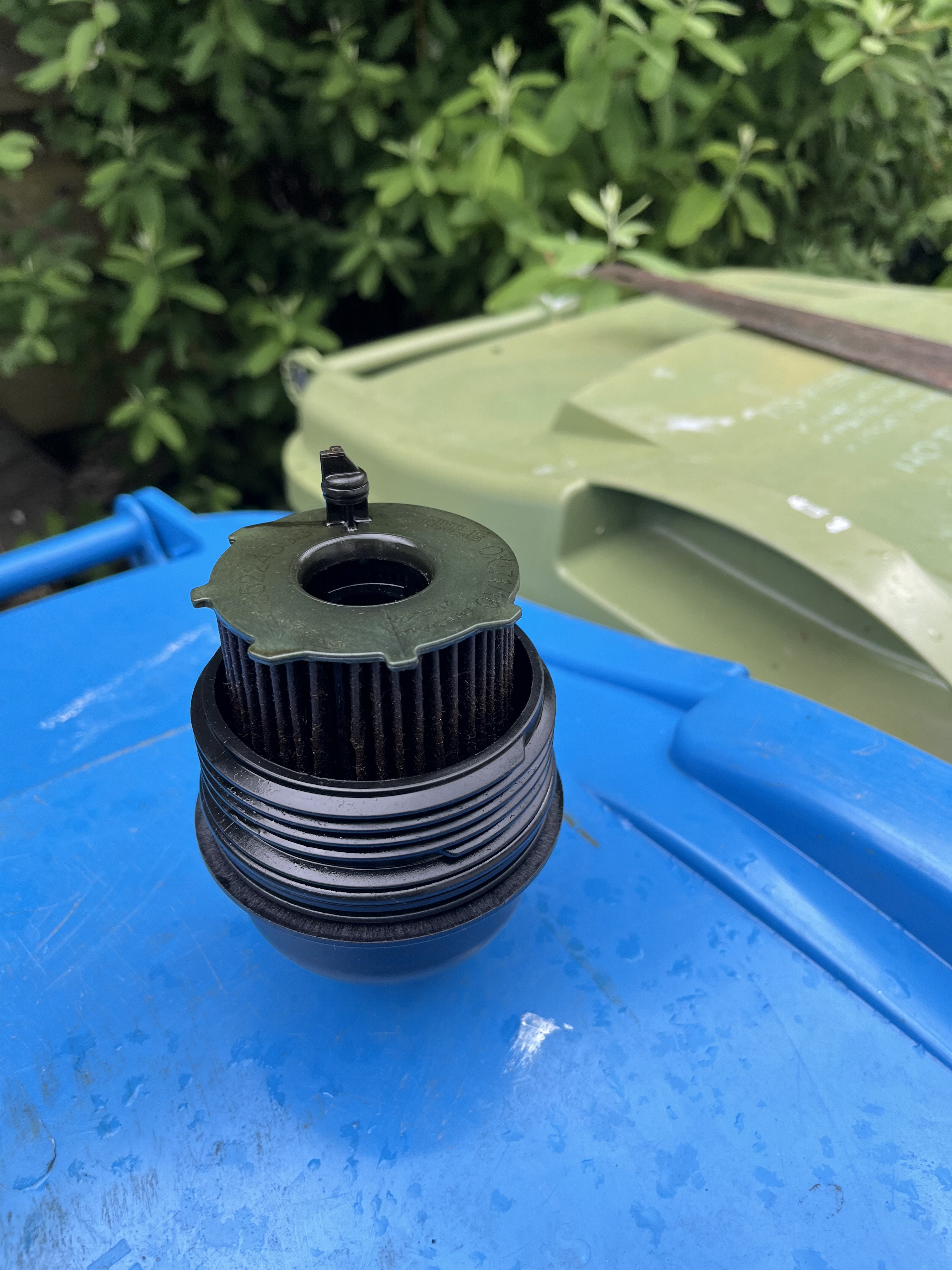

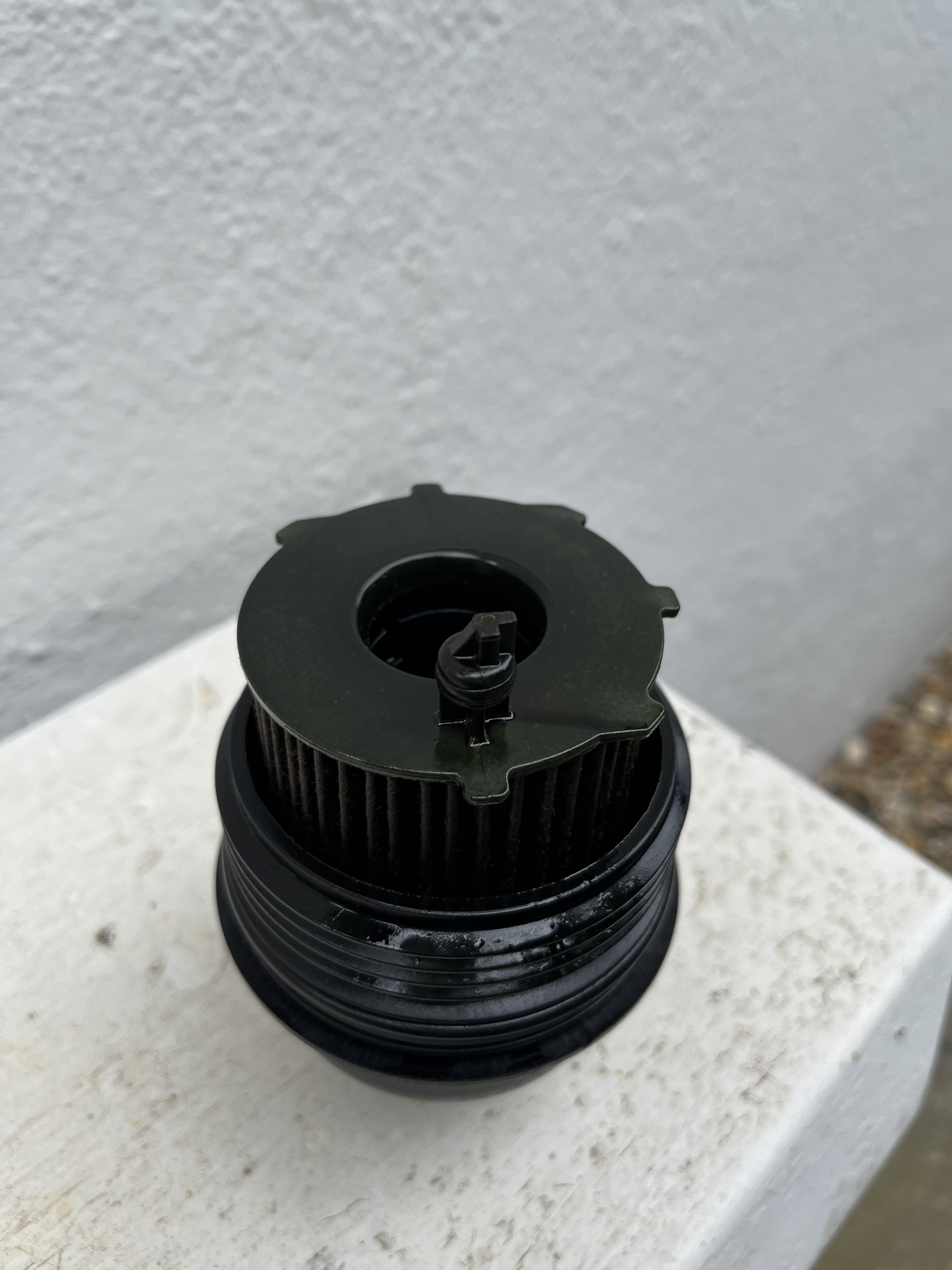

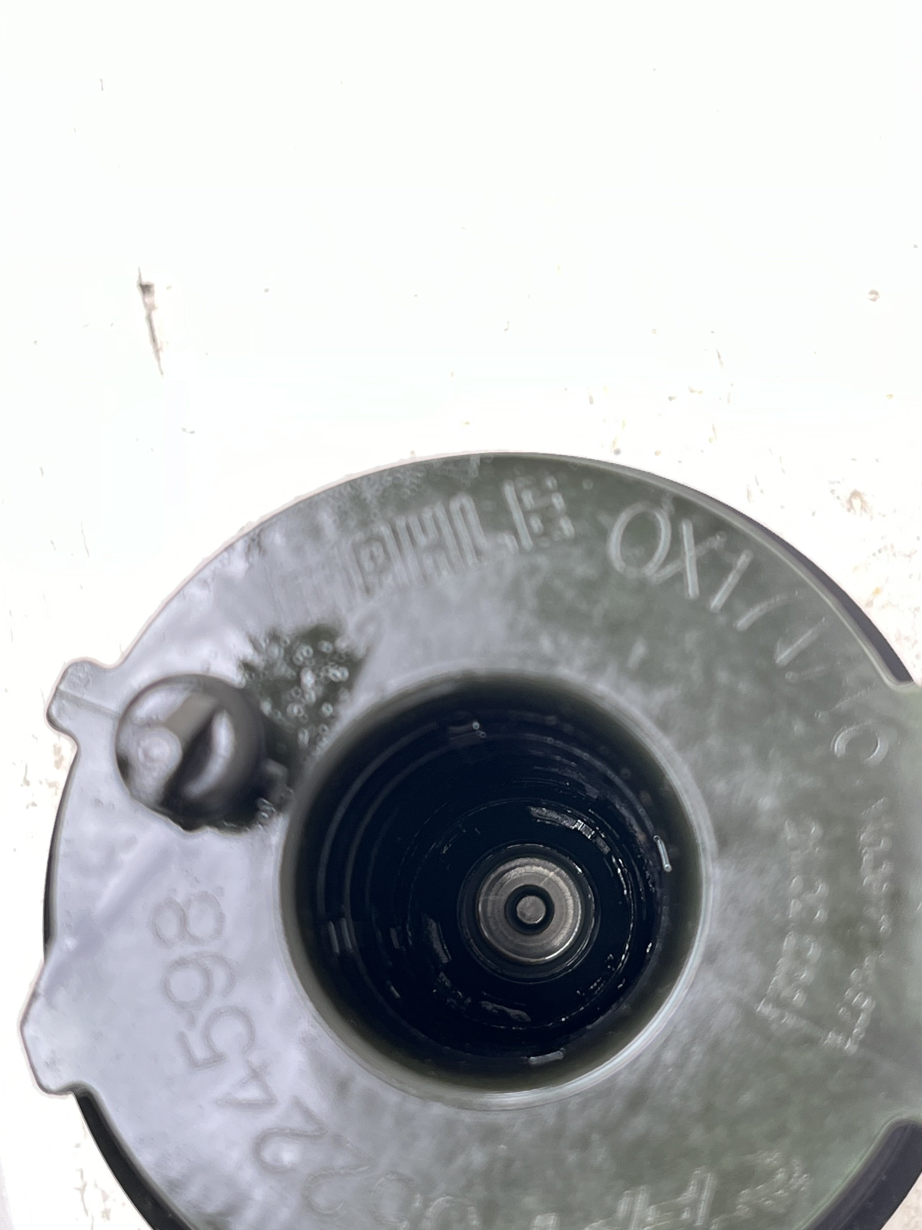

Hi guy's I'm currently doing an oil service on my 2023 Panda TA 9.0 4X4 can someone tell me how to remove the oil filter from the oil canister it appears to be clipped into the canister but I can't see how to remove it?
Obviously I don't want to force it but there seems to be a spring clip thing at the bottom of the filter inside the canister.

If it's the one I think it is try turning the filter as you pull,
the filliter clips over a plastic disc with a segment cut out
but they can be a real pain and the plastic goes brittle
due to heat.

I can't believe how difficult it is to get that filter out of the canister cap, I mean you have to line up the lug on the filter with the hole in the canister in the engine and the easiest way to do that IMO is to fit the filter first then the cap last.

I bought a new oil filter cover guys, there's virtually no stock anywhere but I managed to find one on Fiat Workshop for £37 plus delivery which is only about £3.50 so I bought a sump plug and another oil filter so that I've always have a spare cover and filter.
Here's the part numbers below if anyone needs them in future.
COVER. Oil filter housing screw on cover (includes sealing ring). 55224599
SUMP plug. • Includes sump washer M12x1,25x13mm. 55184773
OIL FILTER. Paper element (with sealing ring). 55224598

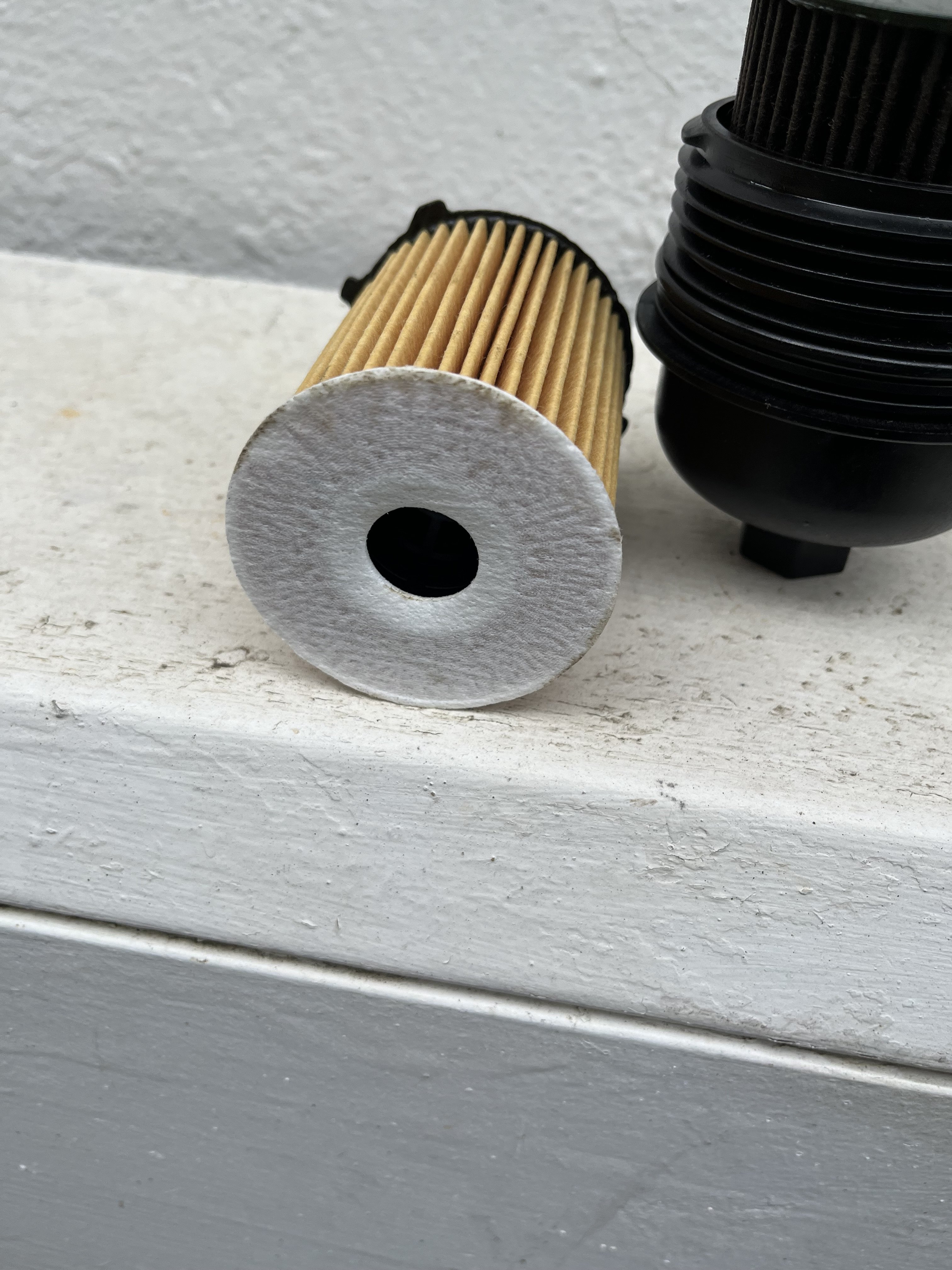

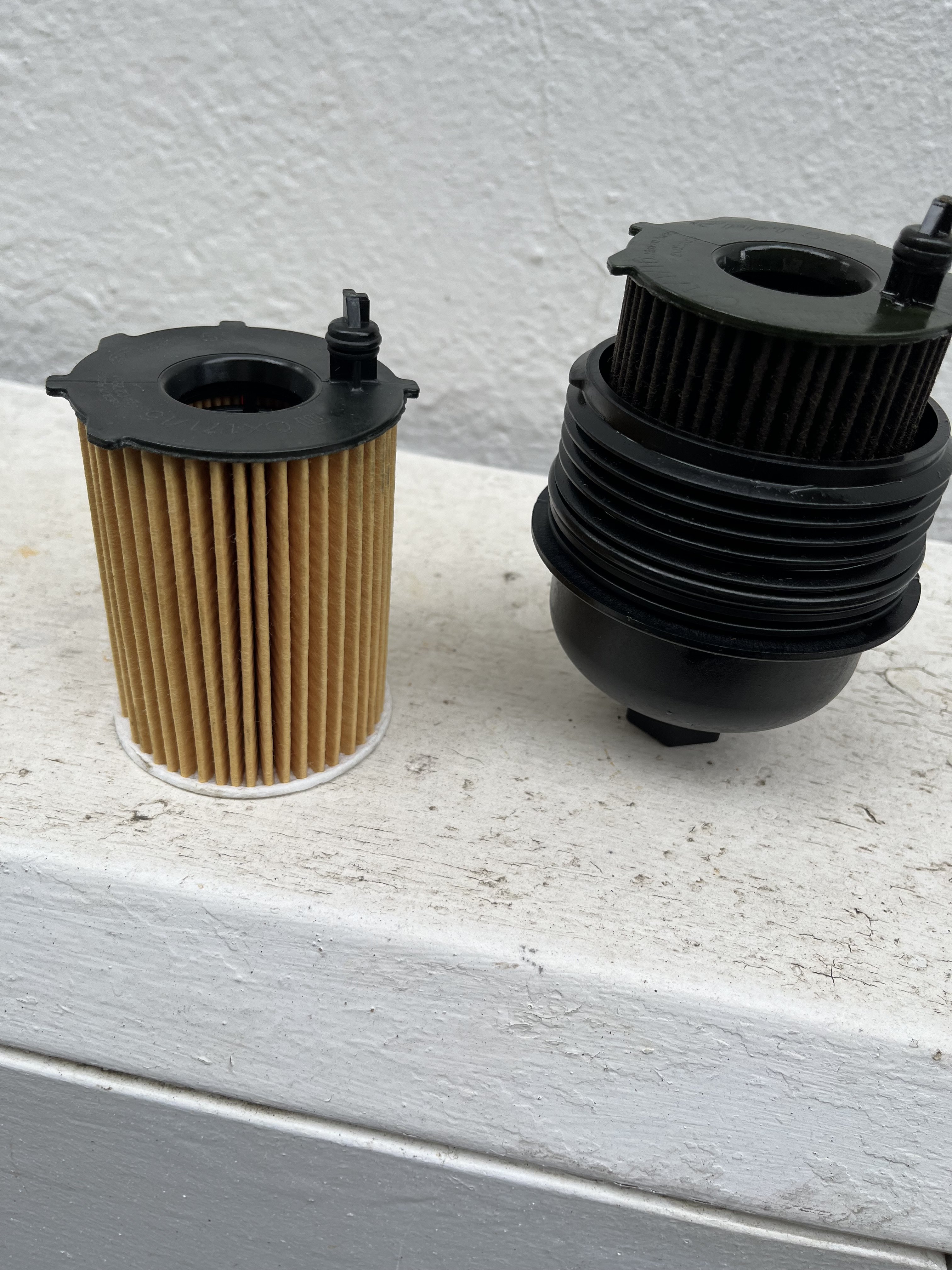

Hi guys, just a quick update to this, the cartridge cover and filter arrived today so I swapped them over took only about five minutes.
I didn't have to drain the engine oil as the filter cartridge canister is quite high up above the sump.
The good news is to remove the oil filter from the cartridge cover just a pull it out :ROFLMAO: it does take a wee bit of effort but it comes out easily enough so a good old tug:ROFLMAO: on the filter and hold the cover at the same time.
