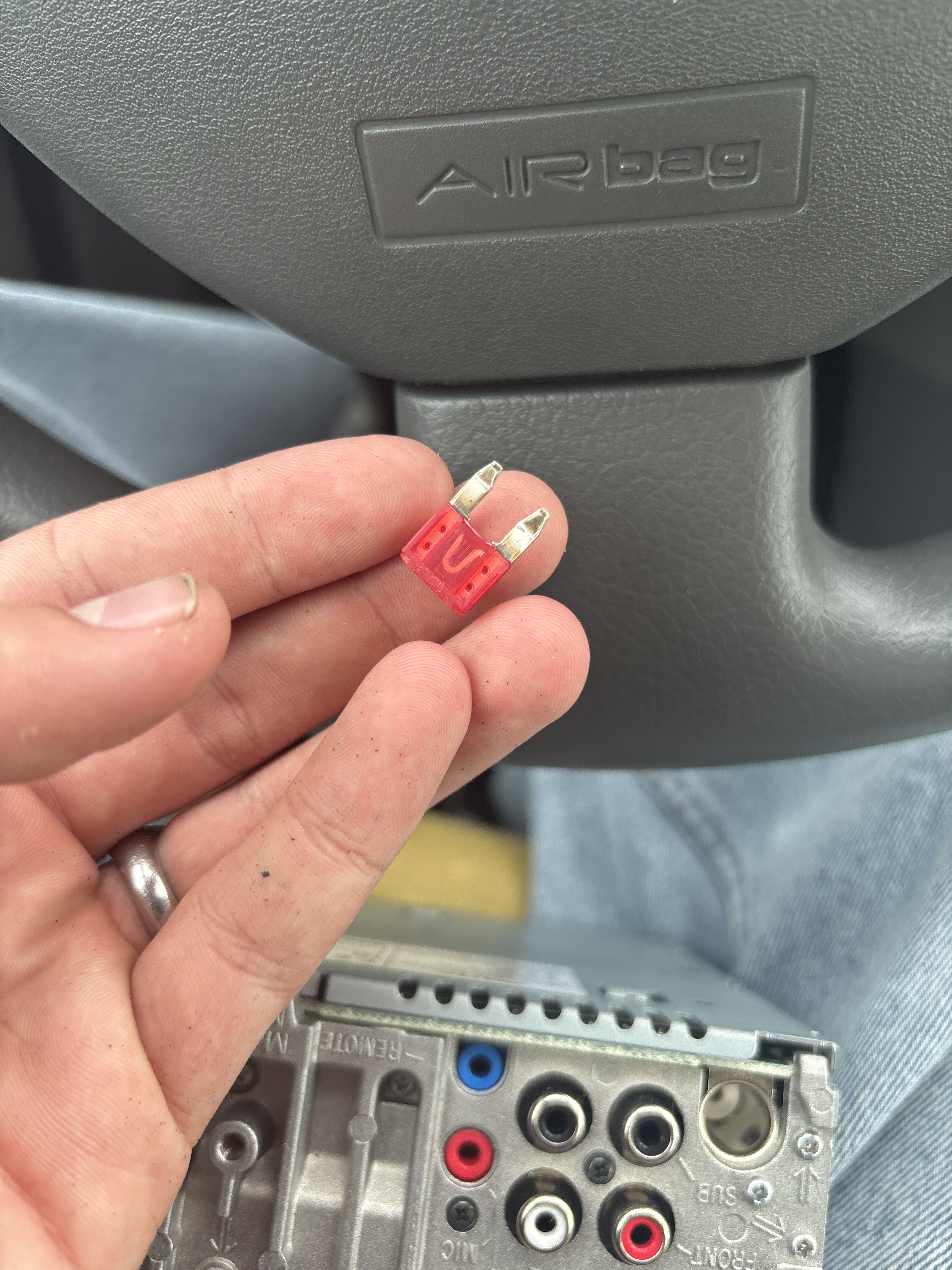

I've bought an Alpine 200 UTE-200BT used, but it will not turn on when I plug it in. The adapter came with it and was previously connected to a Peugeot 206 or 207, but I don't if the previous owner, has done anything to it, so it doesn't work in my Panda. I haven't replaced a radio before, and tried everything on Google, but couldn't find something that works. I think it may have something to do, with the pins on the adapter and Panda being different, but I can't get them out and try them out. I've included pictures of everything and a wiring diagram of the original and alpine radio, so that should help, if anyone has an idea of how to fix it, let me know :D
