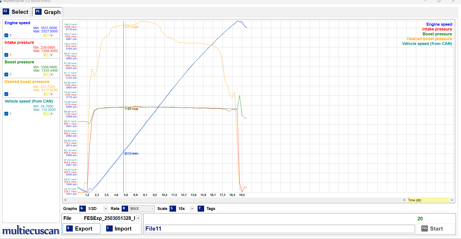

I have use MES to find the issue but i am not a car mechanic and need your help. Please take a look at this graph because to me the pressure compared to desire pressure is off quite a bit.
Thank you in advance.

Added a new graph, maybe it helps

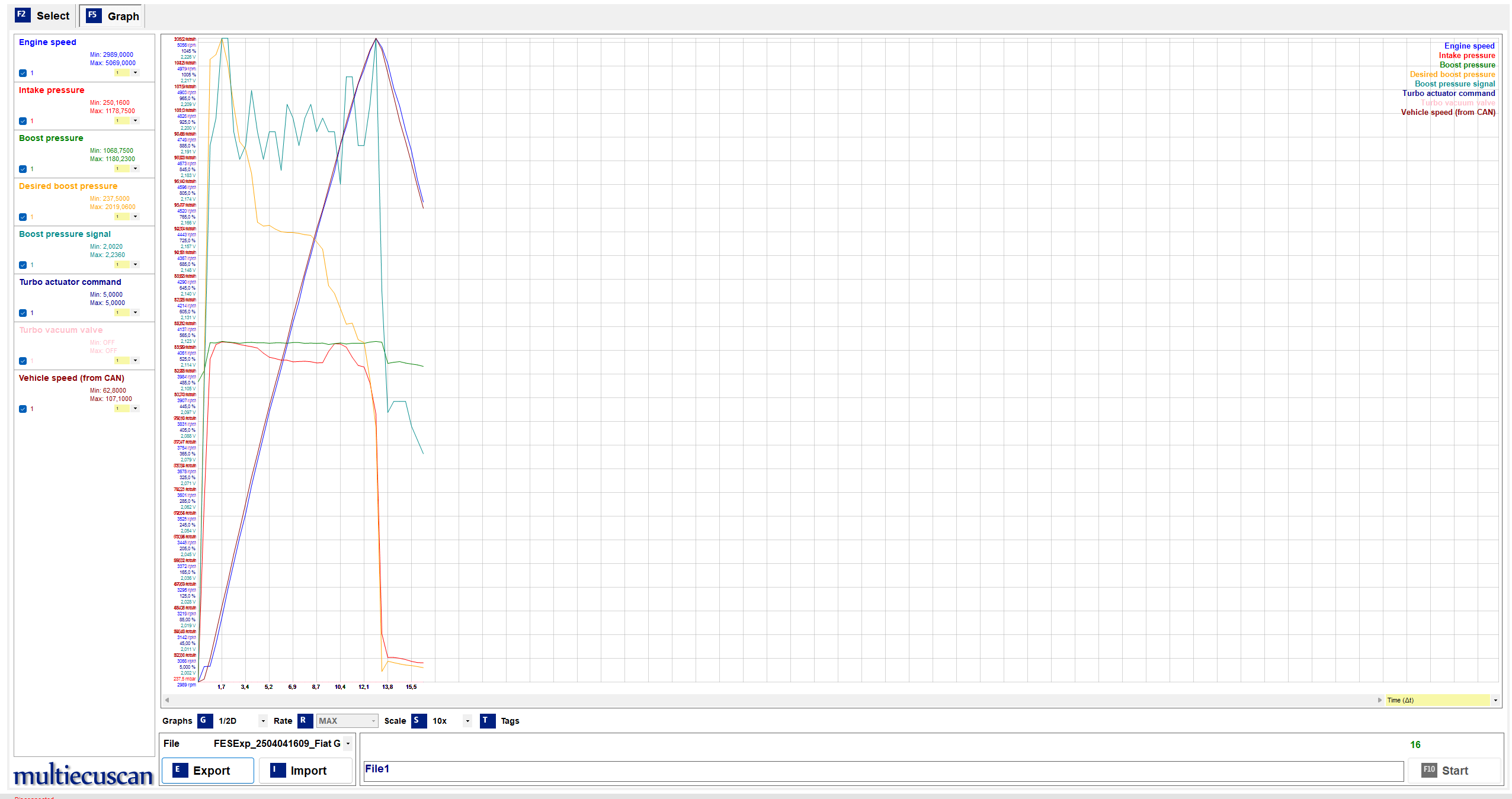

New test run MES. On my boost meter it reaches 0.50 bar maximum.

Apparently i uploaded an older graph, here i have some new graphs. I notice that ''vacuum turbo valve'' stays off, that normal?
I've tried to test the solenoid actuator from within MES but i keep getting error 13, so that does not work.

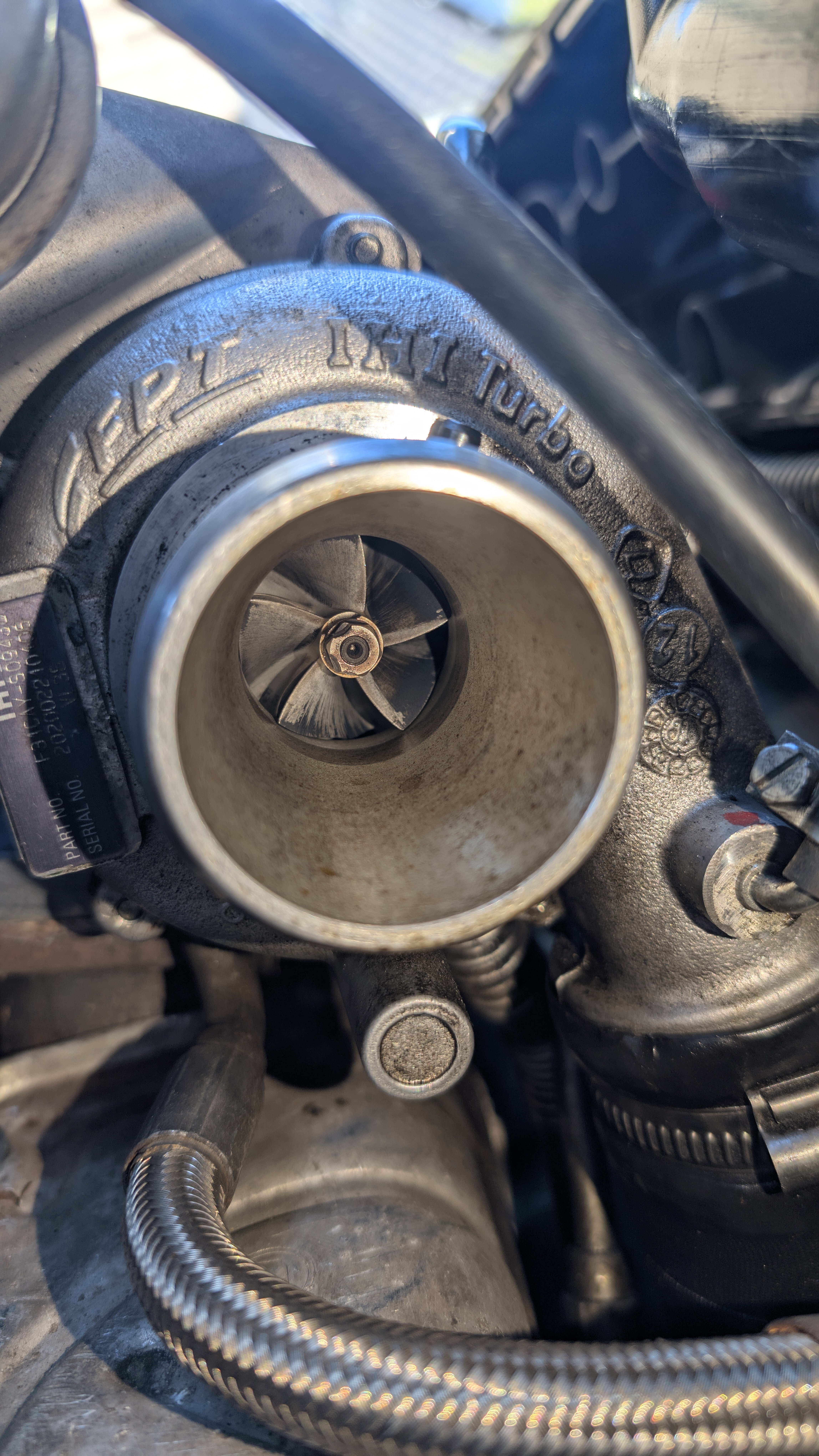

It looks to me that the turbo is spinning properly.
Regarding the bypass valve, om not sure where and how to check that. Also notice that the intake pipe is little oily in the inside. It looks like that coming from the oil segregator as there is oil on the nozzle when i remove the hose.
