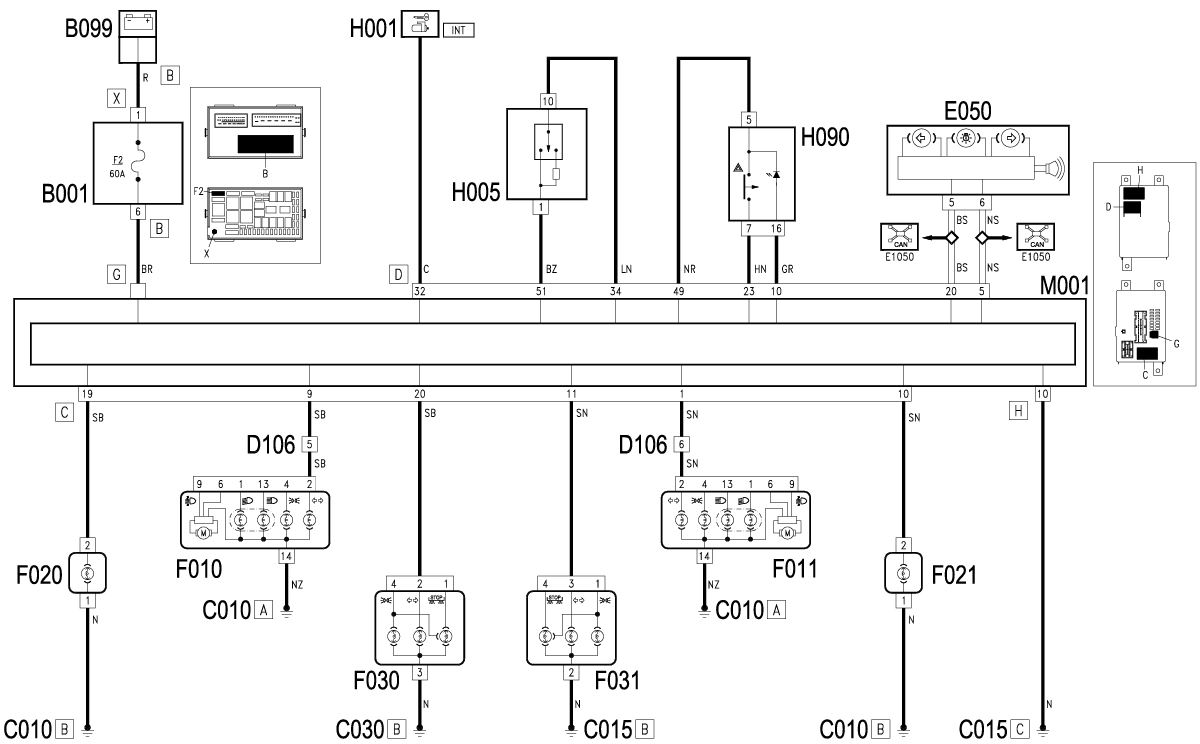

I really doubt the hazard swith (H090) is involved: it is a simple NO swith with and internal LED, nor is the stalk one (H005).
Since all RHS indicators are on different outputs and none is working, I'd suspect the body computer (M001) to be the culprit …

Edit: can't upload picture for the moment (site issue ??), will post the drawing when feature is back ...
Thanks Ben, here's the drawing …
BRs, Bernie
