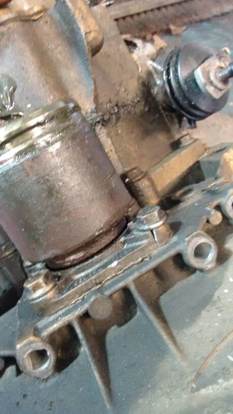

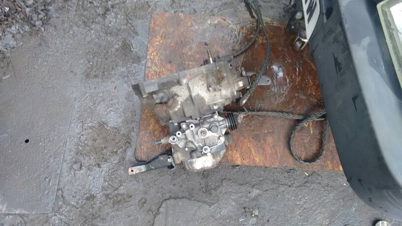

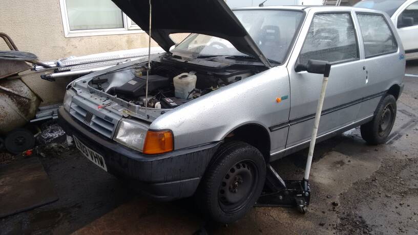

Just replaced the existing Seicento box (Synchro was shot) that I had installed in my Uno with a donor I got from an MK2 Punto. After removing the additional bits I didn't need the box mated nicely to the 1.2 block. After installing the driveshafts I noticed play inside the cups. I also discovered the existing cv boots wouldn't fit. I've since discovered the cups are larger on the Punto that they are on the Seicento.
Hopefully I'll be able to swap them around easily enough.
