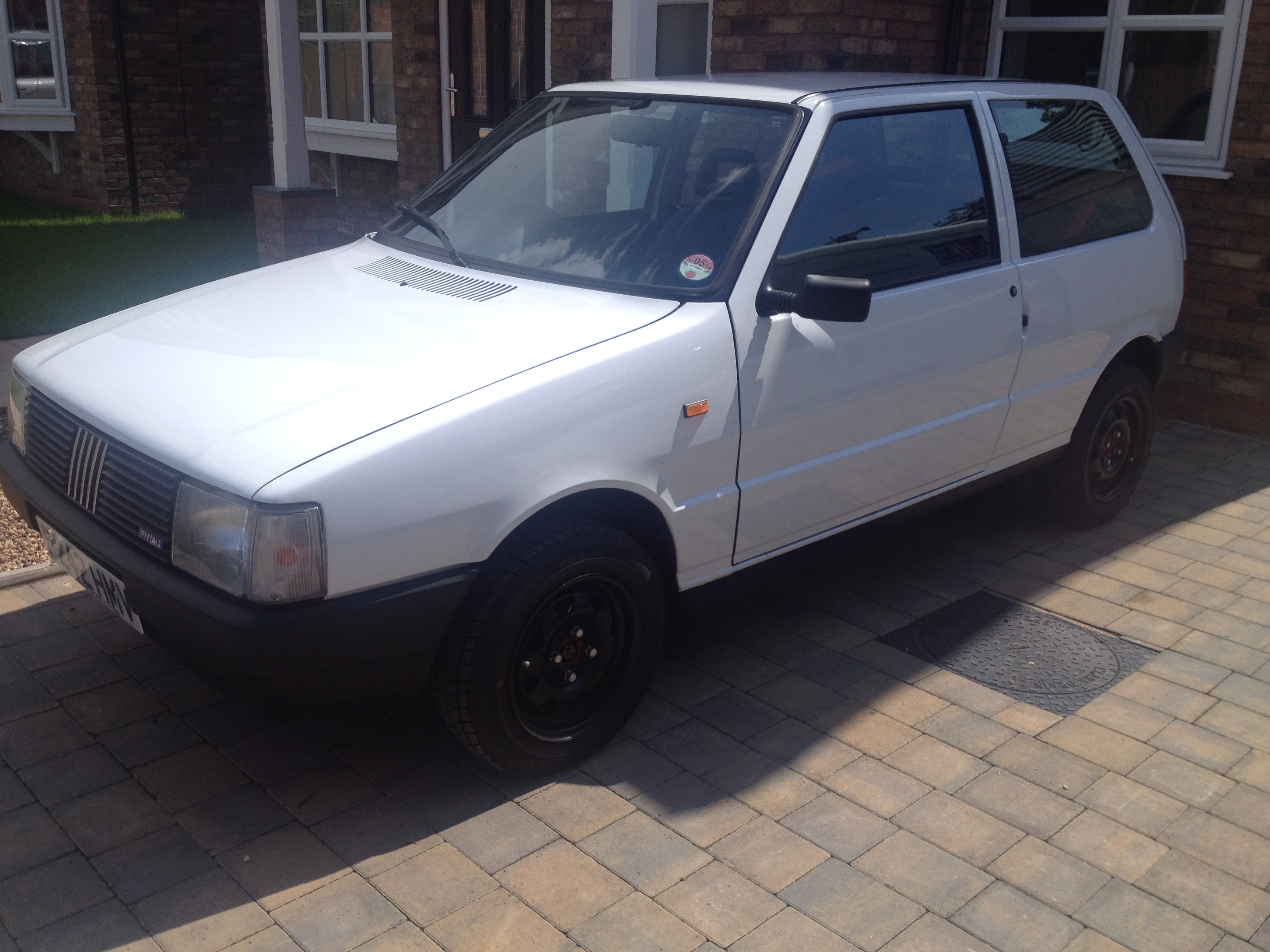

Yes hopefully she'll be road ready by the end of this week. Just waiting on a few bits to complete the job.
Then I'd like to start on discs, brakes, suspension, exhaust etc as they're old and rusty. Some minor exterior nicks and scratches need tending to as well still.
One issue I have only just noticed is that the heater doesn't work. Not sure why yet though, haven't investigated.
Overall very pleased I've managed to get this far. Thanks for the interest.

Small update
Car is now in daily use...done around 60 miles so far.
I am loving the crude and simplistic experience of driving an Uno once again :)
Lack of power steering, especially on the corners, was something to get used to again haha. Although it is a small and light enough car. Unlike when the power steering went on my Mazda 626 a few years back while on the motorway :(
Heater is now working and just in time as the weather is starting to turn.
