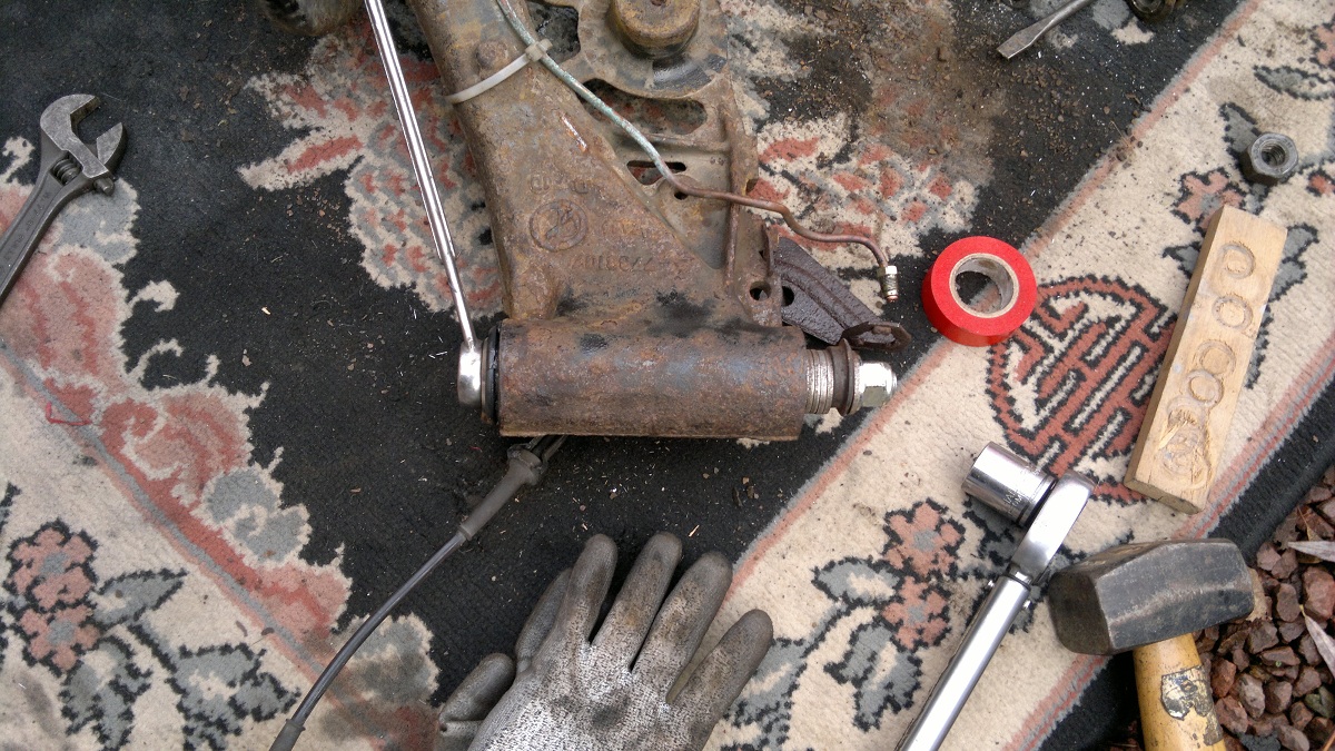

Just finished the rear arm bushes. I honestly wouldn't recommend anyone try this unless they have drifts, pullers and packing pieces to use to pull the new bearings in.... bit of a job, these :rolleyes:

Your missus is going to murder you for fitting those bushes on her best carpet...
I say, we have carpeted garages around here, you know :D
