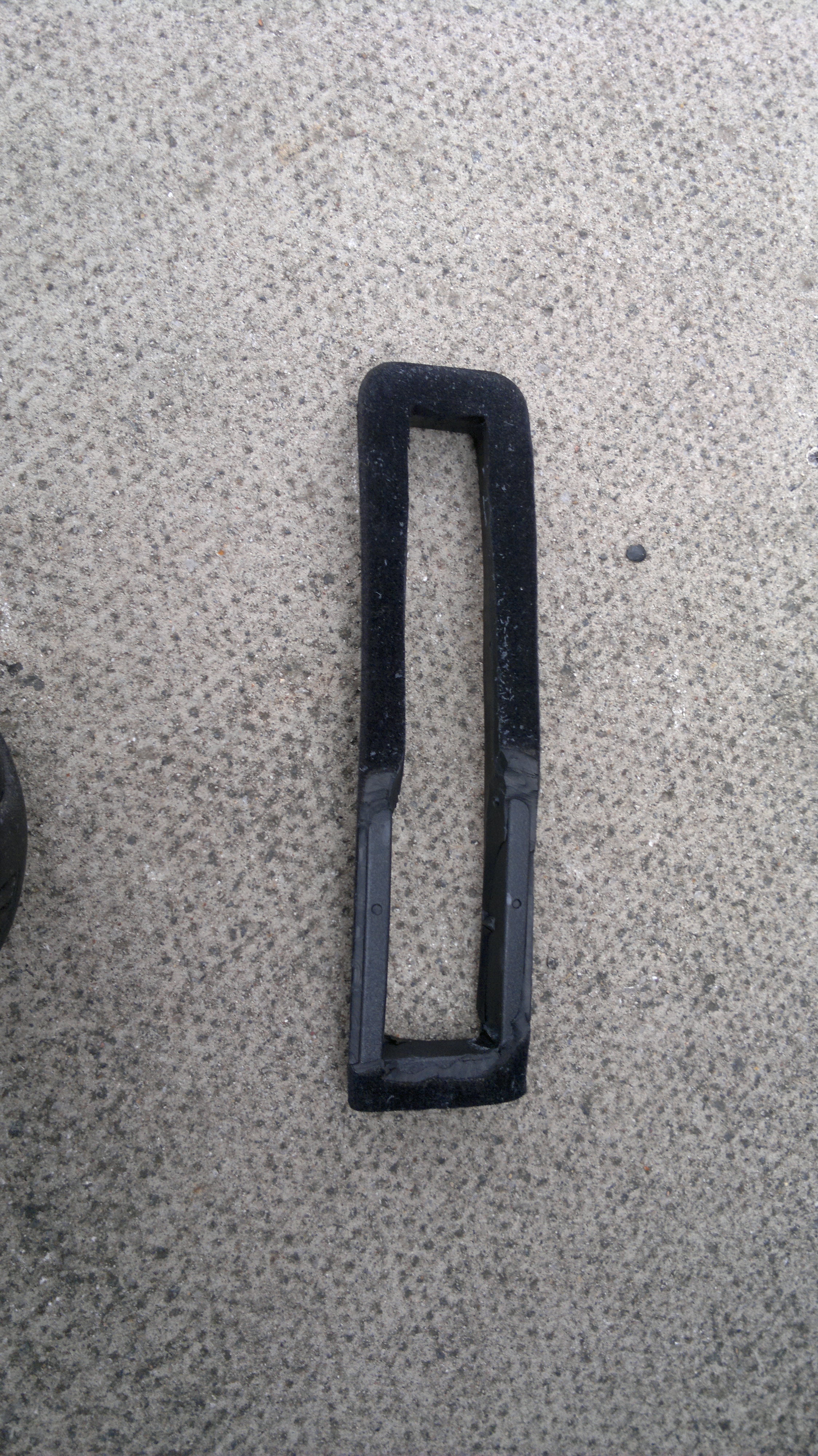

To get it to fit, I had to do a few mods. I attacked the felt covered surround with a stanley knife to make some clearance under the lever to allow the leather to bunch up and not jam:

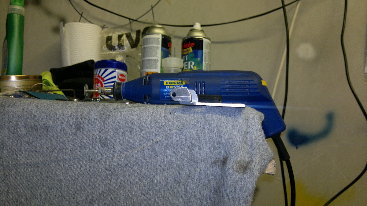

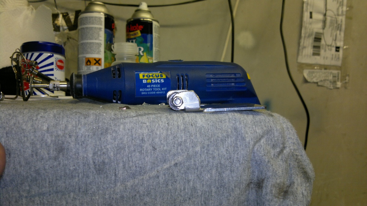

This still wasn't enough though. I had to hack a lump off the handle to create more clearance and tape some packing onto the metal part of the lever to allow the gaiter to sit flush and not under:

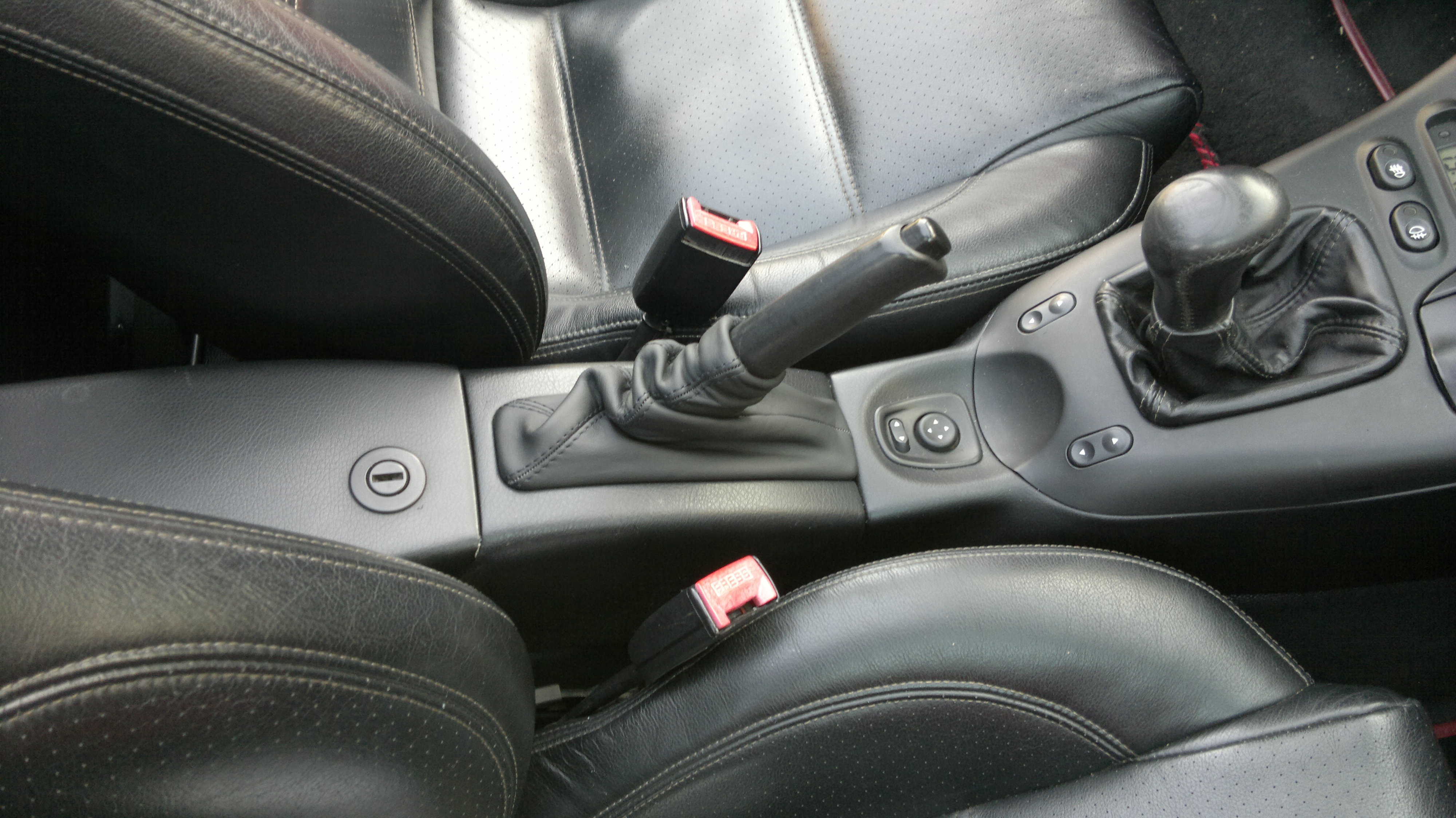

Then I could finally attach the gaiter, ty-rap it on and put in place. The surround had to be glued in place as there's enough pull and push on it to dislodge it as you pull and release it. I think it looks ok now :)
