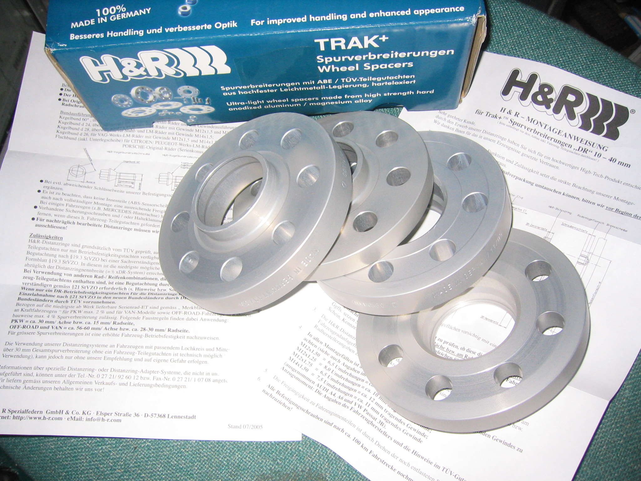

Anyone know whether spacers will get wide enough to correct the problem? think a pm to ritchie.guy is in order!
Can be done -- you could even use the spacers to convert from 4 or 5 stud to 6 and to sort the centre bore out (if there's an issue). The Alfa wheels on my tub needed bloody great spacers, too, but I was lucky in that the wheels were 4 stud.
They're perfect in every way but the ET! :bang: Can't believe it, even the front wheels are fine, Just the backs are rubbing! Any idea how much spacers are going to cost? i guess with the offset of the wheels being 49.5 i'm gonna need 15mm spacers and 15mm longer bolts!
Spacers are basically a plate that goes between the wheel and the hub and can be trurned or laser cut from metal plate. Wheel suppliers should be able to help or a local laser cutter.
To find the correct off set you can use washers or plywood to make a mock up but dont drive with them!!! Then get suitable thickness spacers made up. You will also need longer bolts by the appropriate amount.
Also check the fronts in case they foul when the steering is on full lock.
thanks for all your help guys :) can't believe hubcentrics are £85 thats almost as much as i paid for the wheels! I'm hoping 8mm spacers will help clear the wheel arches, otherwise they may be on ebay rather soon!

richie_guy doesn't do hubcentrics anymore (they were only 10mm as well). Could always ask him about them though, even if he doesn't sell them anymore he might point you in the right direction.

Thanks for all your help guys, I've spoken to richie.guy and he reckons i'll need hubcentric spacers, which he doesn't do anymore :( so if i get them from elsewere for all four wheels they're going to cost more than the wheels themselves, and double my budget! which is a shame cause they're in really good nick, i can feel ebay beckoning! :mad:
