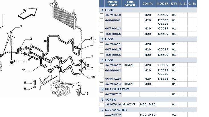

mmmm haven't had that problem on my 02 JTD, still got original pipework. Maybe something has been moved on yours or not secured properly hence the movement?
Never had a pipe fracture on my 2002 Jtd but the pipes that come from the condenser have just rubbed through again were they're clamped to the body with a poxy plastic clip just below the o/s headlight - second time in less than two years, think they might get left off this time!!!!! or wrapped in tape first
