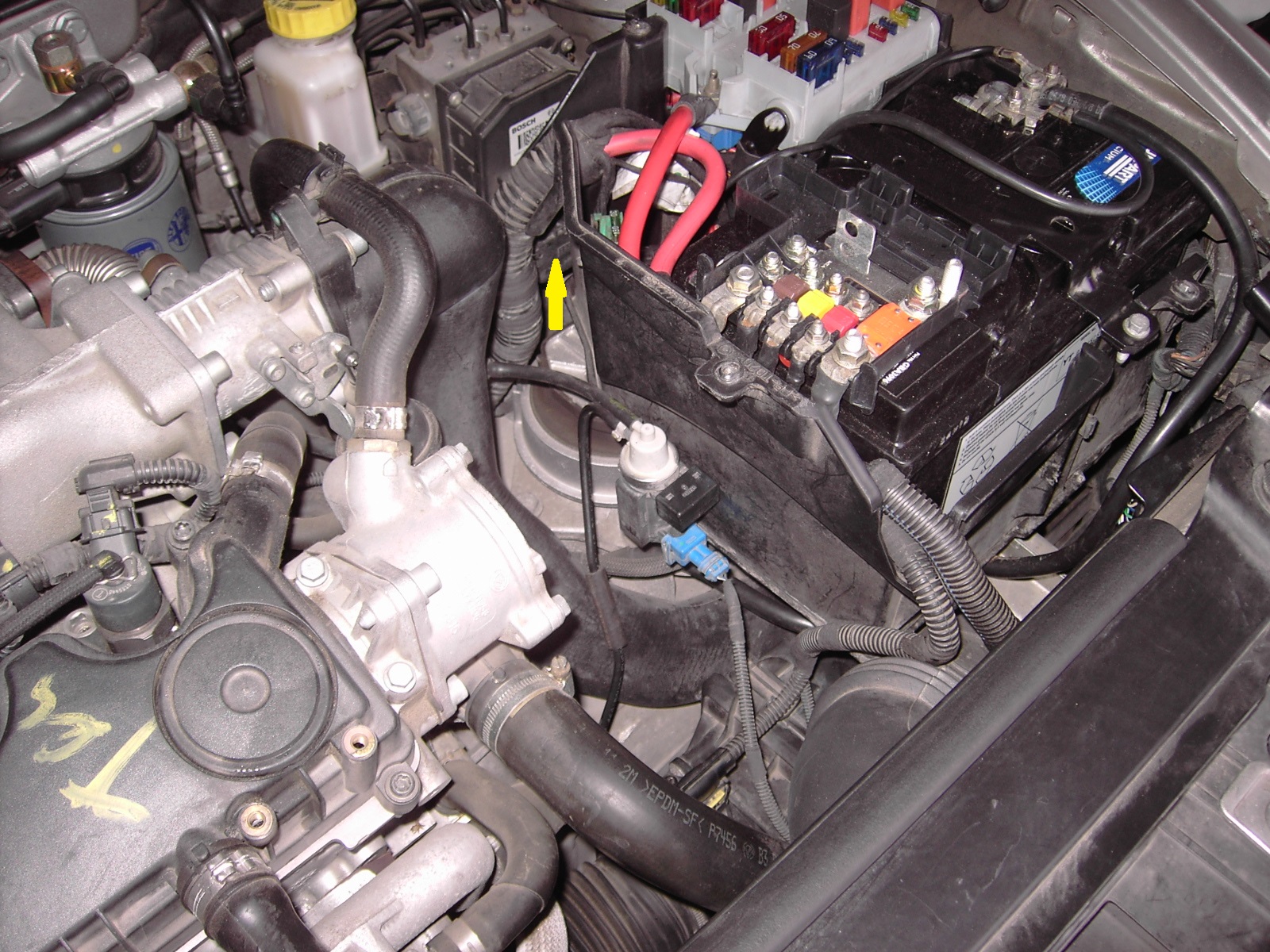

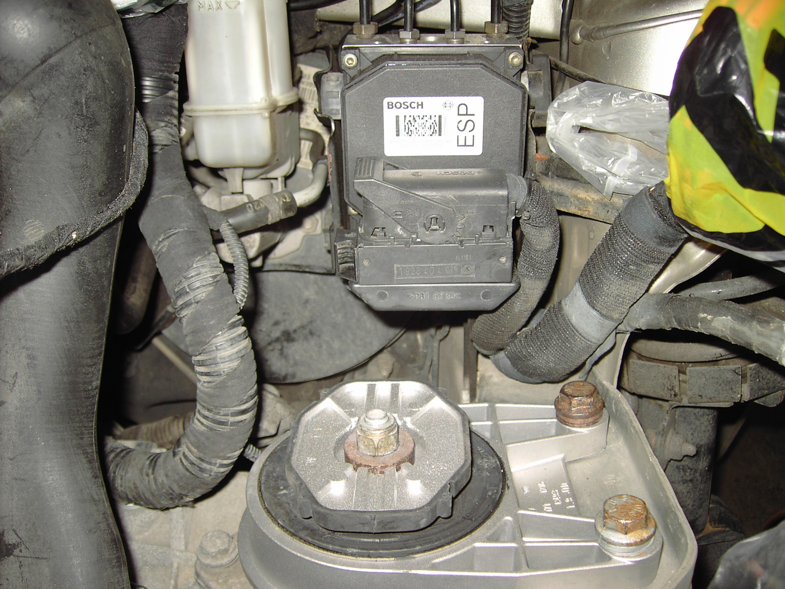

Where is the ABS ECU for me to clean those connections?
Cheers bud
The ABS ECU is below the ABS modulator located behind the battery tray.

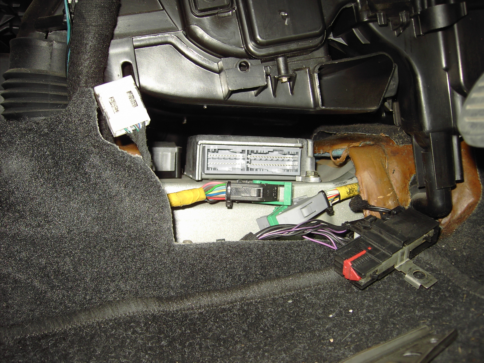

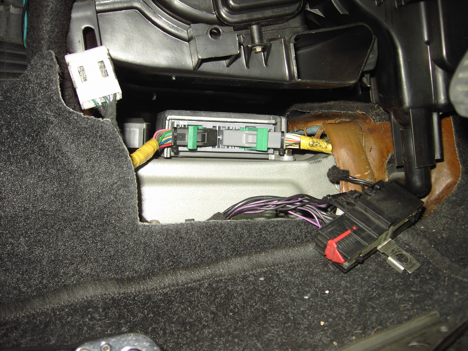

However, I suspect you mean the airbag ECU, which is located under the heater casing.

Oops yeh the airbag ecu! Thanks
I've had experience changing my heater blower a number of times....Guh.....so I will get upside-down and back to front and stick my head in the footwell for an hour to contact clean those ecu connections in the last two photos?
