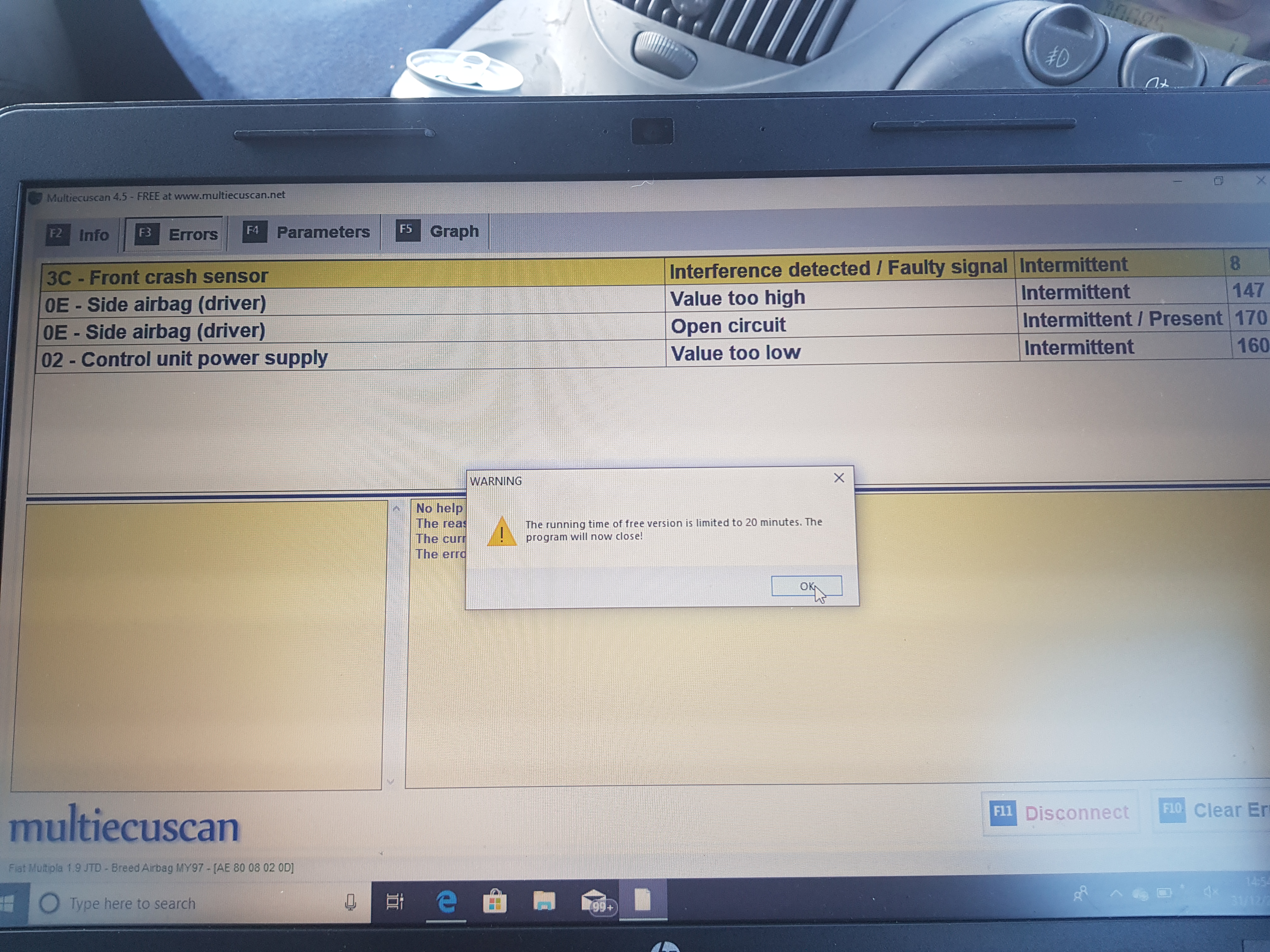

C carl2745 Member Joined Jul 21, 2013 Messages 127 Points 81 Dec 25, 2019 #1 My airbag light come on can you reset it with multiecuscan and how do you do it.

OP OP C carl2745 Member Joined Jul 21, 2013 Messages 127 Points 81 Dec 31, 2019 #3 Bought jumper leads this is the message with red one conected Attachments 20191231_143306.jpg 4.6 MB · Views: 56
OP OP C carl2745 Member Joined Jul 21, 2013 Messages 127 Points 81 Dec 31, 2019 #4 Got this aswell Attachments 20191231_145513.jpg 5.2 MB · Views: 49
V varesecrazy Patron member Parked in the garage Written 10+ guides Written a review Joined Apr 27, 2011 Messages 36,814 Points 8,383 Location Near the M4 Dec 31, 2019 #5 Hi. Did you search for devices..? to make sure you are trying to connect to the device in your multis build spec.

OP OP C carl2745 Member Joined Jul 21, 2013 Messages 127 Points 81 Jan 8, 2020 #6 Was connector under drivers seat light gone out know
