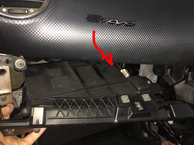

You're welcome. Here is a picture of just some of the parts you need to remove just to get the passenger side foot well cover off because it is screwed on underneath them. Then the glove box has to come out and then the glove box holder. On top of the glove box holder there is a large electrical module held in place by four screws. When you have unscrewed this module don't unplug it, use a couple of tie wraps to fasten it temporary under the dashboard. When you have changed the ones that need doing you will have to run the reset procedure.
Hy,
is it possible to remove the glove box without unplug the electrical module?
There are a tutorial on this forum about replacing the actuators and the writer said it is need to unplug this module. I'm confused... :confused: :)
There are a picture attached from the tutorial. (Is it the same connector as you mentioned?)

Hi, I'm the one who took this photo. That connector is the power for the small lamp in the box. Unpluging shouldn't cause any prob. Take it out so u can have better access to the actuators.
Thanks for the fast answer :)
