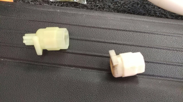

Just replaced the 2 broken pieces awhile ago.
Quite a pain to do this job. Need patience especially the bottom actuator. 3 to 5 hr job.

The top 2 actuator you easily remove with T25 but tricky for the one at the bottom.
Top 2
Bottom
Use 5.5 mm socket to remove top 2 screw.
Bottom screw
For the bottom actuator, turn on it engine to let it rotate. Off engine once it rotate somewhere in the middle position. Bottom flap on has a small room to rotate.
Good luck.

For that I'm not sure. Just figure out on how to remove along the way. That's my 2nd attempt just today. Replaced only the top actuator but didn't had the right tool to remove the bottom one for my first attempt. Saw your post so I document mine today.
After fixing up the actuators, do climate control reset before putting back the panels. Mine got error after putting back panels. Right side still blows a slightly warmer air. One of the motor could be faulty. Need to open up again...
