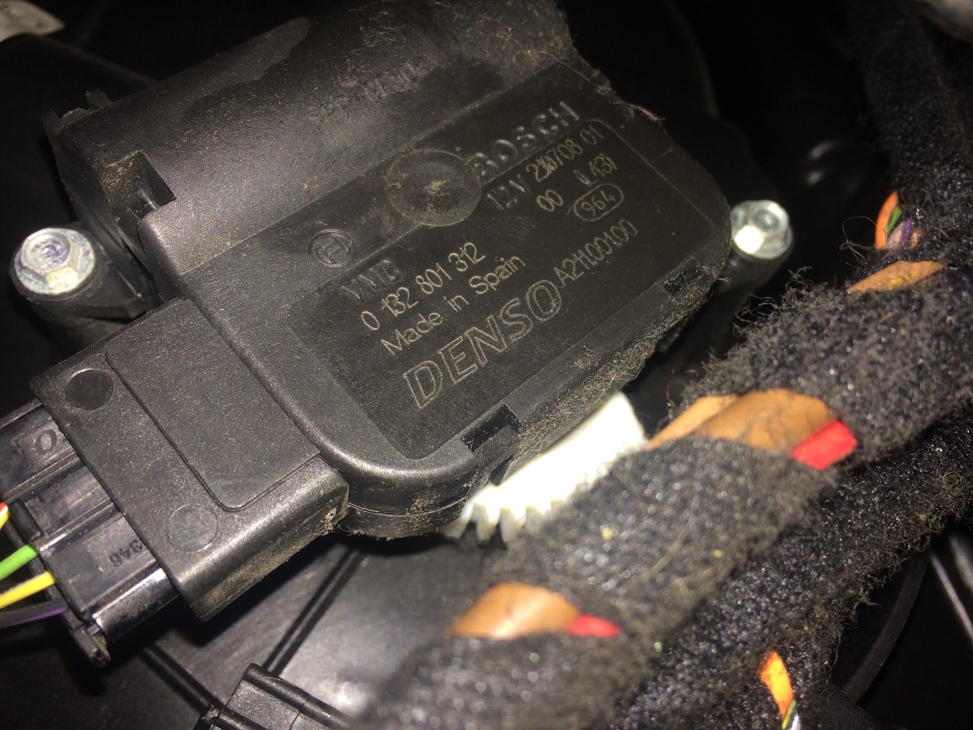

We discovered the fault seems to be with the motor pack pictured. its up next to the clutch pedal , you can just see it with the kick plate in place.
We are trying to source one. i'll update this thread when we do.

Have a search for similar threads. It may not be the motor that you pictured. Behind that is a gear drive, which can also be replaced separately, but there have been reported problems of the lever on the end of the air distribution flap breaking off. To repair that requires the unit to come out, meaning dash out, so a big job. There is a thread showing how.
With your head up under the dash, operate the temp control and watch whether anything moves. That will help diagnose motor, gear, or flap.

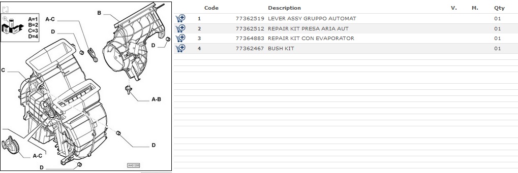

The motor for the distribution flap looks like 77365916. (Was 46723328)

I've got to the bottom of it.
As Portland-Bill says its the drive lug broken off the flap so its a heater box out job to fix it!
I've found that its kind of controllable by using the fan on full speed to flip the flap up to hot, as long as we keep the fan speed over about 1/3 it stays on hot.
to get cold air not running the fan at more than half means the flap stays on cold.
