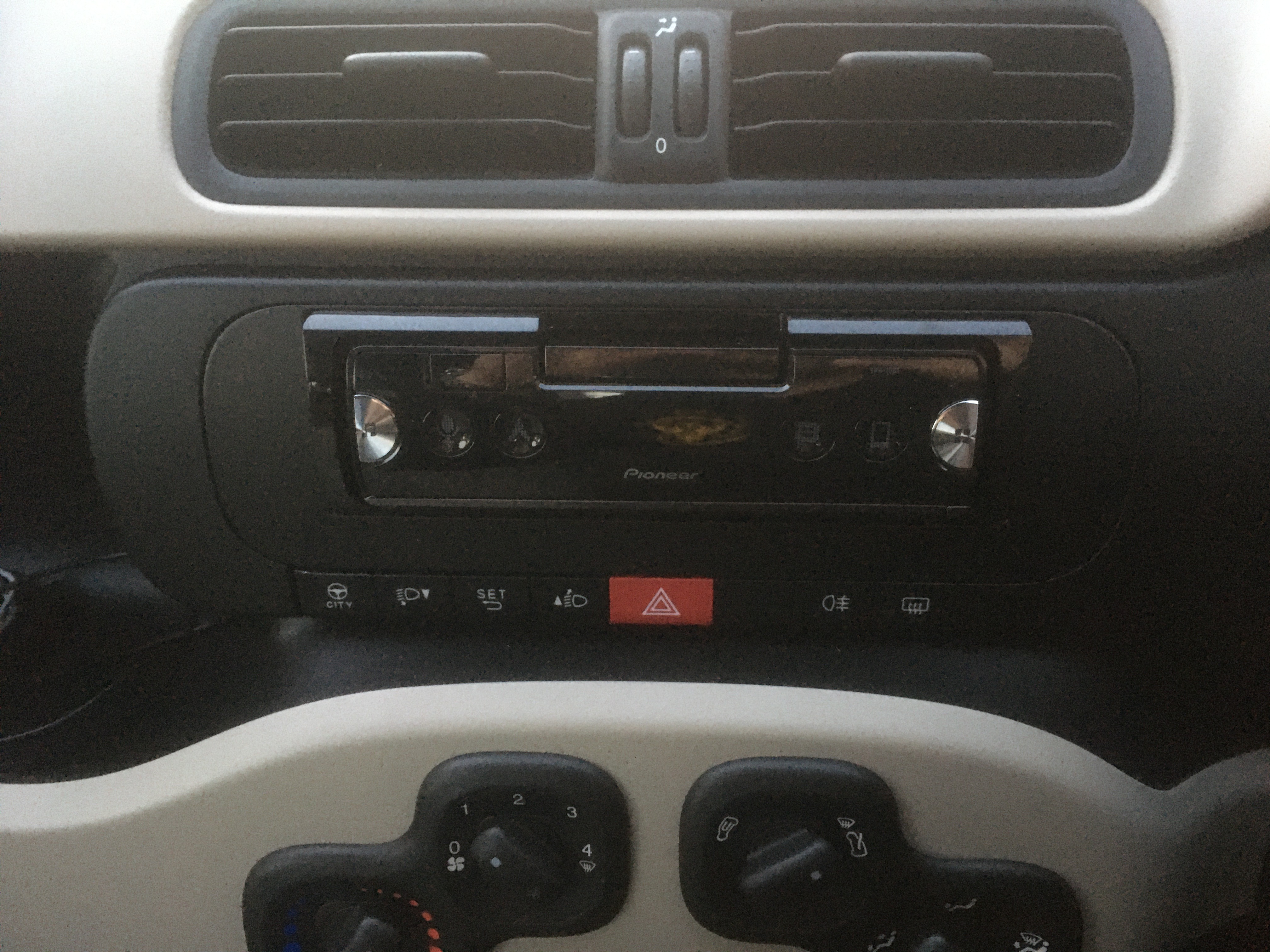

managed to grab a quick pic.
one thing I have noticed is that the headlight dimming still works with the new stereo, so the canbus side of things is obviously working. what that would mean for steering wheel controls im not sure, but thinking back, im sure I saw a listing for one of the looms that I bought, but with steering wheel interface... I could be mistaken though, as I wasn't deliberately looking for it.

this is with the headlights off.
one thing I like about this head unit, apart from the fact that it has a built in phone cradle, is that you can configure the colour and brightness of the head unit via an app on your phone, so I was able to get really close to the original orange of the rest of the dash :cool:
