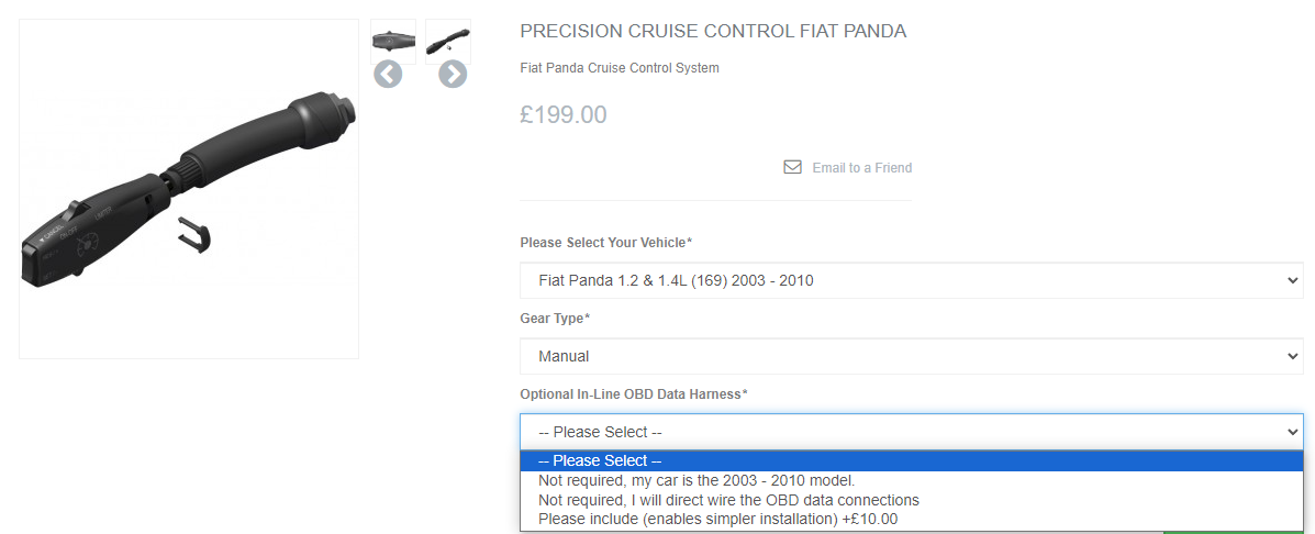

As the title says, I'm looking into getting cruise control fitted in my 2009 manual 1.2 Panda and a bit confused with the options on the product page, what is OBD data harness and do I need it since the 1st option says that it is not required since it lists 2003 to 2010 models?

You still need to splice into the power
But saves having to solder to the back of the OBDII
It's not obvious from the advert, but I assume it will only work on pandas with flyby wire throttle bodies
Yes it a 500, but very close
