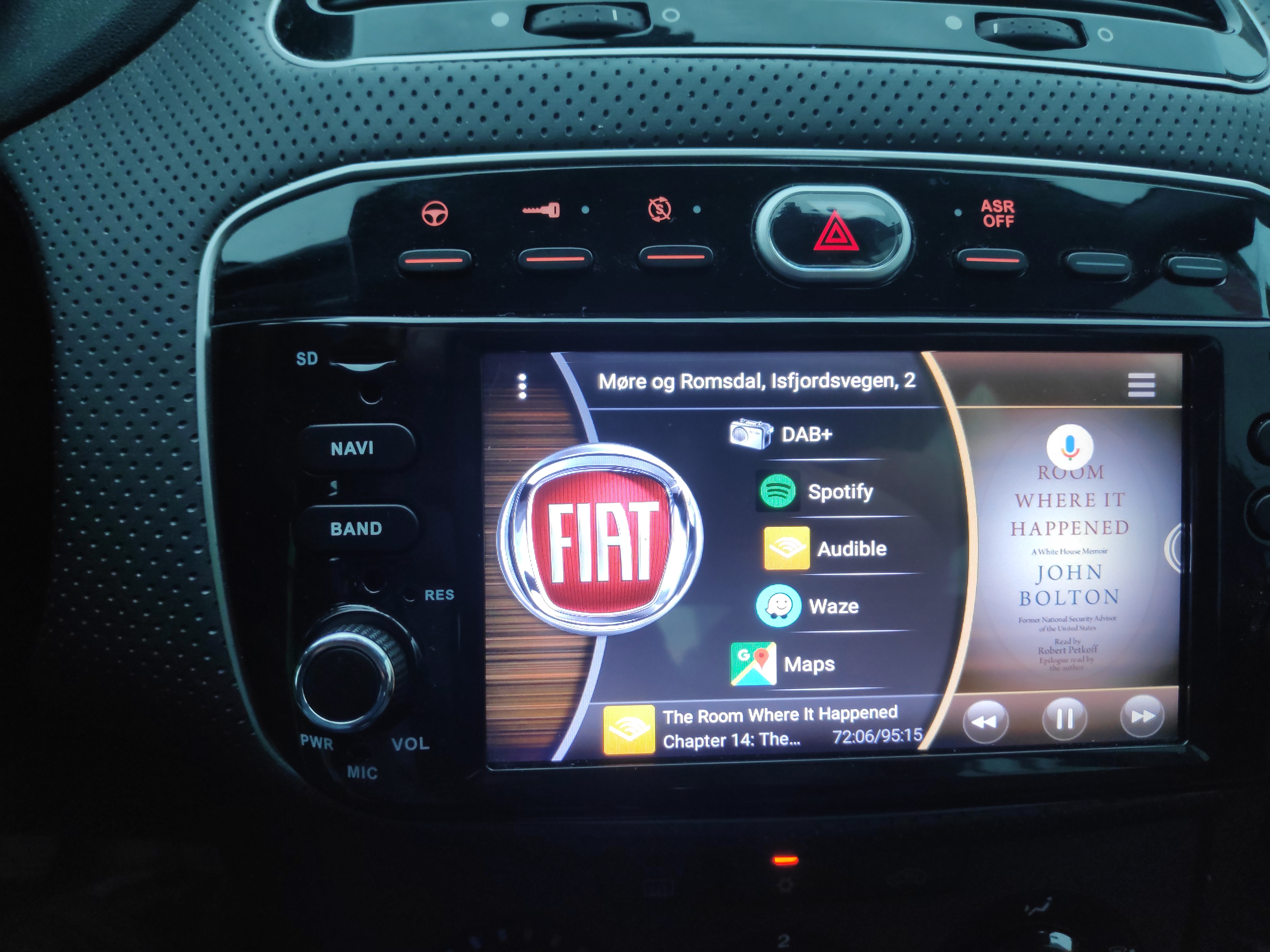

Is blue and me working as usual? Can you rereoute the blue and me aux and usb to the headunit to use as a normal usb and aux? What’s the sound quality like? And did you have to pay any import tax for ordering? Sorry for all the questions, I want to get one too :) if you want CarPlay you should look into a carlinkit adapter since that’s what I’m doing
Sorry about the long reply.
I'm not sure about Blue&Me, but I'm not planning on using it. Hands free will be through the new unit.
Sound quality is good, I think, and you can use AUX/USB (and bluetooth) through the new unit.
No taxes (to Norway), which I think is because the sender put a redicilously low value on the parcel. Very quick shipping from China as well, well under two week iirc.
Installed with the pro version of car launcher. It came out pretty good, I think.

Hi, that seems a nice replacement.
I want to also change mine with something similar from aliexpress. I am thinking one of these 2:
https://www.aliexpress.com/item/4000306433215.html?spm=2114.12057483.0.0.58fa7d04211otB
https://www.aliexpress.com/item/329...earchweb0_0,searchweb201602_,searchweb201603_
I would like to receive your advise based on experience. Is it worth? Does it include adaptors for the steering wheel control or its just plug n play like the original one? Did you remove the previous unit along with the B&M console under the dashboard (if not, do you have any connection interference yet)? What about the microphone? is the new units' one good enough or did you have to make any modification to that as well?
