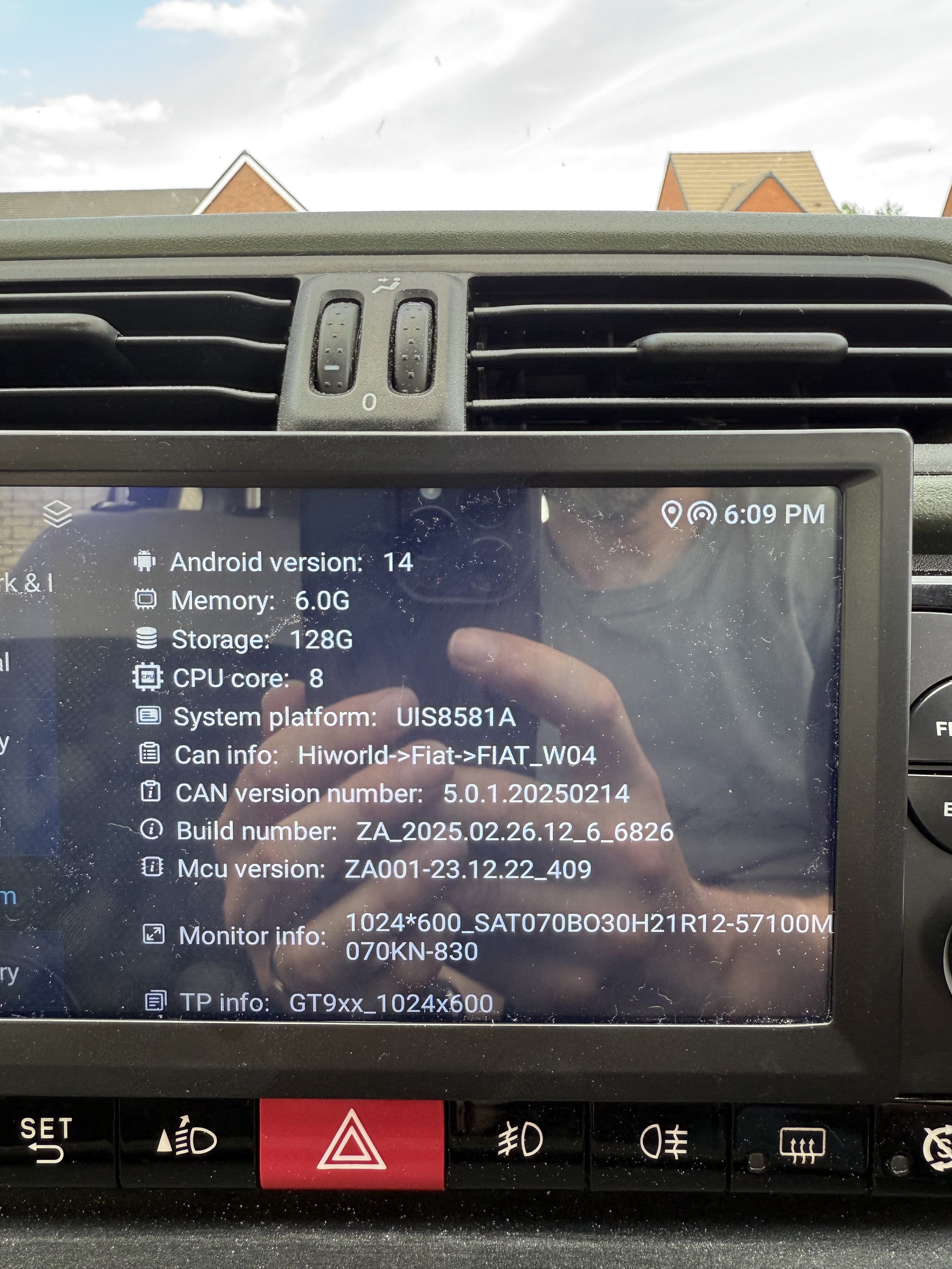

Hi. I got an AliExpress unbranded special HU for the Panda
It sounds good, the interface is slick and I’m generally very happy apart from two issues:
1. Steering wheel controls don’t work. (The can adapter seems to be working, because the h it picks up when I’m in reverse fine.) the controls have two modes in car settings. ‘Special mode’ does nothing. Learning mode should let you learn the buttons but also does nothing when you press one.
2. The button illumination cycles through the rainbow and I cans find a place to set it to match the dash. It isn’t in car settings to change it. Is there an app I could download from the play store?
Does anyone have any experience of either issue and how to resolve it?
