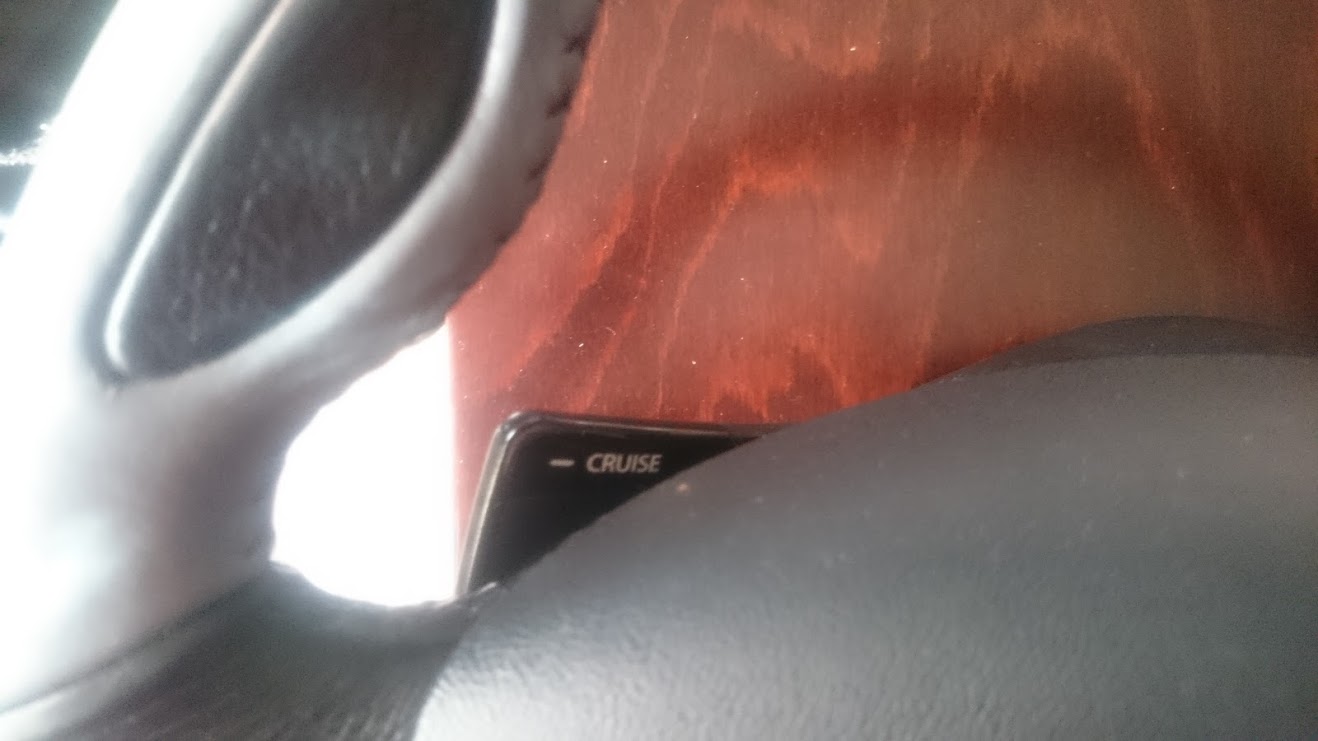

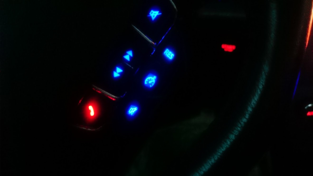

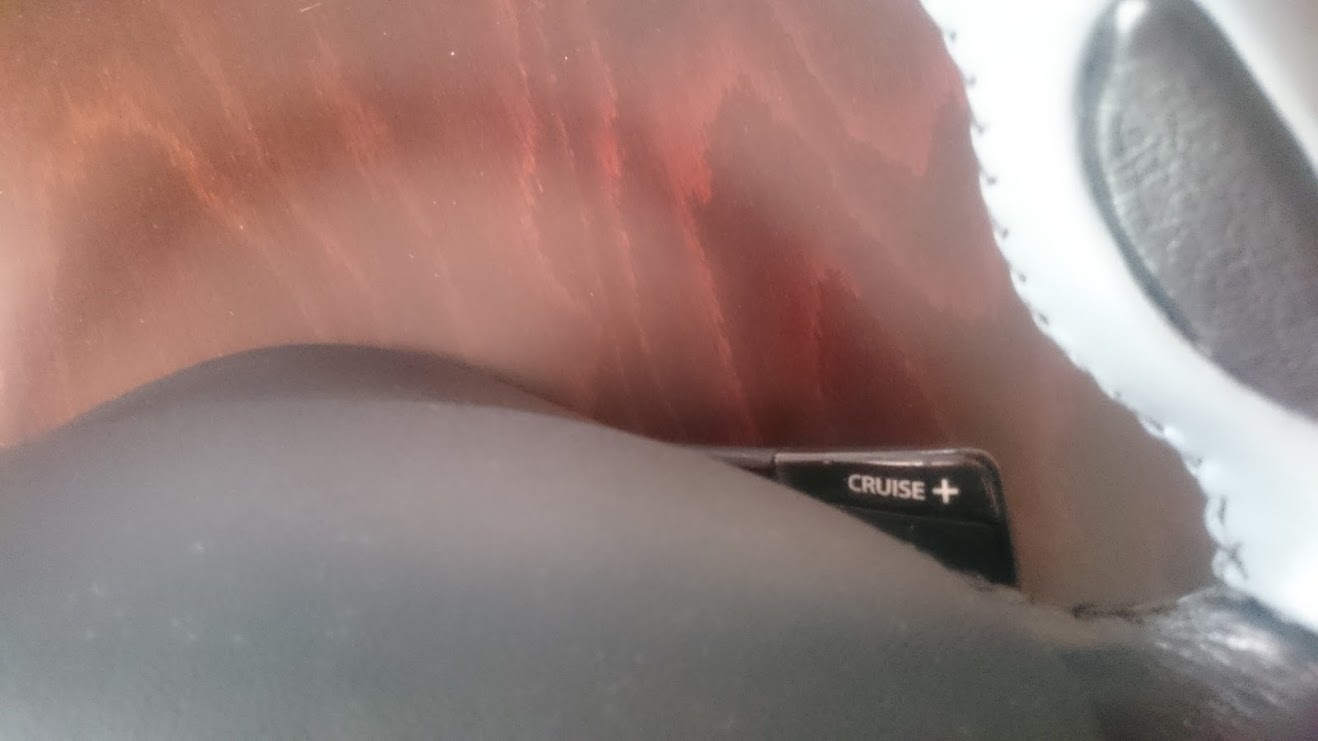

I had to cancel the cruise control lever.
cruise control with steering wheel now ...
so much more ergonomic
