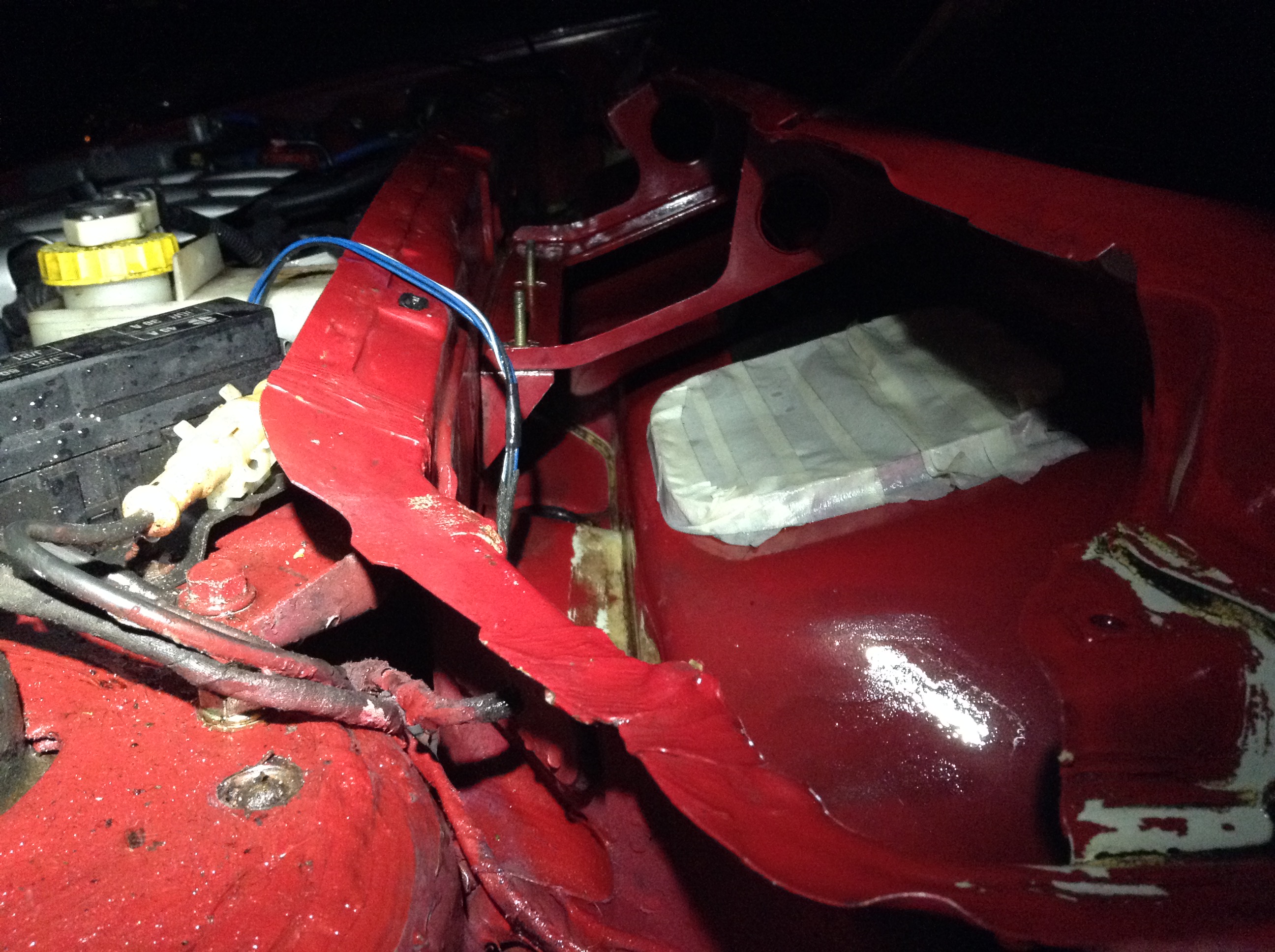

I've had some major clear outs in that area before- in Scotland; you don't want the leaves and damp collecting in that spot. I taped up the intake aperture whilst washing it all out.
The 146 & Tipo are identical in this respect...
